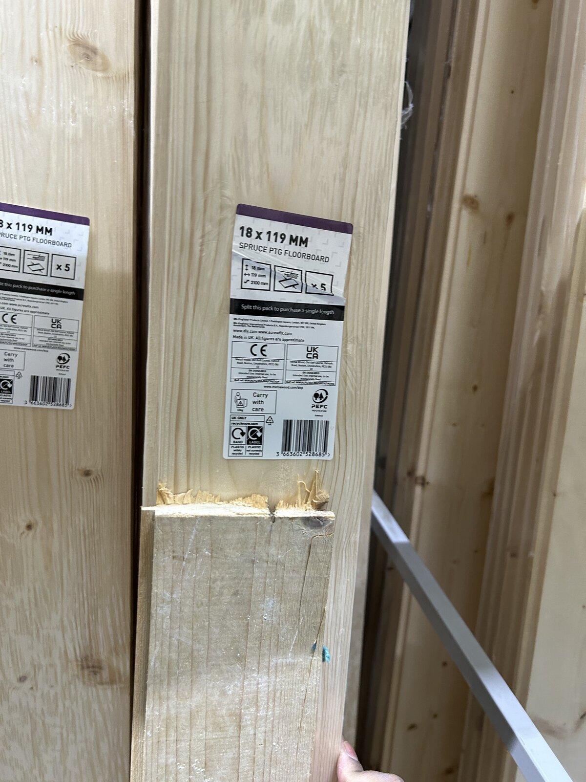

Can anyone recommend a t&g floorboard supplier that it reasonably costed.
I can only fine floorboards in size 18 x 119 and mine seem to be smaller in width.
Failing this, can someone recommend a suitable replacement for rhe floor.
Vin
they will include the tongue if metric so coverage will be around 6.5mm smaller so perhaps 113mm
the same floor board if quoted in inches as in ex 5"[127mm]
in other words the pre worked size is 5" then planed and or worked gives you 120mm including tongue and groove
but the coverage [shoulder to shoulder] with the tongue in the groove will give you say 113
The original seems a lot smaller
