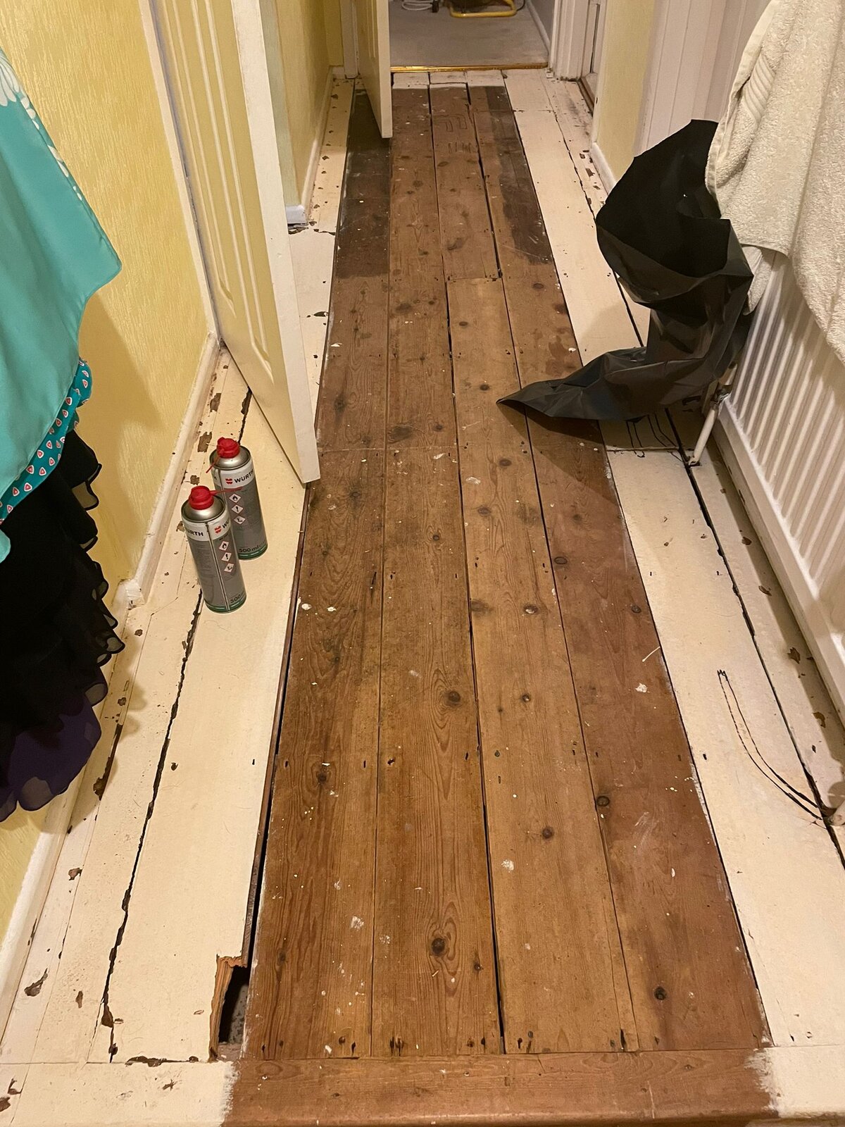

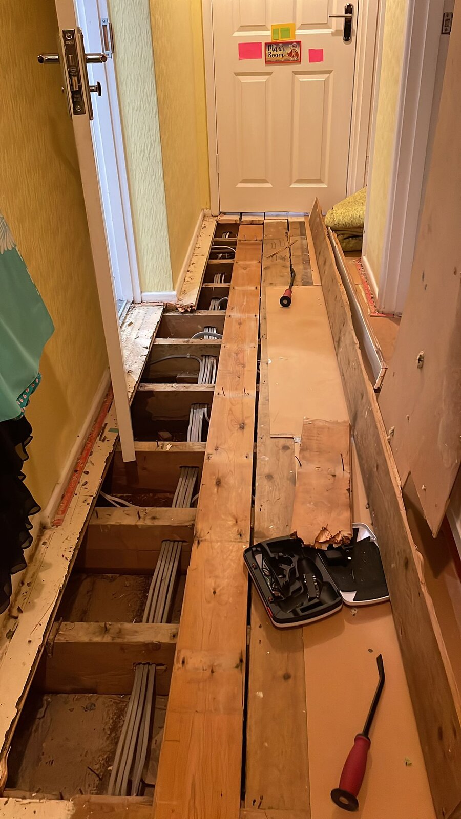

House built mid 1950s. We had a leak under the shower with water running into the ceiling (https://www.diynot.com/diy/threads/shower-leak-and-floor-damage.640390/#post-5894893) and I had to rip the landing carpet up and lift some floorboards - we weren't sure whether it was a leaking pipe, thankfully not.

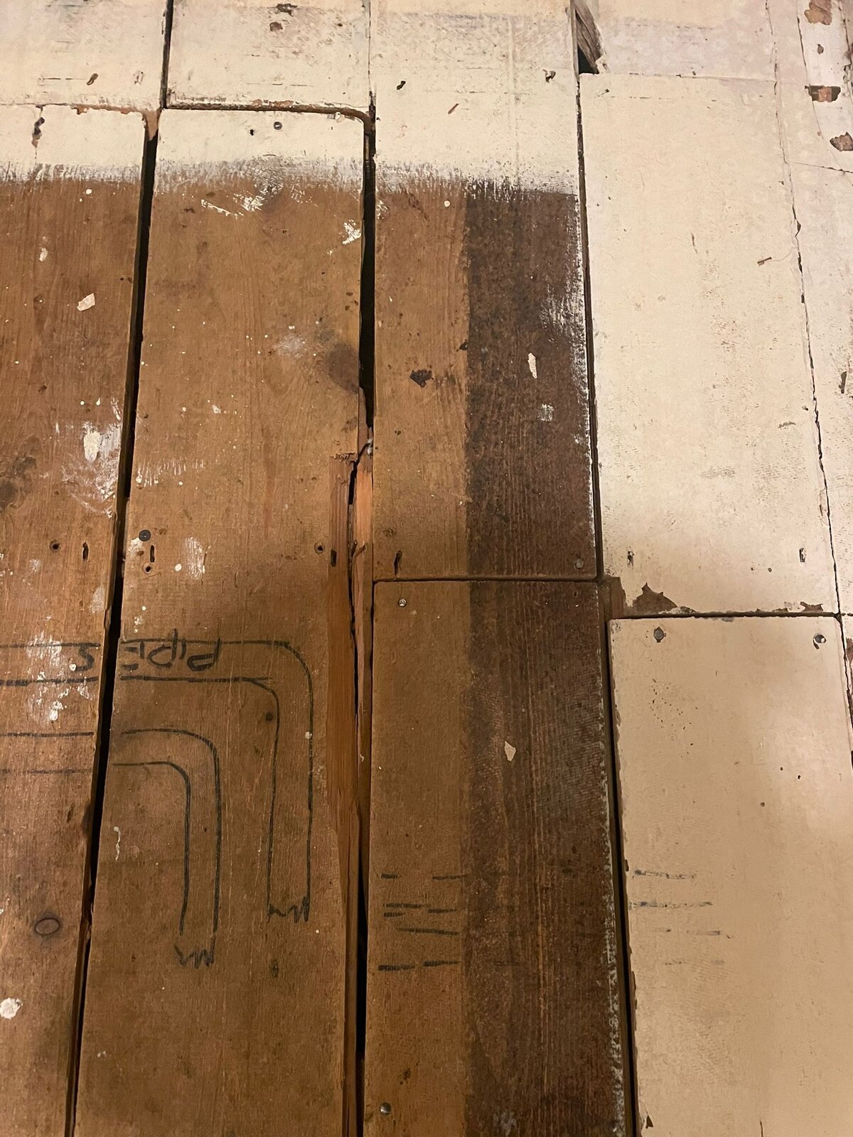

The floorboards have seen better days and I'm tempted to replace them as I've already got the carpet up. That way I know it's done and won't need to be touched again while we're in the house.
Most floor boards seem to be 18mm these days, mine are just over 20. Am I right in thinking that these (https://www.travisperkins.co.uk/pla...ing-5th-finished-size-20-5mm-x-144mm/p/181003) - finished size 20.5 mm would be the right replacements?

What you have done here was not a good idea.
For now, lift all the proud nails, and then lay the boards loosely back in their original places - dont fix ie nail or screw, anything.
I wouldn't replace those floorboards if they were mine - they look fine, and you could quite easily end up with something of poorer quality than you have.
I certainly wouldn't want modern t&g running over pipes and cables.
(Most of the floorboards in my home are decades or even hundreds of years old, and won't need touching in my lifetime.)
When it comes to wood, new is not necessarily better.

I'd be wary of this advice - you've been clear that you needed to lift the boards to look for a leak, and this is a completely different question so it's clearer putting it in a separate thread as you've done.
If you don't need access under there for the repair, and it's dry - go ahead and fix them down again.

I have a leak in the bathroom and will need to pull the bathroom flooring to remedy. That’s a separate issue though.
The water actually made its way into and under the landing which is why I had to pull the floorboards in the landing - damaged one in the process too - and hence the reason for this post, I was debating whether it was worth replacing all of the landing boards or just the one that I broke. I also noticed big gaps, clearly they’d been up before and the T&G had been broken in the process.
Reading the comments above I might not replace all of them, noting the comment about quality as well.
Either case, as ree suggested, the landing will only be fixed after the bathroom has been stripped and redone.

Don't replace floorboards willy-nilly. I've lifted and and re-affixed many, many boards in my time. The only time I would replace is if damaged beyond repair with wood-worm. Just a few holes is fine; treat including beyond the holed area and the nearby-joists etc and replace. Even rot can much of the time be stabilised with a treatment liquid applied. Leave to dry out and then push a screw-driver in or scrape across the 'rotted' area. Don't go too wild. If pretty stable then it is fine. if it crumbles away then scrape away until it is pretty stable and then treat.
Always screw down when re-affixing (pilot screw first to avoid splitting). Obvs be aware where pipes and cables are BEFORE affixing anything.
IF you end up needing to replace one small section of board then try and cut it out with the join at the centre of a joist. If not possible then add supports to side of joist and affix to that.
As for thickness, yes new boards / chipboard etc are thinner. I would pack out beneath at each joist, with a slither of 1, 2, 3mm etc taken from the removed board.
