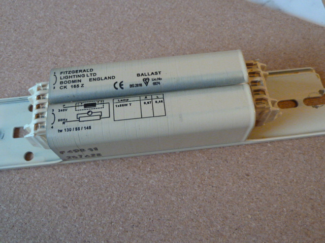

Few days ago, I switched off the kitchen light at end of the evening, it went out with a bang, and the RCD in the consumer unit had cut-out as well - not a split-load unit. Switched RCD back on, all OK, except kitchen light not working - the tube is good, checked in another fitting. Would this have been the lamp ballast failing? I have not known this before. I have now replaced the unit with a LED bar, far better I reckon.
Did it have a starter, if so when you took the fitting down you would have seen the blown up choke.
Starterless fittings have an electronic ballast, when these go they can take out the Rcd, the damage to the ballast is not usually visible unless you unscrew it, then you often see a black soot mark around the cut out in the casing on the back where its blown inside, thats where the ballasts earth connection touches the fittings casing whilst its screwed in.
Not all of them. Starterless fitting were around a long time before electronic ballasts.
True, they were the "original Ballast" if its one of them he has certainly had his moneys worth out of the light.

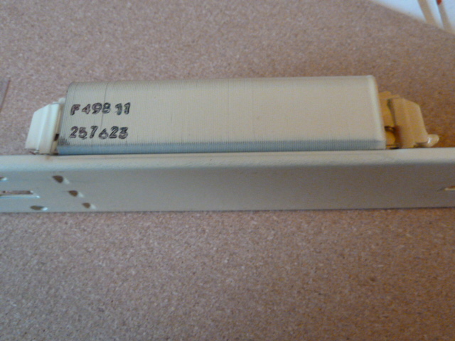

Thank-you all for your replies. I attach photos of the ballast, there appears to be no soot marks evident, which I was expecting. Ballast 1.JPG Ballast 2.JPG

Thats known as a Magnetic Choke rather than a ballast, always combined with a starter ,wheres the connecter block gone of it, they do occasionally fail open circuit, without any visible damage as the thing is pretty sealed apart from the connection end.
Though often you can smell the damage.
Normally these can be checked at the 2 choke connections where there should be a voltage from both In and Out terminals measured to neutral.
Semi Resonant Start (SRS, sometimes called 'starterless') was invented by Thorn around the 1960's I believe and involved using a capacitor to raise the open circuit voltage & additional windings to heat the cathodes at power up to strike the tube, quite an interesting technology for nerdy types like me lol.

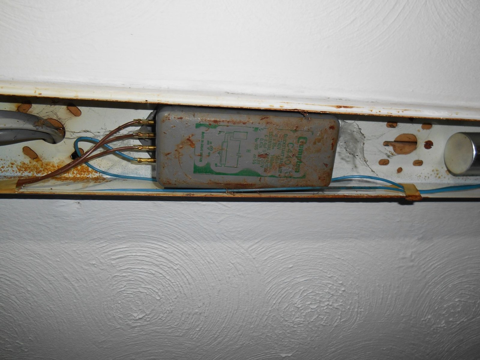

This is the one that's in my kitchen, replacing it is still on my to do list, haven't decided what will go in it's place yet?!
The old tube went last year, the light only really gets used in the winter months
It does work with a t8 tube but not well, usually takes a few flicks of the switch
