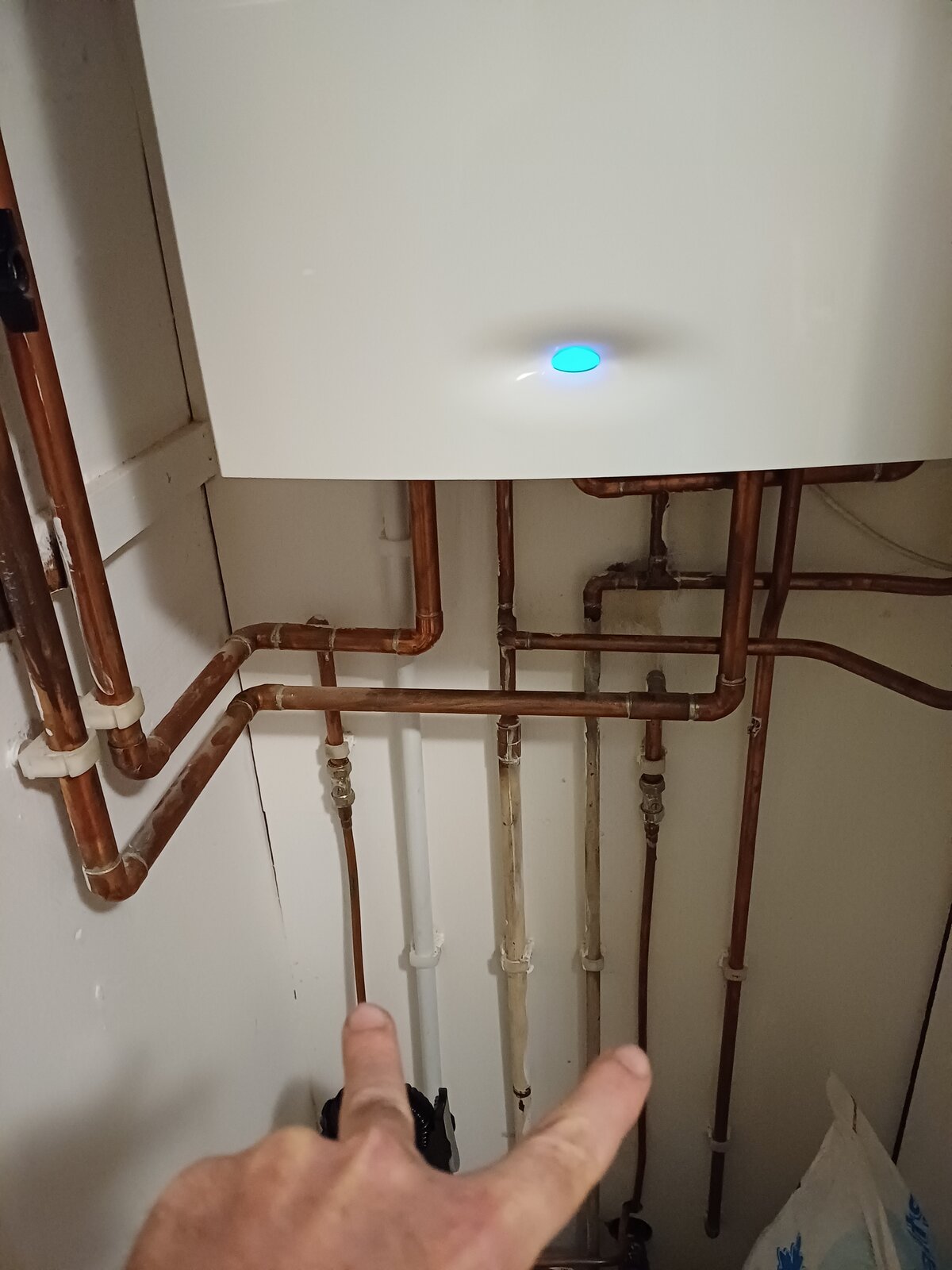

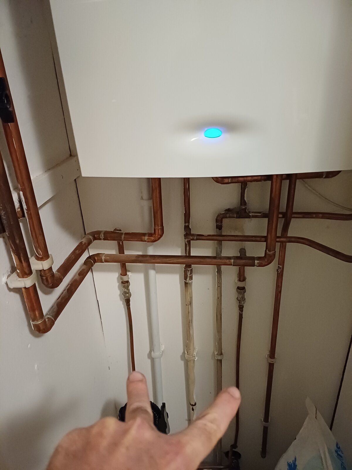

So I cleaned the filter out and gave it a good few flushes so ended up with half a bucket full. Quite a lot of black sediment in the water since it has never been emptied in the 2.5 years I've lived here, and possibly not before that.
Refilled the system up to the usual 1.25 bar.

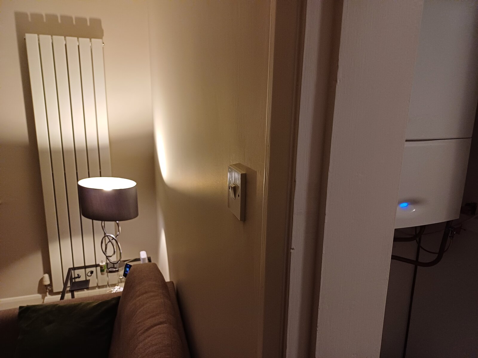

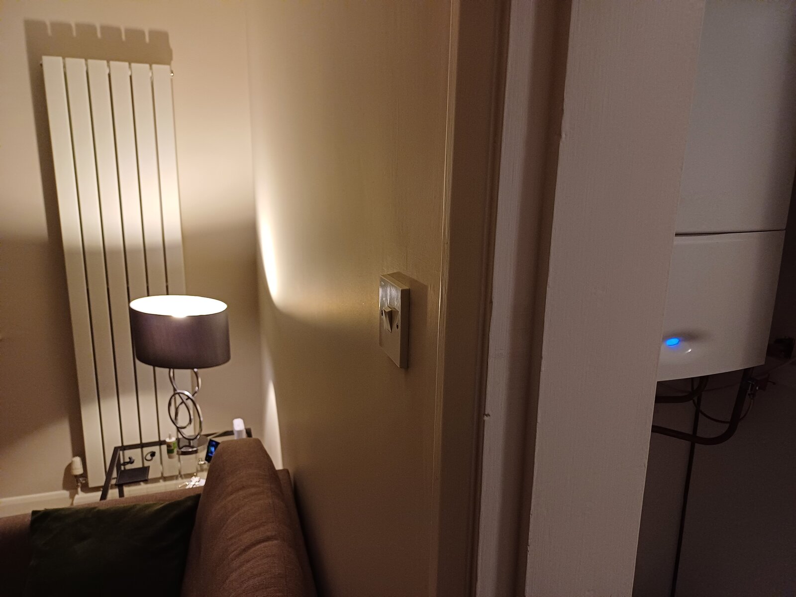

Did the air purge again, which sent a noise to a particular tall radiator which is close to the boiler and has its own circuit off the main pipes.
Decided to go around and bleed radiators and the filter. The filter let a little bit out. None of the radiators needed bleeding apart from one. The tall one near the boiler. It had so much air in it that I was there for about five mins bleeding it and the boiler pressure was at zero once I finished. Repressurised the system and then let out what air was left in that radiator.
Could that radiator have been receiving all the air when I've done these air purges? Or did it end up with a load of air in it earlier when I cleaned out the filter? Or, has it been full of air for a long time and I didn't realise? I am in the habit when I bleed radiators of immediately stopping once I see some water. But that tall one let some water out earlier and then loads of air, so perhaps I've mistakenly not bled it in the past thinking it wasn't needed...
Seems weird how that radiator ends up with all the air. Any ideas why? See photos. The two skinny pipes lead to that one radiator.
Boiler is running now so let's see if it stays at 53C once it gets there...

Tall rads notorious for catching a lot of air. I saw in your earlier photos that you had 2 x 15mm branches off the flow and return to the boiler and knew they were to feed an added radiator. The 2 x 15mm ballofix isolator valves on the pipes should not be used on heating circuits - they are too restrictive and also leak for fun.
Tip for bleeding tall rad is to turn them off before you do it, using both valves but one would do. If you close both, remember the number of turns on the LS.
It sure sounds like air was/is your issue, with pockets of it getting into the hex. Any money that the AAV in the boiler has been screwed down to off position.

Funnily enough, that tall radiator is now performing better than ever! I knew there was something not right.

AAVs should be called AWVs, automatic water vent(s), they generally either get blocked up or continually keep dribbling water, hence shut off, very often.
