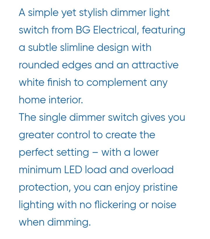

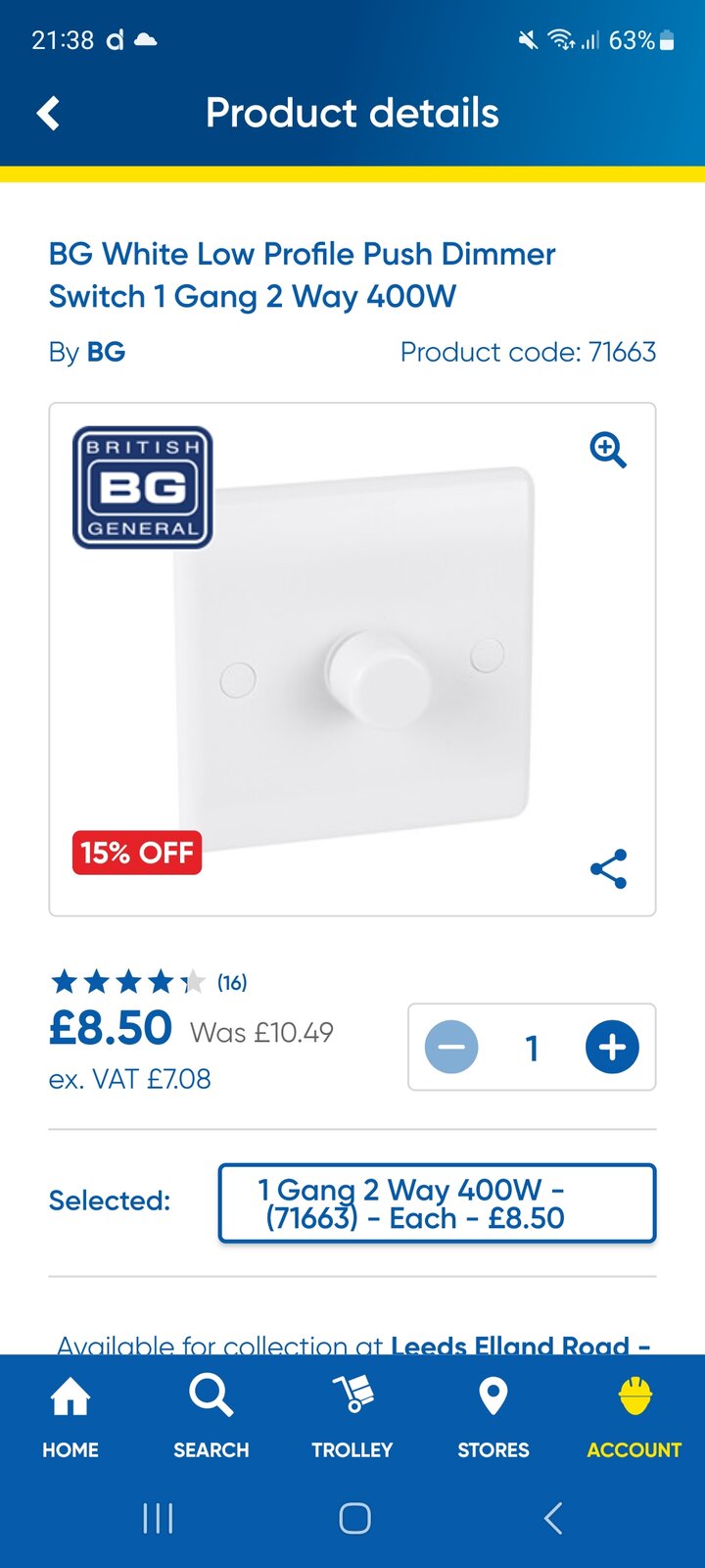

I've attached a picture of the toolstation one it does seem to be when we dim it,
The spec on that is 5-100W
I would guess your 14W (Max brightness) is getting to the dimmers limits when you turn it down.
The one I linked usually sorts this type of problem.
It operates from 0W to 300W

That one isn’t suitable for LEDs
Yes, the problem seems to be with Toolstation and their description...
The product is the 881P-01, rated for 60-400W...

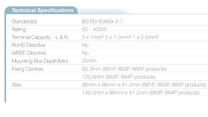

The one you found has the product number 881-01.
It may well work for the OP, and is probably what Toolstation has mixed up their description with.

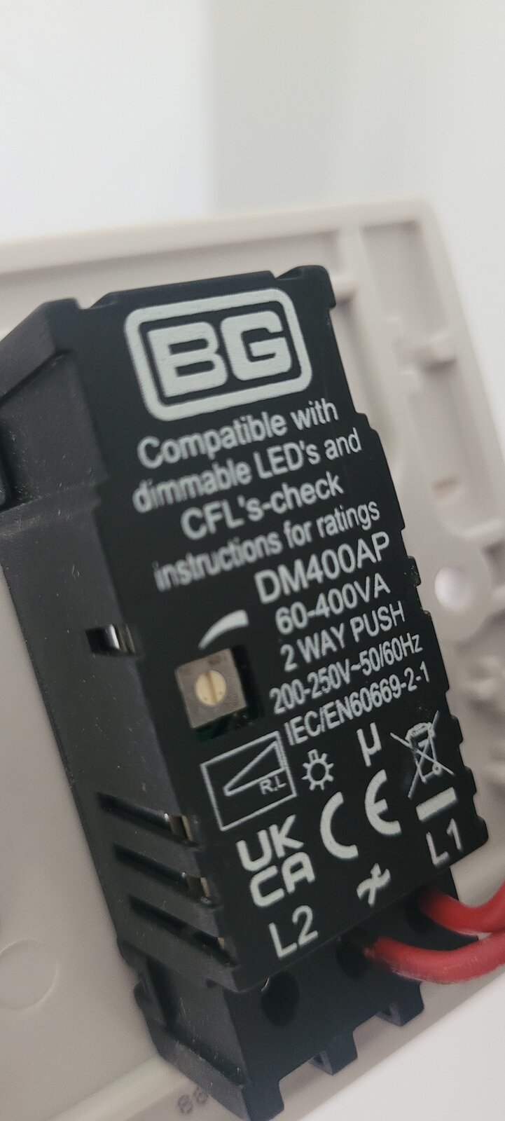

The actual ratings/minimum loads should be indicated in the rear of the dimmer.

I've attached a pic of the rear
60-400VA - 60 Watts is the minimum load.
If you're sticking with Toolstation, you could try the 881-01 (if minimum load > 5W), but as above, there are better dimmers available elsewhere.
