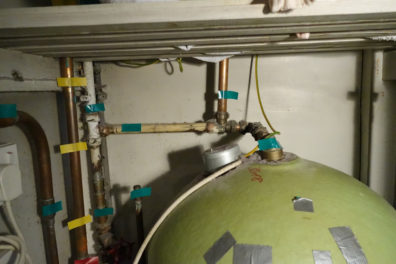

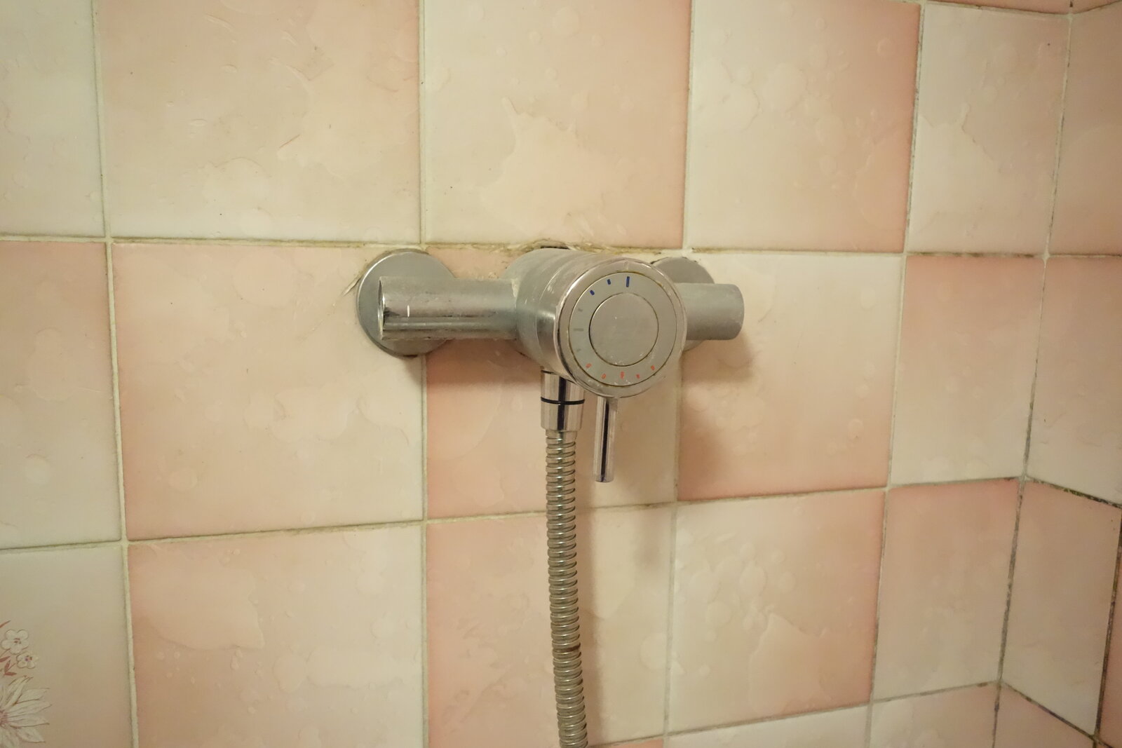

I have a gravity shower fed from the hot water cylinder and the cold water tank. Every other time I turn on the shower the water is only flowing about half as fast as it ought to. Usually I can fix this by holding the hose stretched out and downwards and giving it a shake. There is a gurgle and the water starts flowing at its full force. If this doesn't work I can normally fix the problem by unscrewing the hose (see pic) and letting the water run fast for a couple of seconds. Again this is accompanied by a momentary gurgling and spluttering.
The spluttering suggests air is the problem, but if so, is the air blocking the hot or cold feed, and is so, whereabouts?

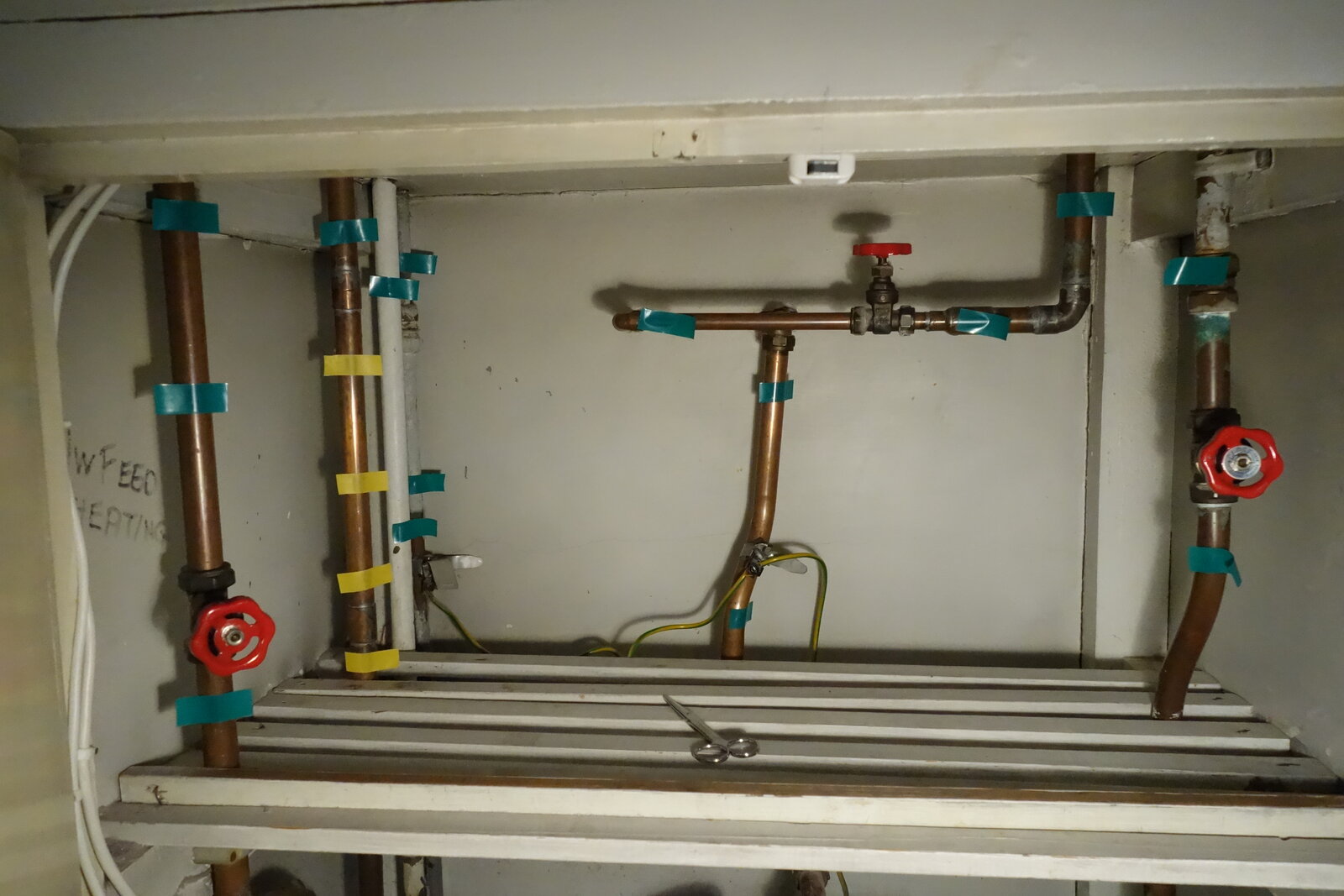

I haven't thought of inverted U traps; that could be the answer. Unfortunately my plumbing knowledge is at the same level as my knowledge of embroidery. I don't know anything about vents, but I will attach two old pictures from inside the airing cupboard. The centre of the first picture shows the hot and cold pipes going through into the bathroom. The second pic was taken just below and shows the hot water pipe emerging from the cylinder (that vertical pipe is one with the vertical pipe in the centre of the first pic)

Unfortunately that pipework in the pics looks a tad badly designed, it currently allows any air bubbles that are vented out of the cylinder (when the water is heated) to rise up the first vertical pipe it comes across, expelling the water in that pipe and creating an airlock. When the outlets is opened the air has enough pressure to hold back the gravity water and when dropping the shower head or disconnecting it, that is creating enough flow to overcoming the resistance created by the air in the HW pipe and allows it to be expelled (the gurgling), then the HW can flow properly.

Is the shower valve below the level of the pipes through the wall? If so, that might not help.

Back to your specific problem. @Madrab has already explained that gas bubbles will be encouraged to rise into your shower valve, in lowering your shower hose you reduce the inlet pressure needed to push the (hot) water out, the hot flow increases and drags air bubbles along with it. As more air is ejected the flow increases further.
To prevent those gas bubbles rising into your shower pipework install a 'u' bend into the hot supply pipework by rotating that compression 'tee', so that hot water first flows down before up to the shower valve, a simple job for any embroiderer or plumber.
Thanks MeldrewsMate, that makes perfect sense and takes me back to physics classes at school many decades ago. Considering the various dodgy jobs that have been perpetrated on my house plumbing I would not be surprised to find sinusoidal or even helical piping somewhere. I think I have identified what you call the compression tee (immediately above the immersion heater), in which case it makes sense; the air would travel leftwards to the white pipe on the left, and then upwards. I don't know where that white pipe ends, but could it be the 'vent' others have mentioned?
Yes, pic 2 centre, the 15mm pipe travelling upwards seems to be the hot feed to the shower, that needs to point downwards. That can be achieved by disconnecting the up pipe, loosen and twist the tee so the upwards leg point downwards, then square some pipe so it travels downwards, left, back upwards over the pipe running left then up to join back up to the hot feed to the shower. it's not ideal by a long chalk but would remove the tendency for the air bubbles to migrate into that shower feed pipe.
That white pipe to the left will travel upwards (the vent) into the loft and up and curve over in down into the Cold Water Storage Cistern (CWSC), that's the safety vent pipe. It travels downwards to supply the rest of the HW outlets.
