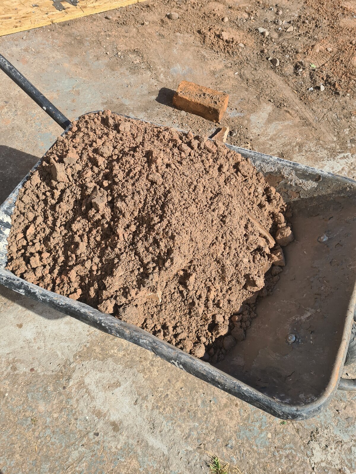

Thank you for your reply, I think if I'm to go below the sewer pipe, the depth will need to be about 2.3m.
The architect has mentioned a 1.2m beam which sits on two concrete pads. This would be above the sewer pipe. He states once we know the exact location of the drains he can calculate angles, so the pipes bear no load.
This would require a build over agreement with severn trent.
This is what's coming out the ground at 1.5m, I guessing this is just soil and sand? Is this adequate for a concrete trench foundation, as even at 2.3m I might not find clay, as the area has been excavated.
Any other suggestions?
