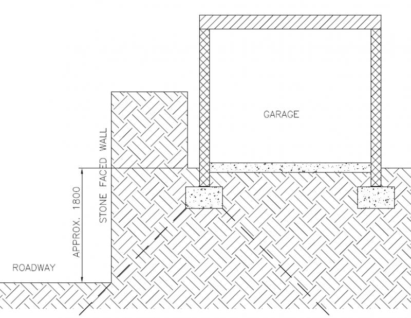

Ive just been sent a few measurements, and put it on a quick sketch (its no CAD)
There is no wall at the bottom, just a wooden fence. Plan is the use the area thats 13foor wide to put put the workshop around 9-10ftwide as close as possible to the fence
Hope this helps slightly.

OK, so now we know the embankment is stable 30 + years. I'd still like to confirm if the it's built up or an excavation for the canal. You can figure this out by looking at the house levels in the immediate local. Also an O.S. map will show this in more detail as seen here with the close packed small black lines. This tell a lot of what will have to be considered. I can give my opinion re any form of raft foundation which I would not give consideration.
Two options to consider - one: reinforcing the embankment with sheet piling or possibly gabion baskets (a engineers opinion would be useful here)- second: would be pilling, which would bring with it the problem of vibration.
With such a steep embankment, especially if it is infill rather than excavation, pilling vibration could set the entire embankment to move towards possible collapse, your local building control might be willing to give some free advice on this, more so if similar works have been done in the area.
Helical piles, new but not unknown are another type that could fit the bill, find a supplier and ask for a tech. rep. visit to establish suitability.
Cheers for now...pinenot :unsure:
When drawn accurately (as I did earlier), with standard strip foundations the garage should exert no extra pressure upon the bank or the canal, the 45 degree line pass by it all. I don't have cad on this lappy so can't do a screen grab just yet.
How deep would trench need for the 45degree line to pass by it all? Would adding rebar to footing help in anyway?
