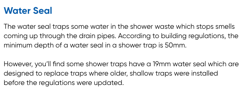

Not necessarily. See attached quote from Toolstation.com site

Op is talking about a bath waste not a shower one. I admit I don't know anything about regs but I stilll think he is measuring wrongly
Thank you both for taking time to give me your feedback. You measure the depth of seal the same way for either a bath or shower trap. For example, here is a trap that states it is suitable for either a bath or shower and says it has a 19mm trap depth. If you look at the drawing it shows the 19mm is from the top of the dip of the trap to the bottom of the outlet.
