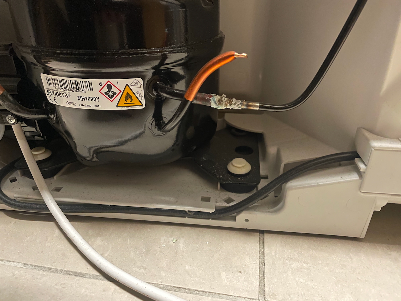

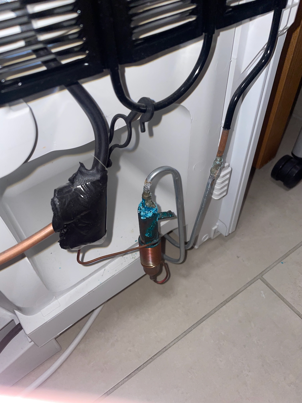

Hi,
So I've had (mould-like?) damage to my carpet where the freezer was. It is a Liebherr GP1476 freezer. Having spoke to dealer, they were surprised and fairly assertive in saying that placing a freezer on carpet shouldn't have been an issue.
Looking at the back of the Liebherr, I can see a significant amount of rust on the capillary tube as well as in another joint. Could the damage be as a result of a coolant leak or similar? I've since moved the freezer onto tiled floor and so far can seem to see no leaks or anything. Flipping through the freezer manual, it says nothing about type of flooring - and also nothing about possible maintenance of drip trays or similar (besides I can't see a drip tray at the back). I've sent the same pics to Liebherr and am still awaiting an answer.
Any light you folks can shed would be very much appreciated.

That may be so but my question is more if the amount of copper corrosion in the pics is normal for a ~3 years old freezer or indicative of something amiss.
That verdegree could be just caused by condensation not necassarily a leak. Clean it off and see if the pipes are pitted or it has just formed on the surface.
