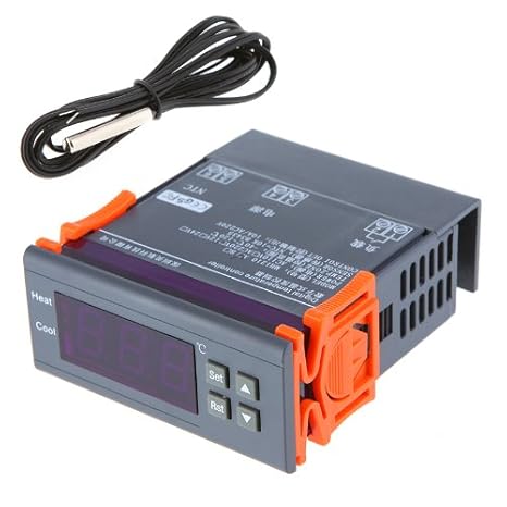

The second problem was measuring temperature. Freezing point of brine is -18°C so finding too cold was easy but my attempts to find a thermometer that would work in a freezer failed.
However I wanted to brew beer so I bought a MH1210A temperature controller which went -40ºC~120ºC ; measurement error: ±0.5ºC and used this to measure temperature.
Clearly the same device could control the freezer and I did consider using one as the temperature controller.
but as you can see from the picture it does not come mounted and the first job is to house the unit.
As an external control unit one can lift the temperature of any fridge or freezer but there are other considerations. The old fridge/freezer I use in the garage has an electronic control and the unit uses a sensor rather than a simple tube and so to repair becomes more of a problem.
