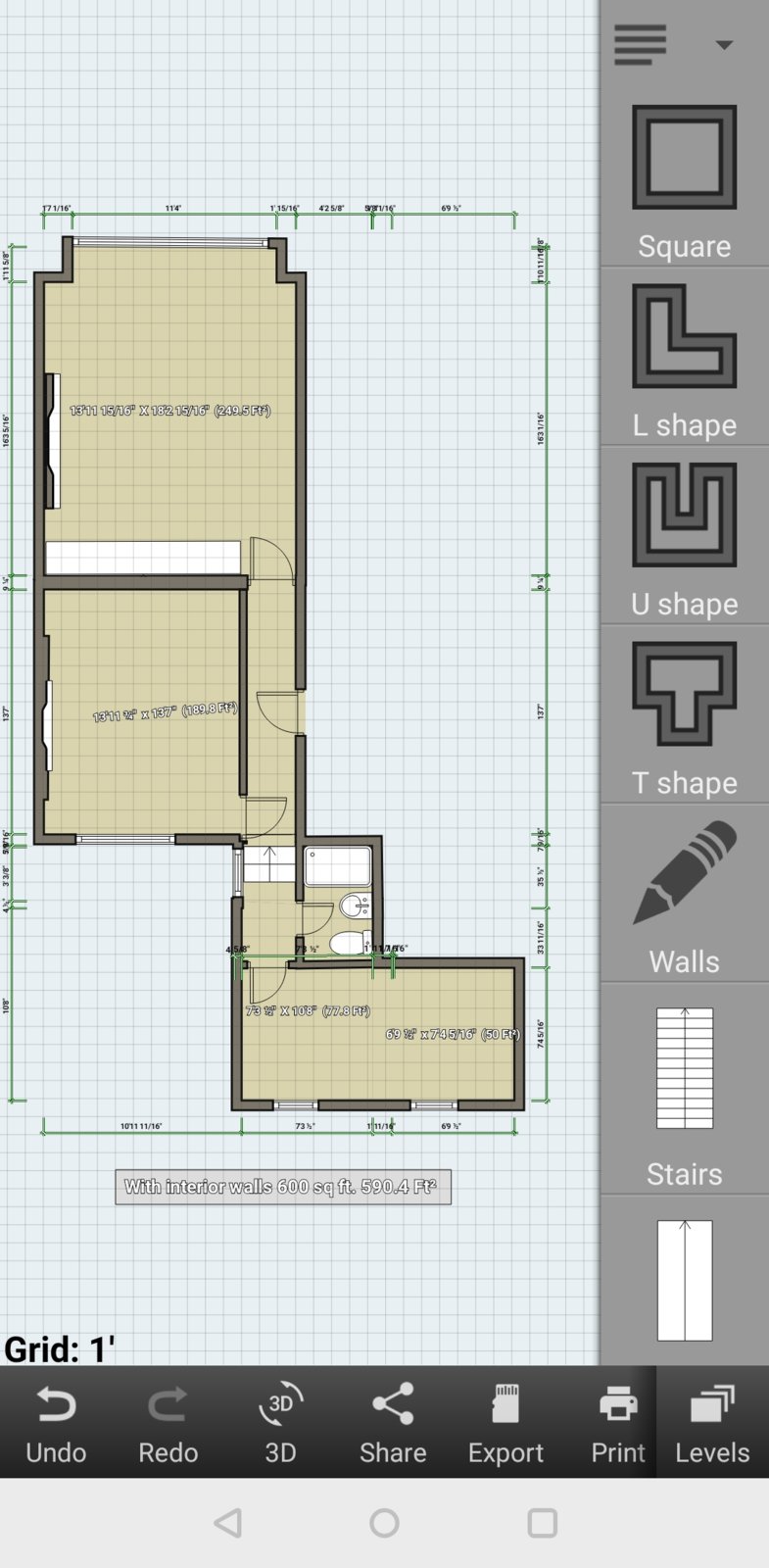

I am moving my front door of my flat. It's an internal fire door. The hall isn't very wide so when the front door will open it will block the hallway passage temporarily. Will this comply with building regulations? I really have no other option. See picture.

The picture don't say much. Where is the front door now, where is it going?

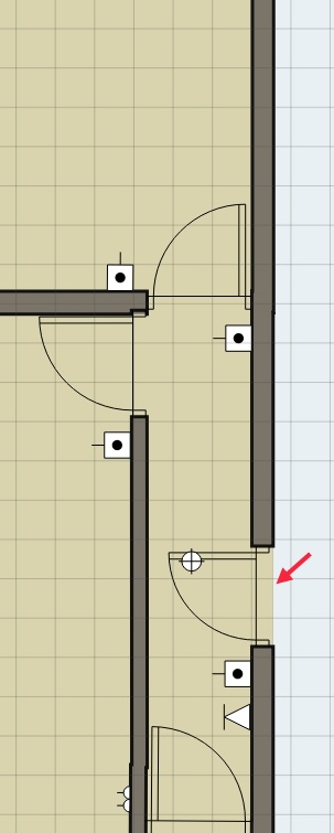

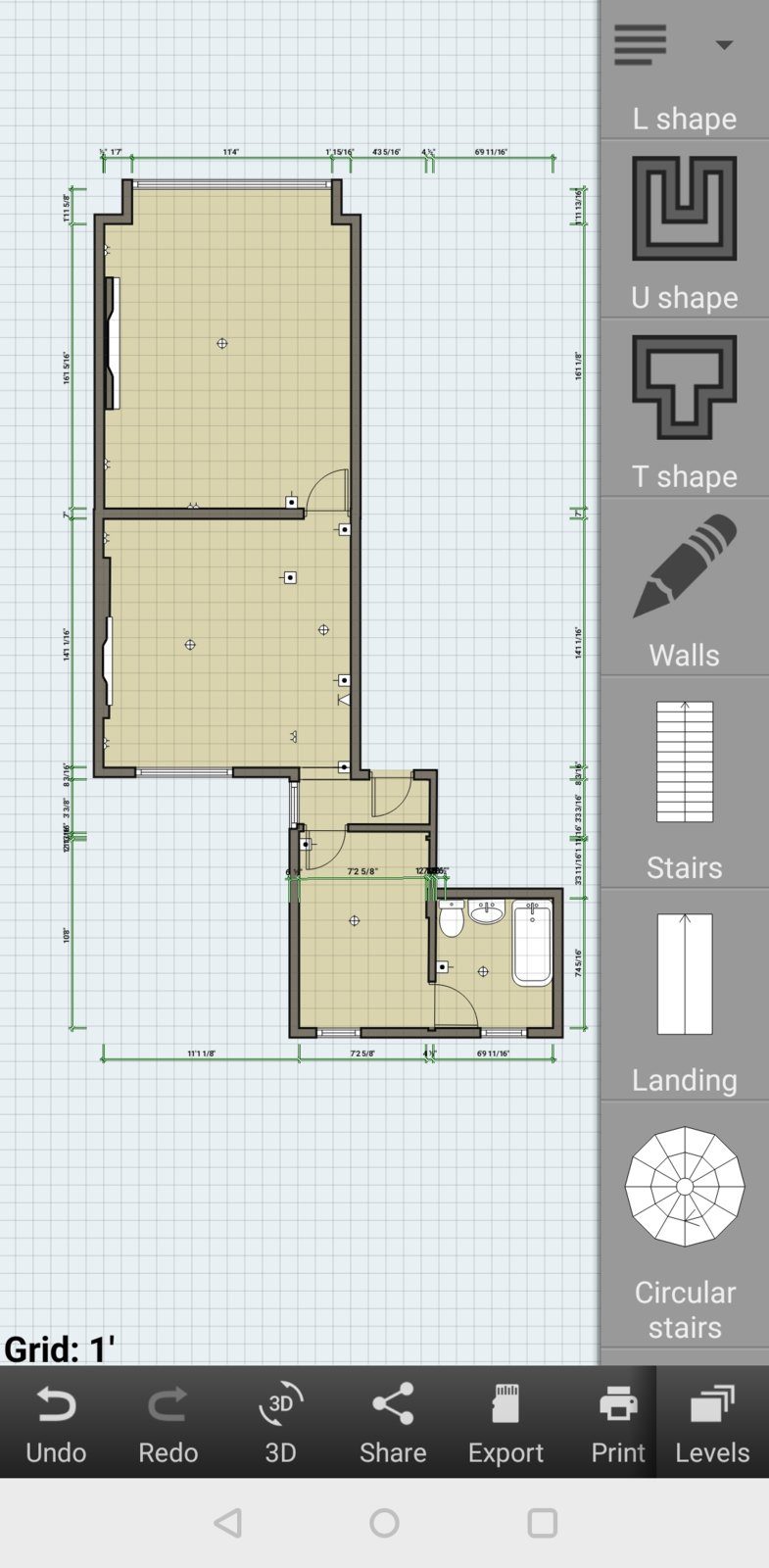

The front door was originally see first pic. I am moving it to second pic. The door of the flat is inside the building on the first floor and is a fire door

The way a front door swings is not the issue, rather that you don't make the existing escape routes worse, and ensure that other safety measures are in place.
In fact you seem to be improving the situation as you are creating a protected escape route from all rooms, where there was none previously. So the door position is ok.
You will also need to ensure that new walls to the hallway are 30 minutes fire rated, and provide suitable smoke or heat detection/alarms.
Regarding the alarms, your landlord should have told you that he will need to arrange a new fire safety risk assessment, and it will be this which will determine the number and position of fire detection - and this will supersede any building regulation requirement.

Think about altering that door you show opening out near the steps, why not open it into the room and move it away from the steps.

pps doors on escape route ,apart from bathroom, also need to be 30 mins fire resisting as bldg. regs.
