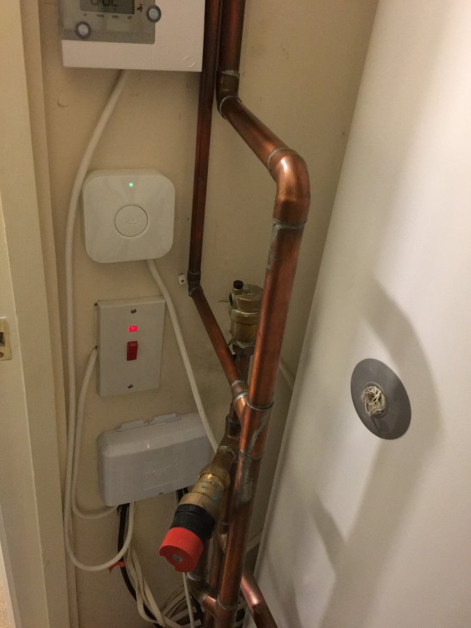

Here's what the airing cupboard looks like... I don't think the large switch is fused either.
I would think that red switch is more likely the immersion switch.
There must be one somewhere. Is the house a fairly new build? Maybe ask neighbours if they know where there's is
This is a relatively new installation. Previously that switch controlled all the power to a Boilermate 2000. House is about 12 years old.
There wire coming tight to the left of the switch, where does that go?
And the one to the right coming out of the hole in the wall where does that go?
On your main fuse board is the one marked central heating?

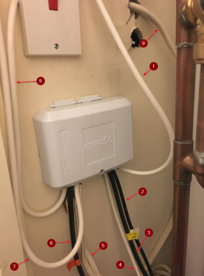

Apologies for the delay in responding to those who offered advice on this thread. Just after posting it I went away on holiday for 2 weeks and it completely went out of my head. However, due to another issue with the installation I thought it would be prudent to resurrect it.
I've attached a picture of the cabling and then run from the Megaflo wiring centre as follows:
1 - Nest Heat Link
2 - Pump
3 - Hot Water Zone Valve
4 - Megaflo Cylinder
5 - Bundle of 3 wires. One goes to Thermostat (now powering Nest controller). Remaining 2 goto Kitchen. 1 is used for boiler control the other is unused.
6 - Central Heating Zone Valve
7 - Timer (only used for Central Heating)
8 - Isolation Switch
Cable 9 is no longer used. It previously supplied the Boilermate 2000.
On the fuse board there is a 40A breaker for this circuit.

Isn't this switch exactly what it is meant to be, a two pole isolator ?
Actually the BG man was probably concerned that it did not have a fuse rather than the number of poles.
A three pole switch can also be used as a three, two or one pole switch.
I am not sure that I approve of disconnecting the earth on a boiler.
