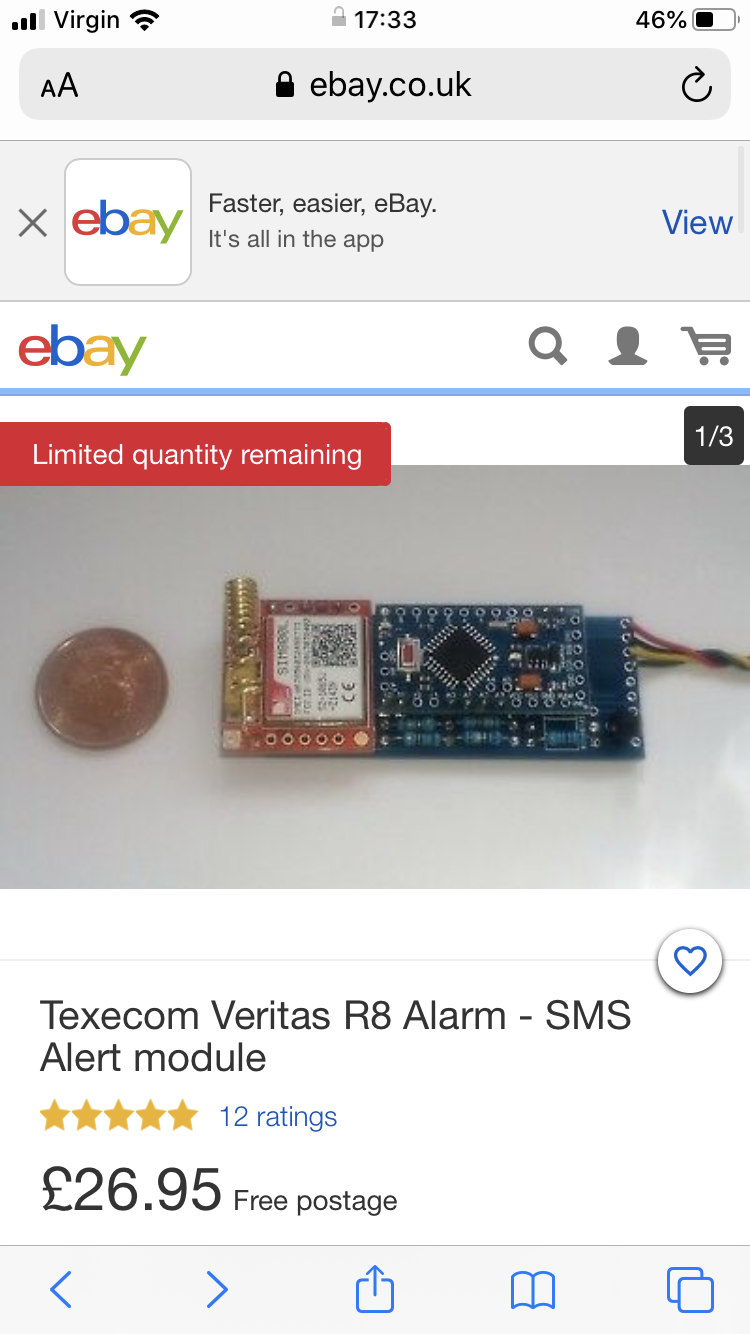

Can you get anything like this to selfmon a galaxy alarm
You could use that module to be fair.
wire the trigger inputs to an output or bell trigger.
Check the operating specs.
Yes you can. Google SelfMon, I have been using the service for a few years now on my G2-12. It works a treat.
So how do these things work ? I have read on the description what it does but not sure how to install on the panel and can I put any SIM card in that will text ring my mobile ? Or do I buy a pre loaded sim ?
it is a 2G service I believe and you can put any 2g sim in there I believe they were being sent out with giff gaff payasyougo sims.

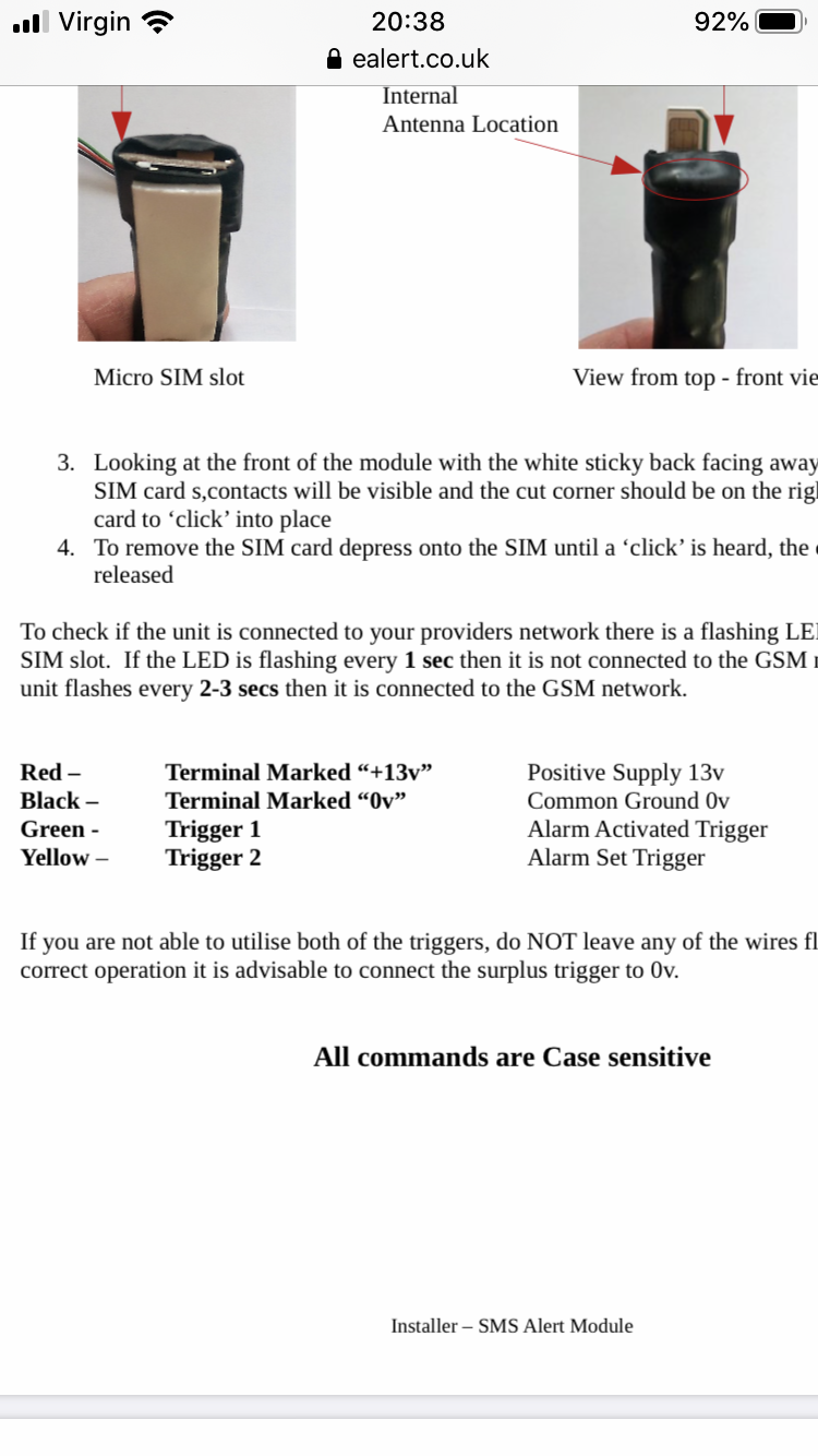

power, and two outputs, you may get more information off there web site https://www.ealert.co.uk/
There are few different models, 1 of which I believe can ring you, but doesn't play a message, the others send just a text.
Ask them any questions you have the guy that made them should be able to answer any questions

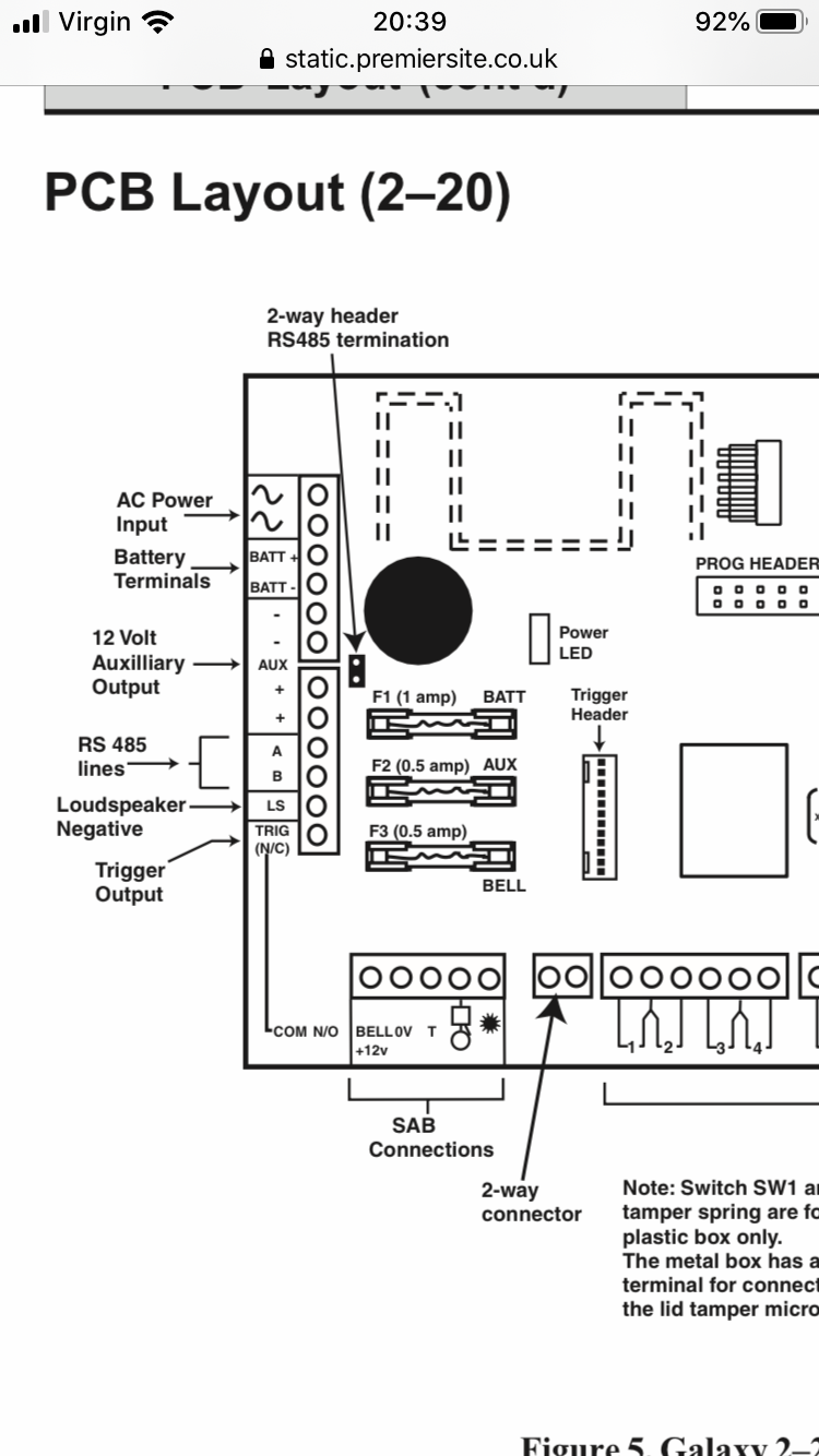

So I’m I correct in saying power
Red. -
Black -
Trigger 1 - panel bell trigger
Trigger 2 - panel trigger output
