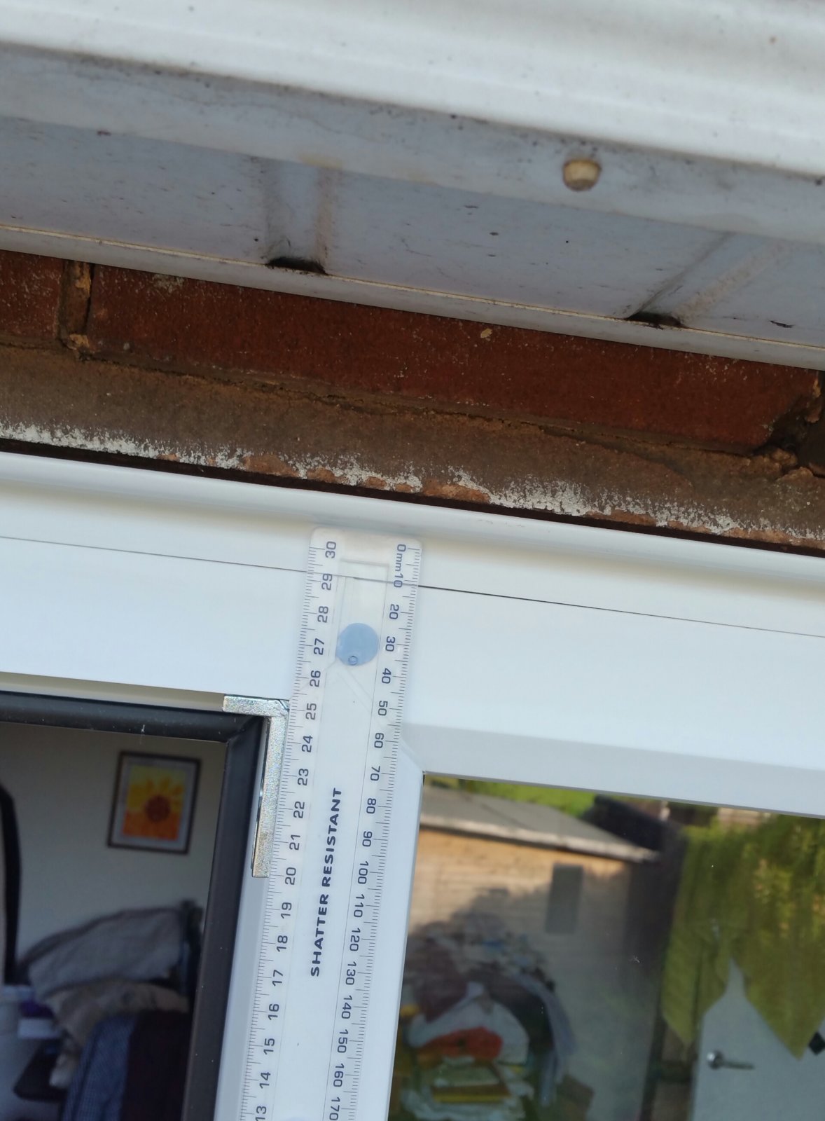

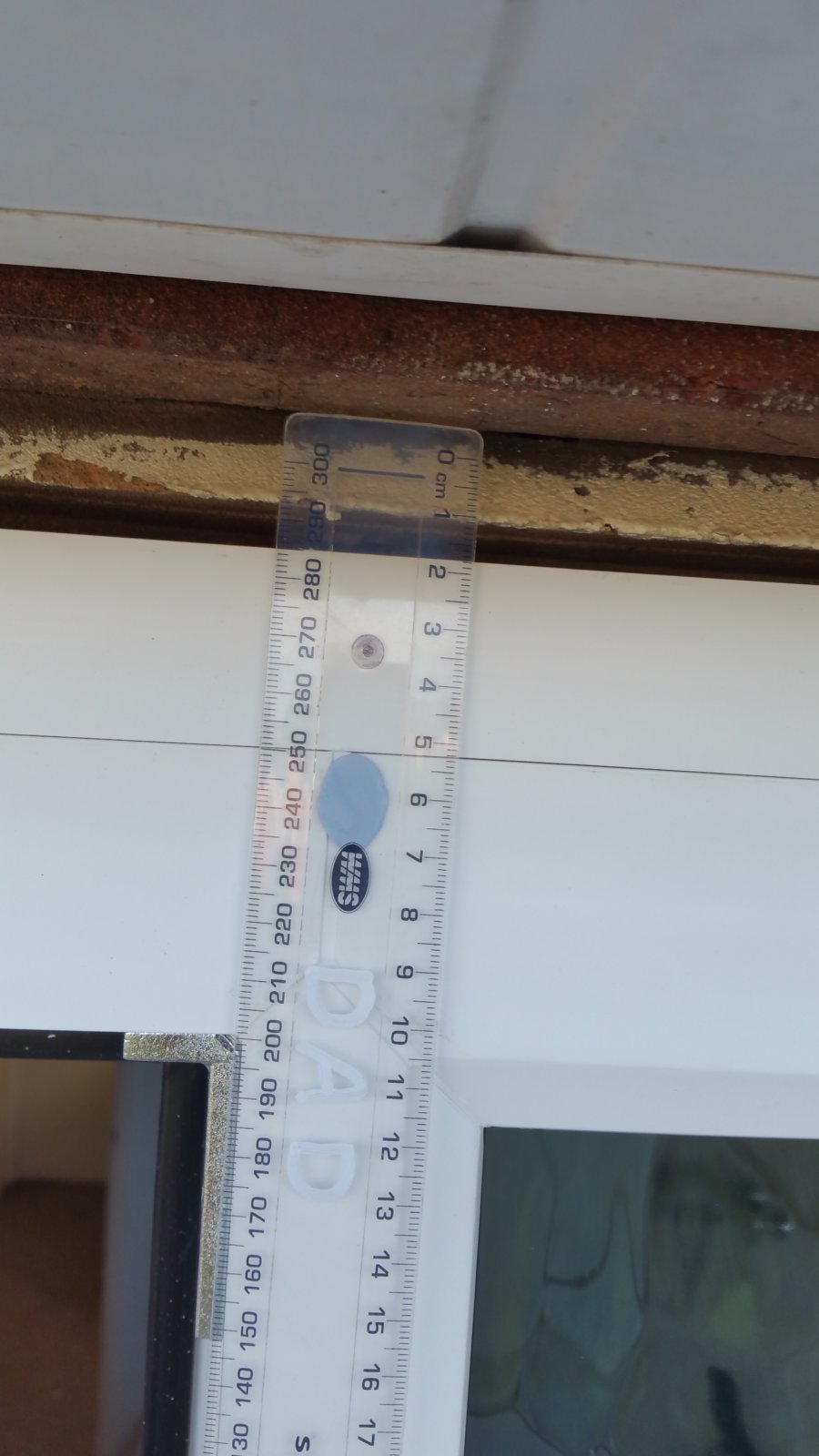

Having new double glazing installed. The window frames appear too short for the apertures. The fitters have added an extra piece to extend the width of the top of the frame, see photo.
From the inside you can see the top edge of the actual window frame, it shows as a thin line at the join with the filler piece.
The neighbours' house (it's a semi, so basically identical), hos no such filler pieces, their frames fill the aperture.
Am I being picky, or did the surveyor do a poor job measuring?

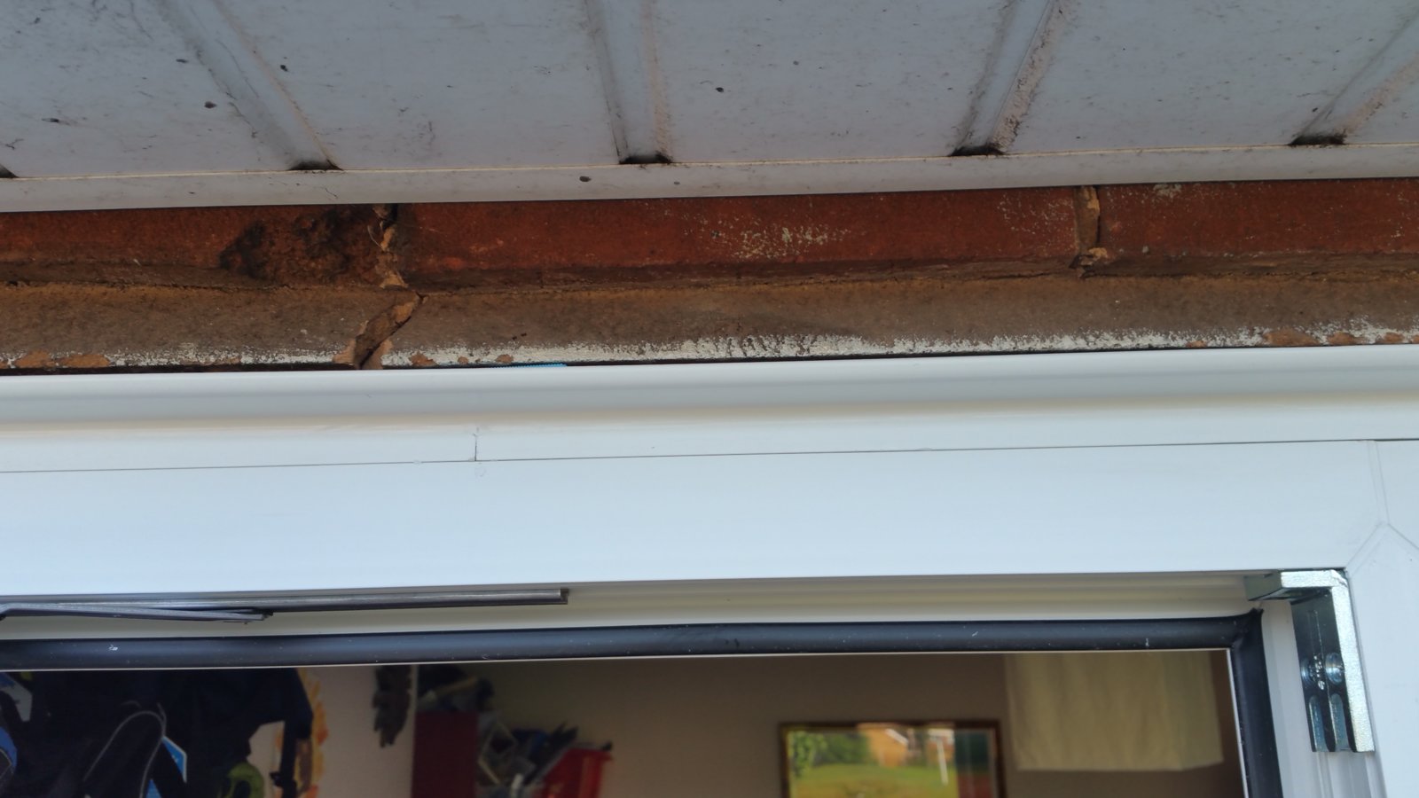

(The 1st two pics are the bedroom, already finished. The 3rd pic shows the bathroom. I stopped them on that window, so you can clearly see the full width of the filler piece at 35mm).
Its hard to say without knowing what was there before.
Surveying windows is not straightforward, it requires external and internal measurements.
It may be a miss measure or order error, but I wouldnt like to say without more info (as somebody that has measured hundreds of windows).
A picture showing the whole window wouldve put it in context -close ups dont really mean much

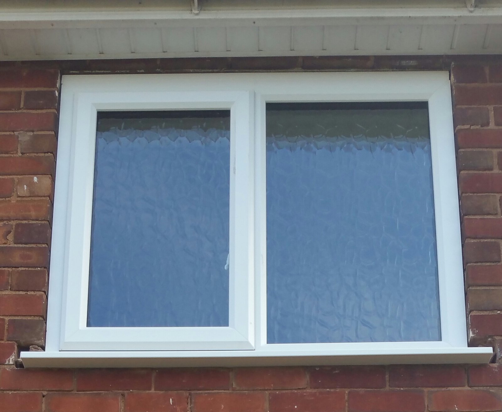

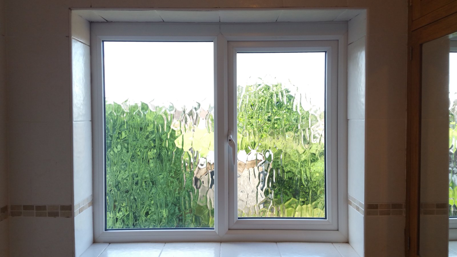

Attached are two pics of the bathroom window in full, indside and out.

Of the two latest photos, the first one looks to be unfinished - large gaps at the sides of the sills. Has it really been left like that and called complete?
As a layman, the gap at the top doesn't look too bad. They do always have to undersize a little, to be sure they can get them in the space, but even so, it looks unfinished.
The 'filler piece' seems to be original, it still bears the paint from when a previous window frame was painted.
The installation is not finished. I stopped the work as I was unhappy with this (and other aspects of the job).
The uPVC filler piece (I think they called it an add-on) is new. In my first post, 3rd photo, it is the uPVC part just above the blue-tac holding the ruler. Above that is a line of mortar presumably from the original window installation (with old yellow paint), above that is the bricks.
Looking at the interior photo (my 2nd post) you can just see the line (look just below the tiles at the top) where the window frame meets the filler piece. On the outside shot it is less clear, but at the left and right ends of the top of the window frame you can just make out where the filler meets the frame.
My issue is that this filler piece is 35mm wide. So I figure they made the window 35mm too small vertically - with the filler in situ there is still clearance above to fit the window. The same window on the neighbour's house fits with no filler pieces, and looks a lot better for that.
They were proposing to jack the window up to split the 35mm above and below. But even the fitter said that they normally work to an 8mm tolerance at each side, so with 35mm to play with, plus whatever gap is still there, that looks like poor measurement to me, well over twice the tolerance.
Yes, I see your point now. I would go further as to suggest that fillet of cement was a botch, when the first (wood frame?) windows were installed and ought to have been subsequently removed. There is a large crack in it, in your first photo.
I would reject them and invite them to do the job properly, plus investigate that cement fillet above the window(s). Perhaps there is a lintel hidden behind the cement?

Internally: will you have blinds fitted to the window hsad -in which the reduced height is an advantage, I sonetimes discuss this with customers.
