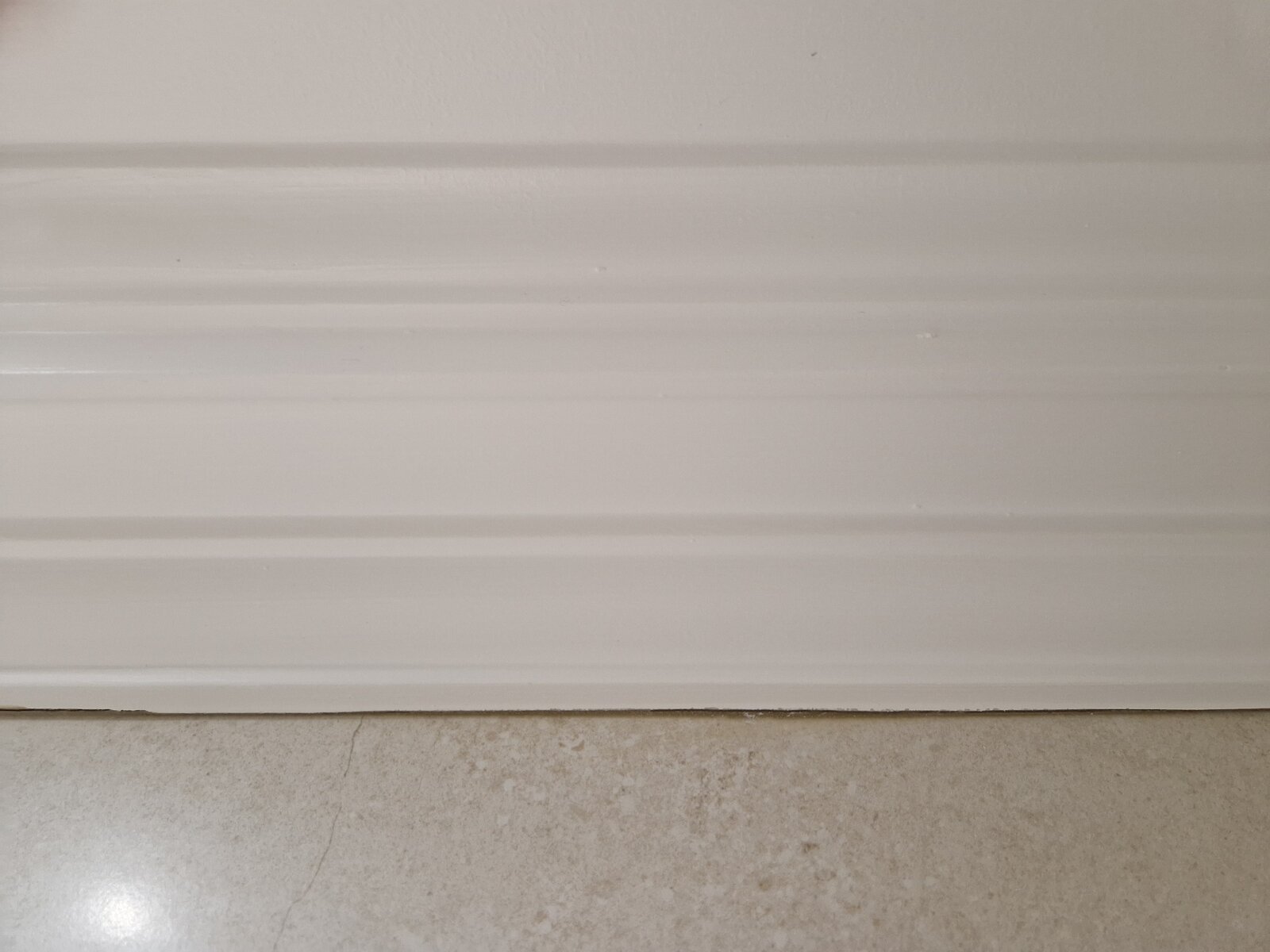

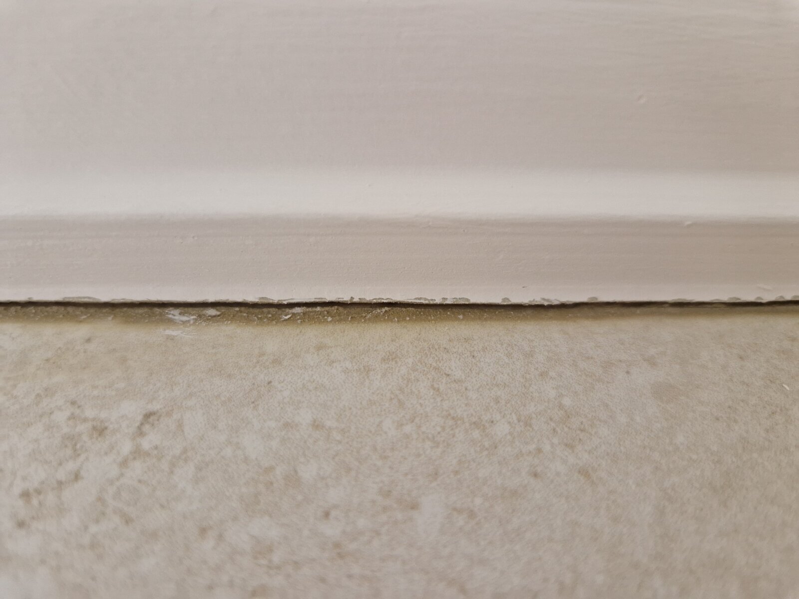

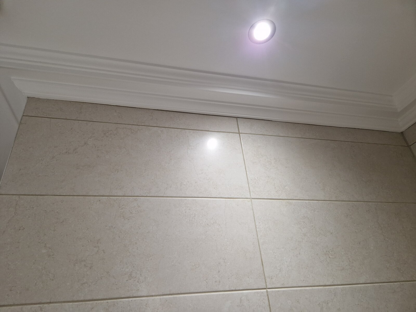

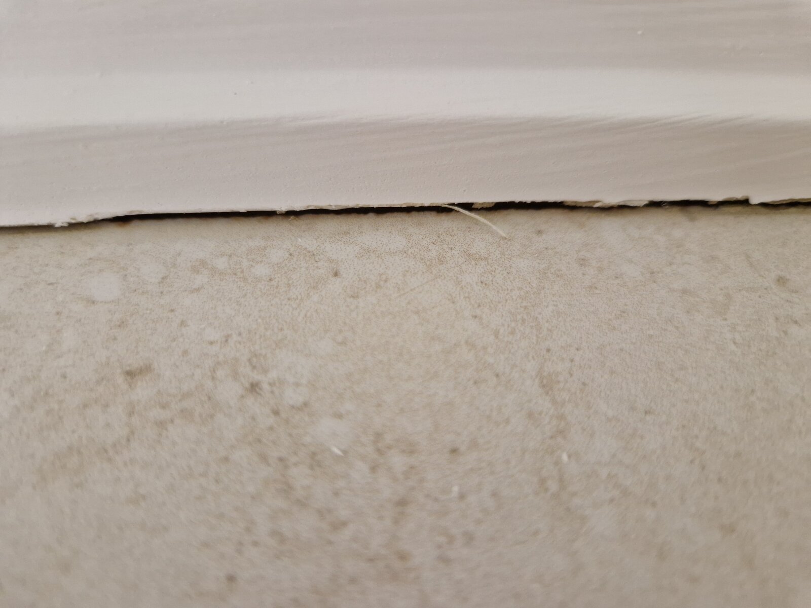

In my bathroom I have a small gap on one wall where the tiles meet the coving (I'm guessing due to settlement). Looks like the grout has maybe cracked and fallen out.
(See photos).
Just wondering what would be best to fill the gap please?

Thanks everyone for your speedy responses. I take it that decorators caulk wouldn't be an option? (I have a tube in the house). I also have filler that is a powder that you add water to.
Give it a try! You can always rake it out again if it cracks (unlikely). The tubed stuff is much easier and less messy.

Sorry @Burnerman but Flex and Fill is not designed to be a final gap filler. I use it a lot. Good product.
As you stated, it is like a caulk with fibres that reinforce it. I use it for filling cracks in plaster. It shrinks back and then I use other fillers over the top.
I genuinely respect your plumbing advice, but in this case, I would go @Wayners recommendation of a MS polymer. Any kind of caulk, including Flex and Fill risks becoming black in areas of high moisture.

Thank you for not taking umbrage. All caulks will shrink back, typically, they will do so after about 24 hours.
The MS polymers recommended by @Wayners will not shrink back and should not allow mould to penetrate.
From memory, I think I recall you recommending BT1, that would be ideal.

Thanks for the advice - is there a certain one you would recommend? Alternatively if I use the powder filler that I add water too then paint it would that be ok? Thanks
Again, as per @Wayners ' post. I would recommend something like CT1 or BT1- both are made by the same company.
The powder based fillers will be difficult to apply without straying on to the tiles, that said, you could use use a sponge to smooth it.
Great, thanks so much for your help
