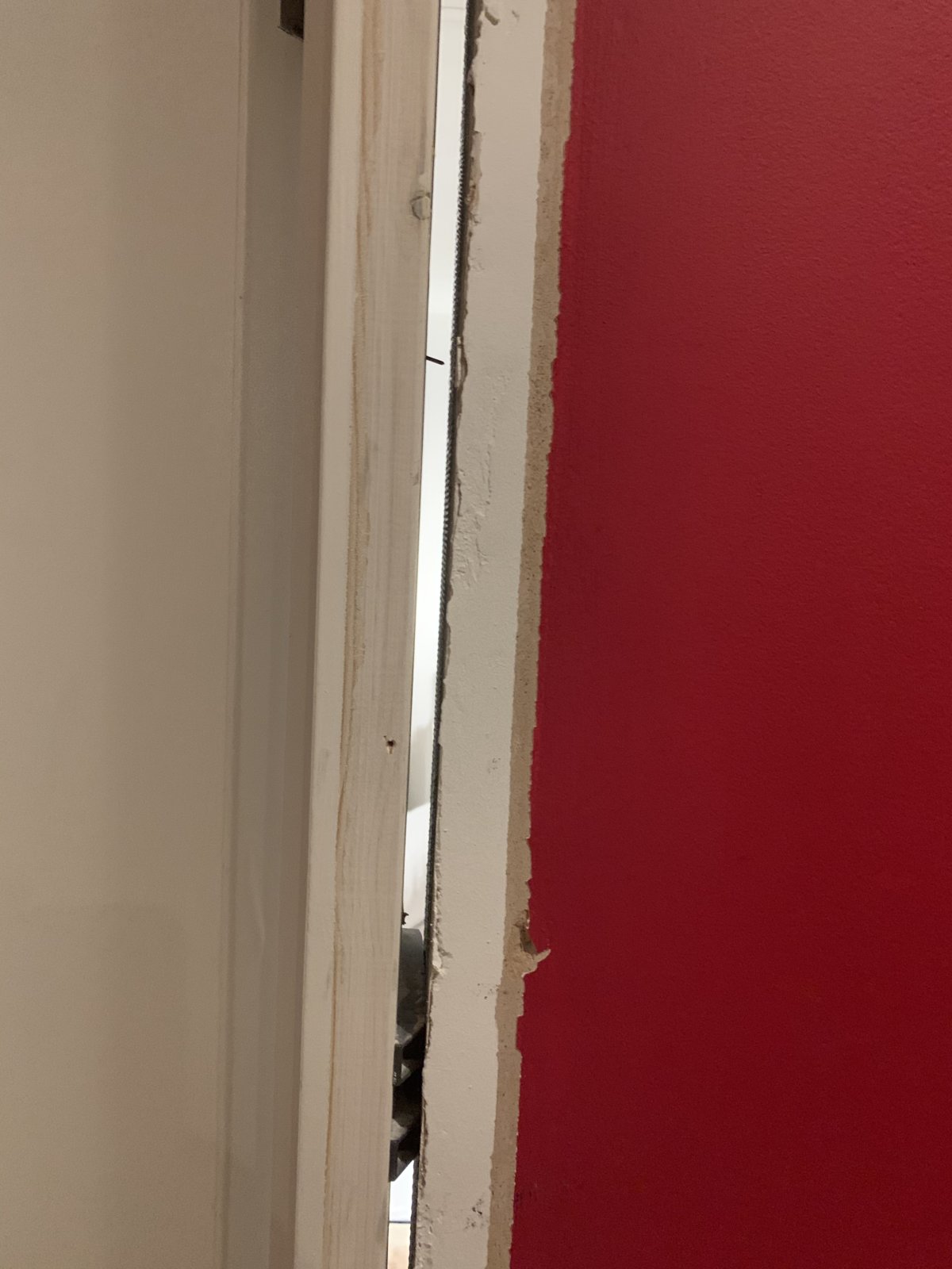

Hi all
wonder if you can help please
we recently removed skirting to renew it after having a newlamibstr floor. but we have noticed some large gaps between the wooden door frame and plaster board wall, some as wide as a couple of cm- please see picture.
do I need to fill these gaps with anything before reapplying new skirting?
I thought perhaps some kind of foam or insulation etc
If there’s any benefit to noise or warmth / insulation we could gain I would like to!
thanks guys!
If you fill those gaps by the judicious use of expanding foam (i.e. use less than you think you'll need as the stuff can really expand a lot) before applying the architraves then you'll reap the benefits of reduced noise transmission, reduced draughts and better heat retention. Any excess foam can be trimmed back with a bread knife or the like once it has set fully (leave 24 hours in the cold weather). BTW expanding foam shouldn't be used much below about 5 deg. C as it fails to work in low temperatures
