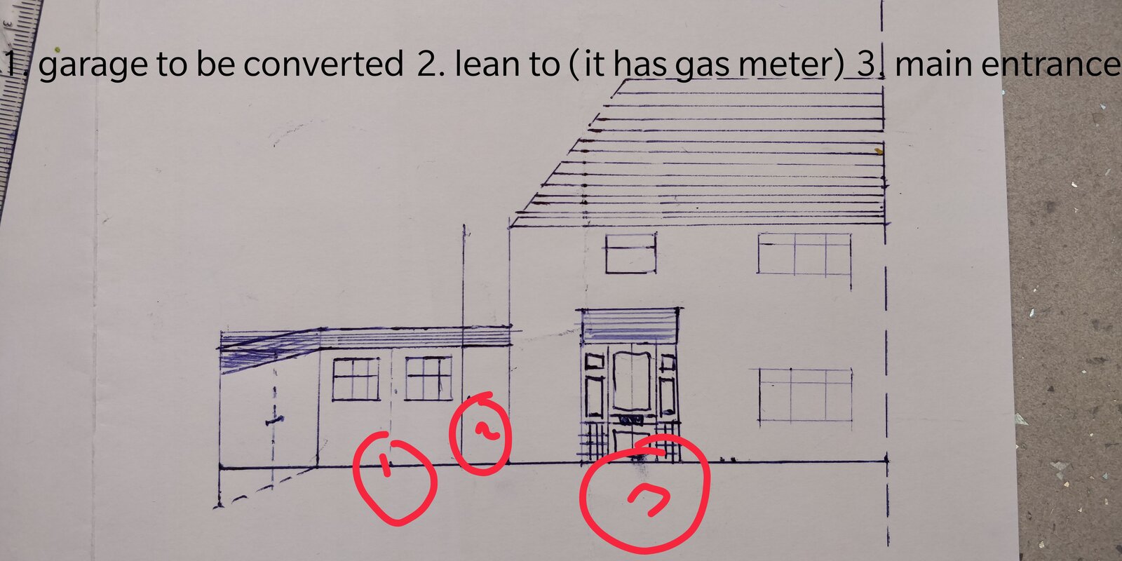

Hi
I have a 3 bed semi with a single garage next to it.
Over the years, previous owners have covered up the Lean To (3ft wide) between the house and the garage. Also doors with locks have been put to the front and back of the Lean To.
From the front it appears as if the garage is attached because the garage/lean-to front roof and gutters are attached to the main house.
I am planning to convert the garage into a gym/home office with toilet.
There is no planning restriction to keep the garage as a carport. There is also no covenants in the title deeds. The property is ex council 1950s.
Questions
1. Is this a permitted development to convert garage into gym/home office. It will require the garage door to be replaced with wall + window.
2. The Lean To has the gas meter. The Lean to itself hasn't been built over or anything except for the doors on both ends of the lean to. When building regs are done for garage conversion, will they ask me to relocate the gas meter elsewhere?
Thanks in advance
The gas meter is not covered by B regs, speak to the utilities Co.
A garage conversion is not a change of use as defined under the Building Regulations, so the B Regs applied are limited to the alterations you carry out, ie the installation of the WC, structural alterations, there may also be some Part B (fire safety) issues. Additionally Part L (thermal insulation) may apply as this is defined as a change in energy status, if the space was not previously heated and is now to include heating.

The OP was asking about permitted development. :rolleyes:
Garage conversions are PD if they meet the criteria and PD rights have not been removed.
Typically, you can remove the door and fit a window as long as you fit a frame similar in style to the rest of the house frontage windows, and its not a bow or otherwise projecting frame. Infill wall needs to match the house too.
