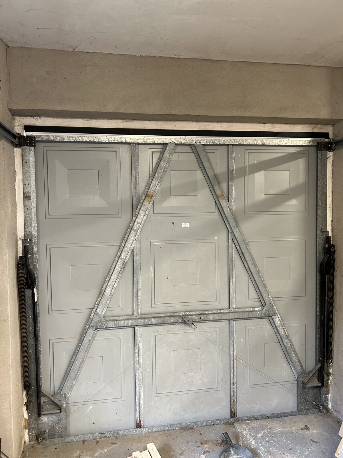

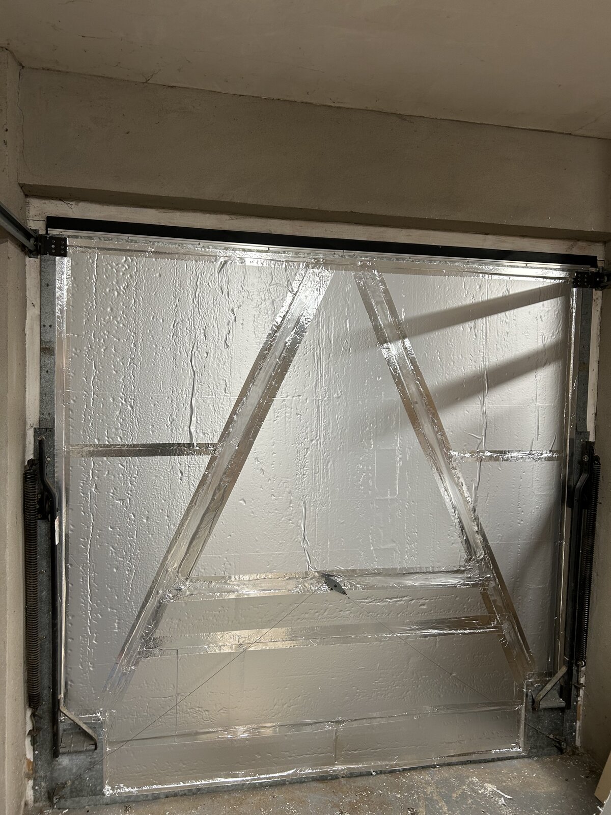

I have added xtratherm insulation boards to the back of our garage doors to help keep some heat in the garage.

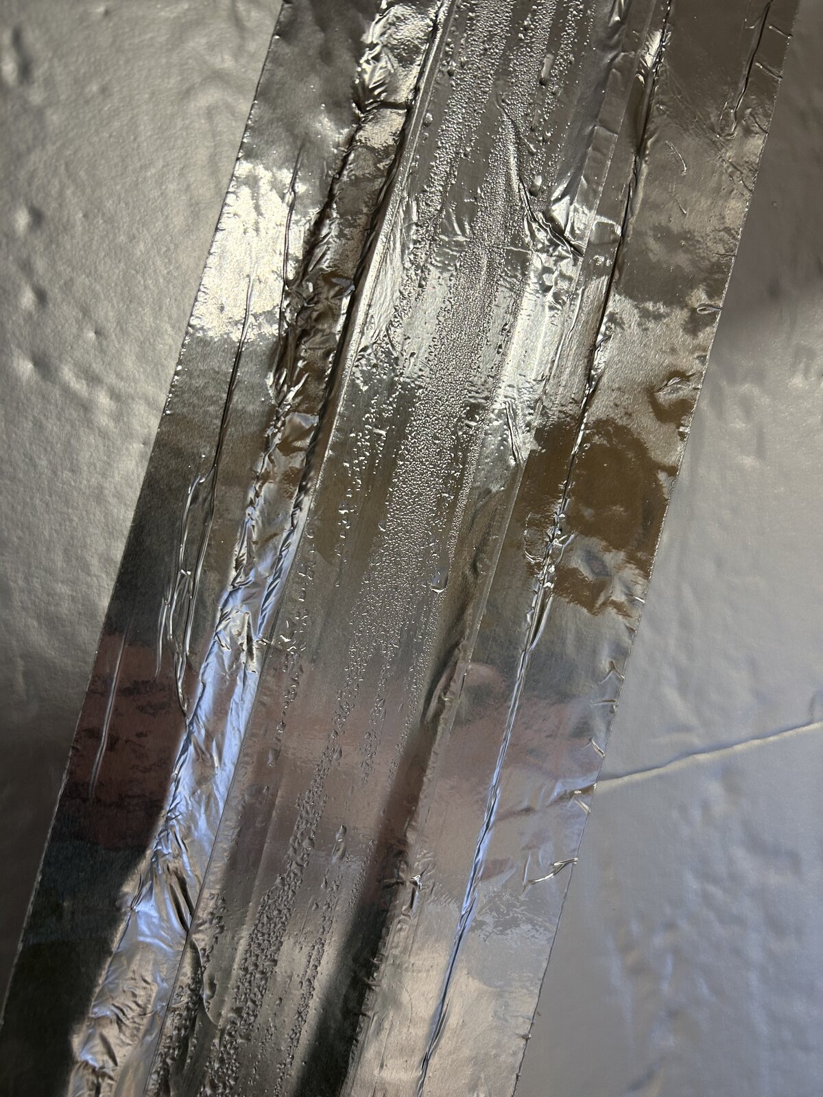

This morning I went out to have a nosey and noticed some condensation on the foil tape. It is specifically sitting on the tape stuck to the garage door metal.
Obviously it got very cold last night and the heat from the boiler (lives in the garage) meeting the cold surface of the metal has caused the condensation.
I’m hoping to add some form of cladding over the insulation for cosmetic purposes. Any form of wood sheeting would likely go mouldy with moisture in behind it.
Is there anyway to address this?

The reason it's only on the tape is that is uninsulated so a cold surface. It suggests to me your garage is humid, perhaps lacks ventilation ?
Do you have a humidity source in there, tumble dryer, clothes line ?
You might benefit from a dehumidifier (one that can deal with low temperatures).

I could probably fill the metal channels in the triangle shape with expanding foam to help insulate. Metal round the edge of the door just sits on the frame so not much I can do with it.
The tape is applied over where the door is reinforced with metal, the metal will allow cold to be conducted straight through the door and insulation, to the tape. The result is that any moisture will condense on the tape.
The only way to avoid that, will be to add an extra layer of insulation over the top, of where the tape is.

You may have to add a strip of insulation over the cold bars, it was 0 degrees here last night, anything much over 55% will condense in that. Have you checked for water leaks around the boiler, any damp patches on the ceiling, using it as a gym with to much heavy breathing etc ?

Another layer of something like the above be completely overkill?
Maybe best I just run some thin strips over the cold metal surfaces.
