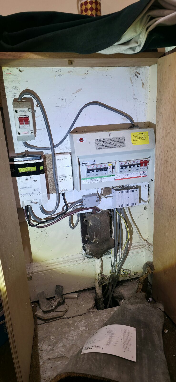

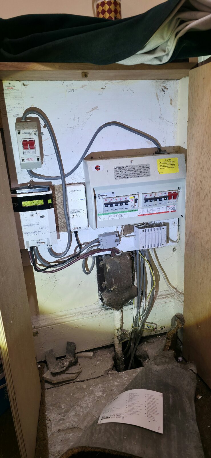

Here is the house CU, I believe that is a TN-S. This is before I started, the spare 32A MCB on the non RCD side is now on the RCD side and is being used for the garage
There seem to be only 3 power conductors going to the meter. What’s going on?
Edited to add:
It looks like the neutral current doesn’t pass through the meter. I guess it disappears under the board and into the back of the CU. Did you do that? I guess the meter will still record correctly, if it measures only the live current and the live-neutral voltage. Beware that having what should be a pair of conductors entering a metal CU through different holes can have dangerous consequences due to eddy currents.
Or have I misunderstood what is visible in the photo?
