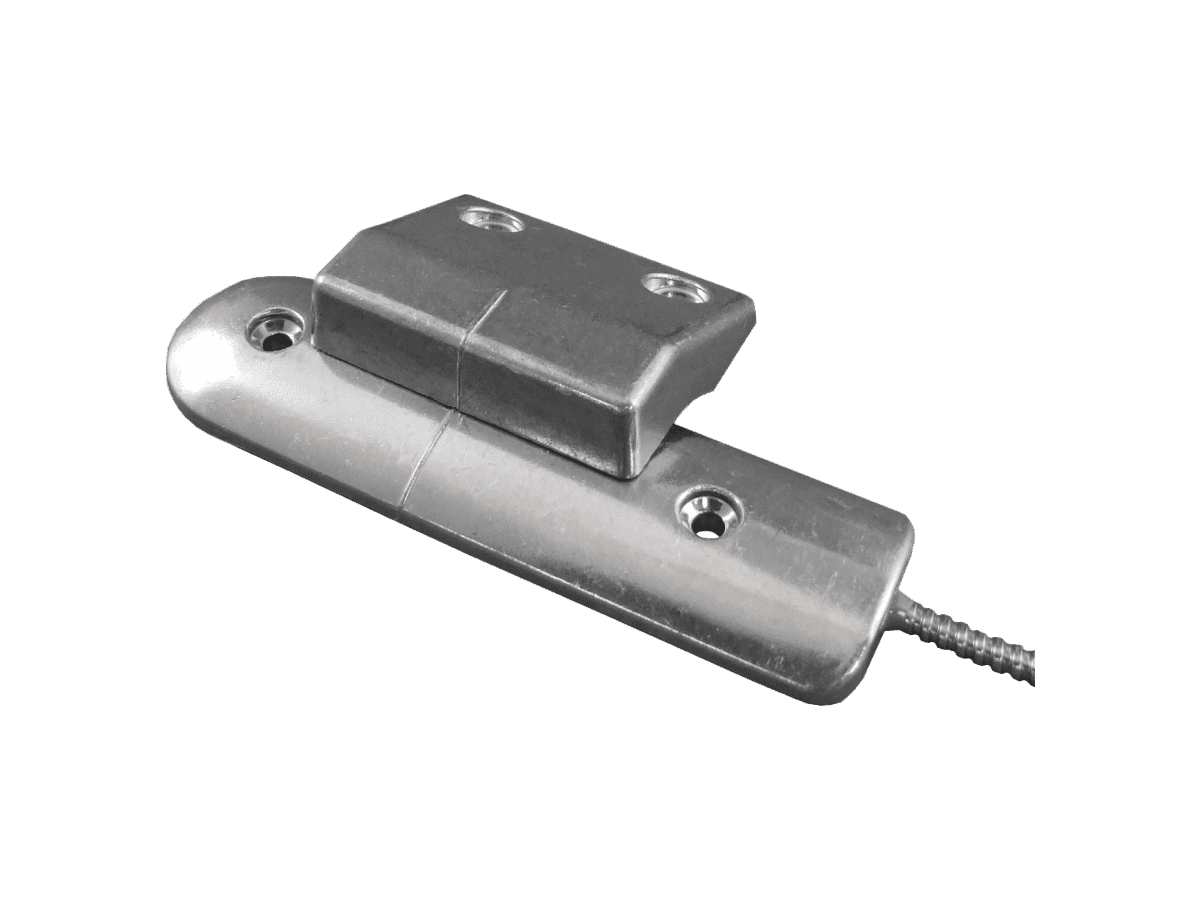

I have a domestic garage roller door with 70mm aluminium slats that I need to add an alarm contact or two to.
I was wondering if any of the pros on here had some photos of how they usually do this. I can't quite figure out the best way to mount the usual roller door style contact.
Ideally the contact would be mounted on the side guide rail rather than the floor.

Guide rails are 95mm wide and the bottom rail has the same curve as the rest of the slats
Site roller contact on floor and magnet on door 90 deg to your posted photo of rs contact.
You may require a packer under the contact to lift the contact to fit door better.
Post around with wiring to get best postion before fixing.20mm/ 25mm gap between contact and magnet should be ok, check first.
Fitting on side could cause issues with roller when door opens, may hit top roller rail boxing.
Sorry, the door seals down on to block paving which is why I was hoping not to mount the sensor on the ground. I guess this isnt actually a problem?
As the slats have a concave profile I was wondering about bonding a thin magnet to them which could be picked up by a contact mounted on the guide rail.
Would that work, or is it a bodge?
These Heavy Duty contacts are designed to be mounted on the floor and driven over by HGVs
Have been around for years, no problems
FWIW, the large industrial sort (pictured above) which I bought was just too big for my domestic-scale door. Instead, I 3d printed a mount to go on the bottom door lath which matched the concave profile of it and brought a conventional door contact out far enough to meet the reed switch mounted on the fixed rails. Happy enough with it and does the job.

Thats the exact contact I bought from toolstation yesterday.
Let me know how you get on with your fitment method, it looks good to me

Will do (and yes, good spot of toolstation's finest!). TBH though, it's working now and I can't see it failing so it'll probably stay as it is. I didn't want to screw into the door laths, so the screws go into the spacer which is bonded to the door with some permanent double-sided tape. Not a perfect solution, but does the job.
If you have a 3d printer, I can send you the files, but it only took me 10 minutes to knock-up in sketch-up anyway, so it's almost worth you sorting your own to fit. If you're stuck, I'm happy to print another and post it to you if you think it will help you out.
