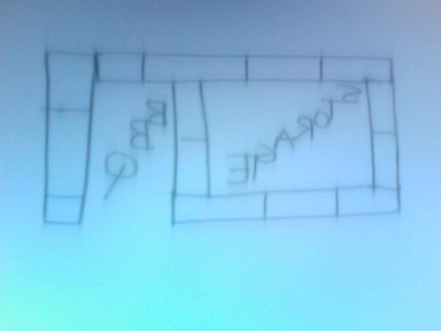

We've got a lovely paved garden in our new home and the Missus now wants a BBQ and SPACE FOR STORAGE....
I've designed it and its gonna take 600 Bricks approx.
Feel free to look at the Photo i've attached in the GARDEN PROJECT ALBUM. Its a really rubbish drawing of the Project's Footprint, so you can see the design...

Thanks for replying Mate.
Yeah, 600 Bricks !
I'll describe it a lil so you can picture it.
At the back of our garden we have a small Brick wall,
its 3 bricks high and 25 wide (approx) 75 bricks total.
I want to build another 7 courses (if thats the right term)
above these 3, so I'll have a wall approx 80cm high
and still 25 bricks wide (approx 570cm)
If you look at my really bad drawing, this new wall
im building will be the back of the BBQ/STORAGE
im building.
From this wall I'll build a lil rectangle "Storage space"
and pay a Carpenter to build a Lid for it that slants.
(this is the rectangle in the drawing)

I'll need another 240 Bricks to build the other 3 sides
of the Storage. Then I'll need another 40 to build the
small wall to the Left of the BBQ (which will support
the Grates)
Directly above the BBQ, I'll build the back wall a
metre higher, that way i won't burn my wooden
fence directly above the Fire. Thats gonna take a
further 60 odd bricks. Im assuming this will all be
secure enough LOL
Hopefully that makes sense ?
The Majority of the Bricks is going into the Storage,
the total width is 570cm, so you can see where the
Bricks are going. Believe me I wish it was less !!!

I see.
Not sure about the overall stability though, esp where you are going to extend the wall above the bbq. It should tie in to something or surely it'll fall over.
You might consider building some mesh/galv strapping into the design to hold it together. The heat of the bbq will most likely induce a little expansion and contraction in the bricks.

Yeah, Good Thinking.
What I'll probably end up doing is attaching some kind of Heat Resistant Garden Feature on the Fence above the fire. Im sure the Missus would love that. I was only considering the extended Bricks to protect the fence. I'll scrap that from the design and drill something suitable up instead, save me some money.....
THANKS, you've got me thinking.
As for the rest of the brick structure, if the overall height is 80cm,
and every wall is supported by at least one other right angle (as seen in my brilliant drawing!) will that be enough to ensure it won't collapse ?
Or should I use a few Breeze Blocks I have lying around to support the Shed on the INSIDE ?

fast your the 2nd person whos going to build something on a 150mm concrete slab and its totaly wrong, if its that big think of it as building a house,how many houses have been built on slabs yet to see one , its easier to dig out a 300mm deep footing concrete it lay your bricks and then fill in with 100mm concrete after ,if it was a b and q 400mm by 600mm grill being used go ahead and do it on a slab ,but the size your talking about its easier to do it the way iam suggesting :)
