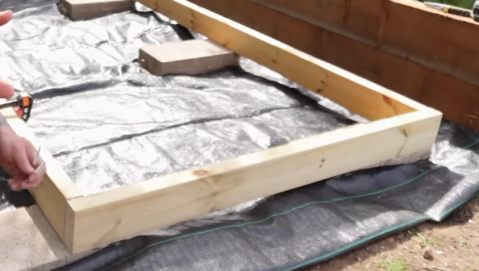

I am building a garden room with this type of foundation and floor system:
Will have lots more floor joist support in there. All resting on these concrete pads set in MOT Type1 and mortar.
I will fill the gaps with rigid insulation and then put a OSB Floor on it. Would it be helpful to put a membrane sheet over the joists and insulation before I screw on the top layer of OSB?
Hi, can someone please advise on where and whether I should use a membrane sheet in this floor construction?

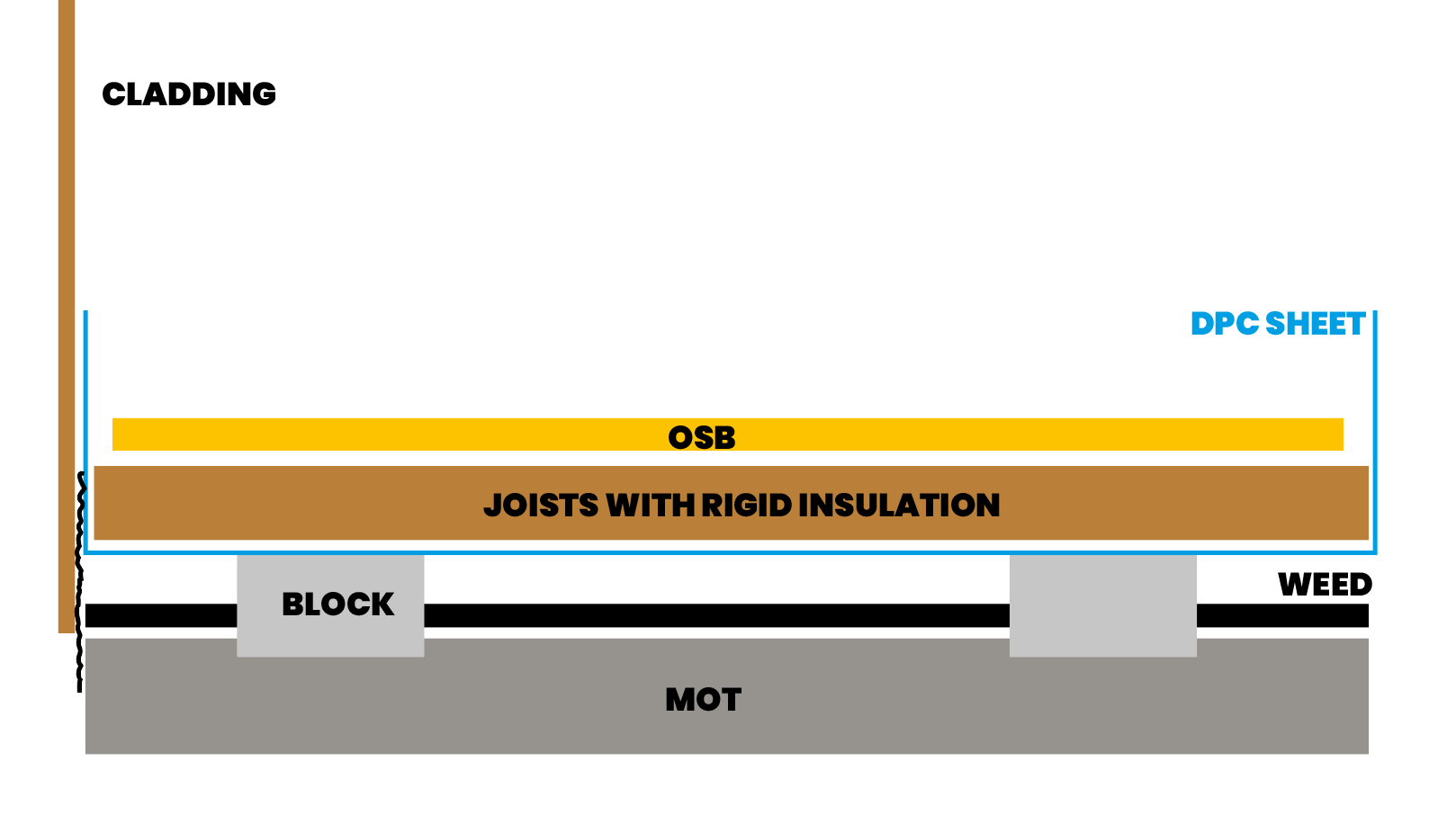

This is what I did
DPC keeps the critters out and gives the insulation some support

Yep, I just put a large sheet down and wrapped it up the sides of the timber framework like wrapping a present. If you pull it taught it will take the wight of the insulation if it's not tight against the sides
I think you need something as things will chew your insulation if they can get in.
Zig zag line is chicken wire.
Also did a gravel trench around the edge and the cladding sat on top of that so it looked tidy and the cladding wouldn't get soaked
Also added membrane to inner walls overlapping the dpc

Can they also chew the membrane and then get to the insulation? Sorry, not trying to be smart. Just want to understand it.
What thickness of rigid insulation do you recommended for the floor and walls?
I guess they could but the chicken wire buried hopefully keeps the chewers out from underneath.
As for insulation as thick as you can depending on cost. I guess the walls will only fit 50mm. Make sure you add loads to the roof. Hot air rises and ours was also mega hot in the summer as we had a rubber roof and not enough roof insulation
