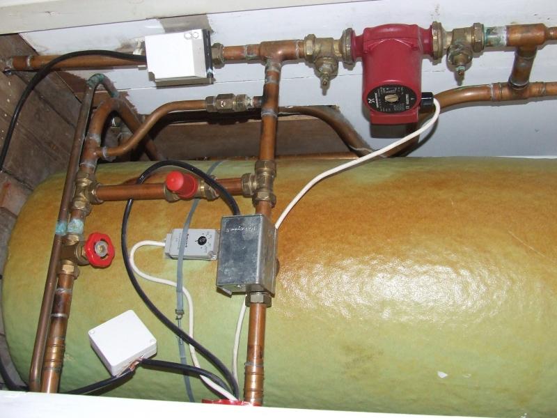

The auto bypass is adjacent to the pump in the airing cupboard which is 5 metres pipe length away. The boiler connections are 22mm - pipe changes to 28mm for the 5 metre run to the airing cupboard. Half of the run is exposed pipe high on the wall, other half is reasonably insulated (with a tumble dryer and general clutter) as it travels round a cupboard then into the airing cupboard.
Here's the airing cupboard

As you'll see from the photo posted the old gate valve is still there and can be partially opened. I'll open it partially this weekend see what happens. I'll also measure temperature differential across the boiler during the overheats. As is often the case, no overheat today? Fault appears in cycles?
The gate valve isnt the old by pass (valve with red handle) the old bypass is the silver poss Brass hard to tell in pic ballofix valve running parallel with the auto by-pass, open that up fully and see if that stops your problems

That would suggest to me that the bypass isn't letting enough flow.
Did you try opening the old bypass as suggested earlier?
