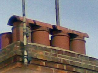

My chimney has not been used for several years and i wish to use it again by fitting a gas fire heater. Can someone tell me which type of gas cowl i require for my chimney. As you can see from the picture, current cowl insert is a Hood Top, i have been told this is incorrect for gas fuel heaters. Went to my local building merchants and they said they do stock gas cowls but were not in a position to give advice which type of cowls to use as this is something a gas safe engineer can only give advise. But they did mention DFE gas cowl flue terminal 225mm and Insert Terminals GC2 / GC5 external dia 205mm
Can someone please explain to me which one would be suited for my setup.

The type of cowls that you have fitted indicate to me that there have been problems with down drapht at sometime during in the past.
They are just rain cap inserts...nothing to do with downdraught and not approved for use with any type of fire.
Most gas fires work best without any chimney pot insert. Where birds are a problem suitable guards are available. Fire installer will sort out.

Just been reading up on the internet regarding cowls, these types of insert are for ventaliation purpose only, i maybe wrong! but considering this chimney hasn't been used for a while, fireplace in all rooms boarded up.
so i can just have the insert removed and install the relevant insert for mygas appliance. Would i need to fit new inserts for all 4 pots or can i just replace for the 2 pots. GasFire to fitted in front reception room and rear reception (Dinning room).

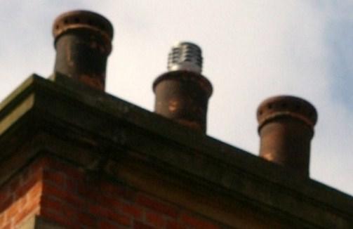

I've been thinking you could save a lot of work by just removing the insert from the chimney pot then put the cowl into the top of the pot pack around it with fibre glass to hold it in position/centralise it; then all you need do is flauch it round with sand and cement
Like this one's been done.
The middle one is the gc1 and the others are mushrooms, which are not suitable for gas appliances. [/img]
my gas engineer has already ordered the Brewer Cowl MkII but will use your idea on the other pots.. big thanks :)

I've magnified the cowls more and re-posted because I was a little disapointed with my previous photo not being that clear.
