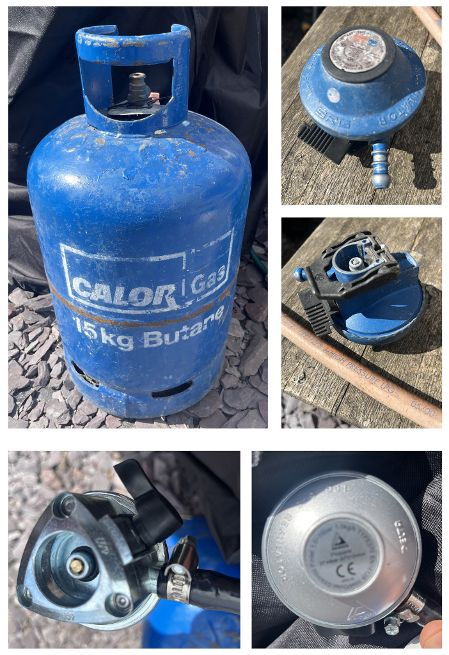

Hopefully the right place for this question - we've just bought a new barbeque to replace the old one (probably 25-30 years old!) but has come with a different regulator to the previous one. I've got an almost full 15kg bottle of gas left so just after advice if it would possibly be any issues taking off the new one and replacing with the old otherwise it's buying a completely new bottle at a hundred and whatever quid. The old regulator although performing well before is getting old now so should I just bite the bullet and get a new bottle?
On the old hose it reads 'BS 3212: 1991/2/8/3 High Pressure LPG 05/100' and on the new hose 'GUANGFENG GF516 6mm EN16436-1-class 2-8mm-10 bar'

As far as I am aware the only difference is that propane ignites more easily in lower temperatures. You can use butane, your blue bottle, with the appropriate regulator, without any issues.
I think the main difference is that Propane boils at a much lower temperature, making it more suitable for outside use.

Swap the regulator over. Blue works fine unless the temperature is down around 5-10 C or so ... summer caravanners exist happily with Butane except in an unexpected cold snap.
Almost all BBQs are happy to run on either Butane or Propane gas.

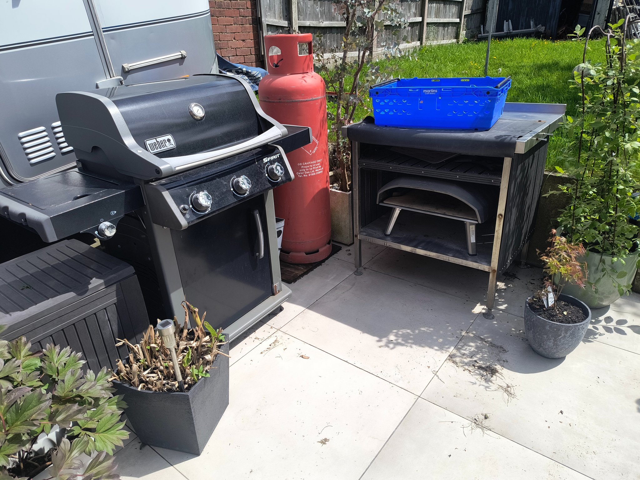

I run my BBQ and pizza oven on a big one:

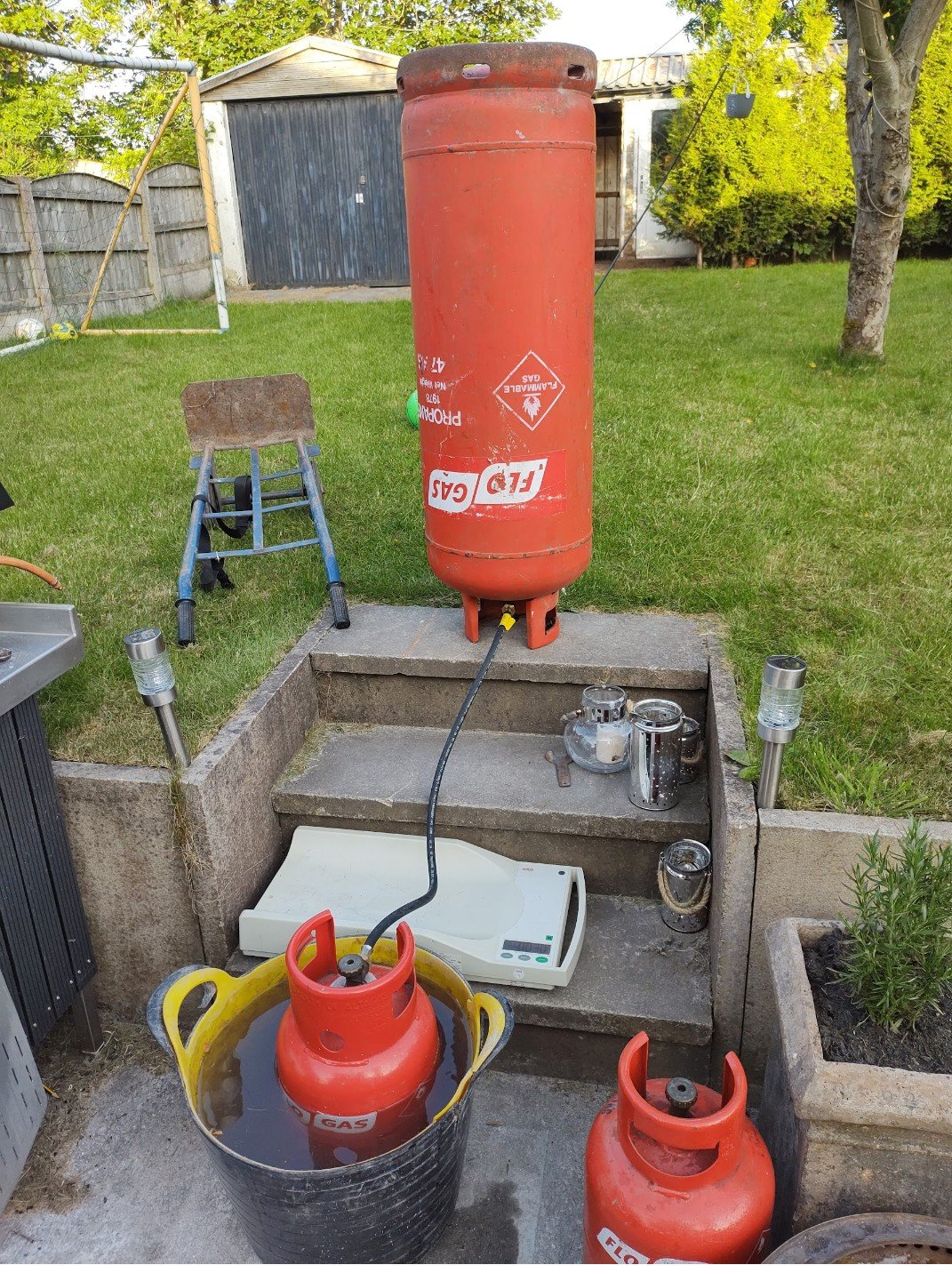

For my caravan I pour it into little ones. The squeamish should probably look away now:
