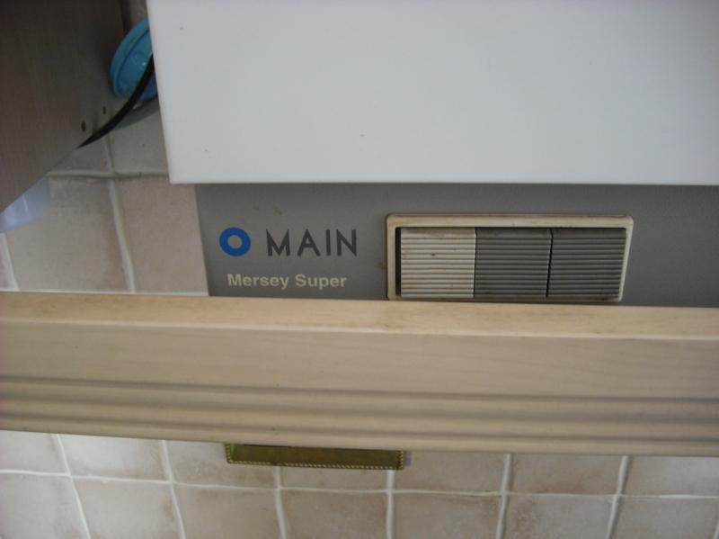

This is fitted in the kitchen of my new house (new to me) the survey described it as an internious water heater of some age and not safe.
Anyone know much about this unit?
I will be getting it changed to a combi before I move in tho.
Looks right dodgy and old to me.
Compartment ventilation and how do you remove the bottom cover for maintenance are possibilities.
Its called an instantaneous water heater.

Cool, just doing some googling, some not nice stories of these things.
Sooner it is replaced the better I think :)
Nothing wrong with these Main Medways. You have bought a tin pot of a house that's all.
A quick google suggests:
The Main Mersey Super is a room sealed instantaneous water heater
So we're not talking about an old Ascot here.
You can assume surveyors know nothing about gas appliances.
The only person who can tell you whether it's safe or dangerous is a Gas Safe registered engineer.[/u]

If it had been deemed unsafe by someone who knows ie r.g.i,they would of capped off the gas supply to it.what supplies the central heating?

main medways are good water heater
get it serviced and find out whats wrong with it
also what does a the guy looked at house know about gas apliances
