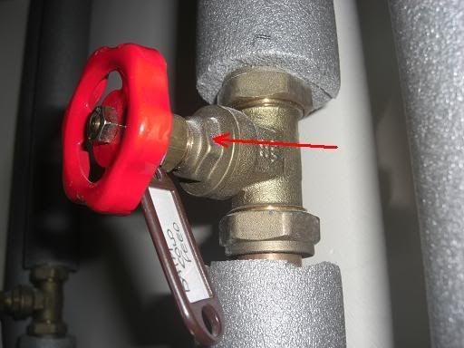

Apologies if this has been answered before.
So I could change the washer I closed the gate valve to the bath cold feed. No matter how far I turned I couldn't fully shut off the water... so I abandoned it and decided to open it again, unfortunately it would appear that in now doesn't open - I just have a trickle!
I've had a look around the web and it looks like the shaft might have broken (example at the bottom of this link)

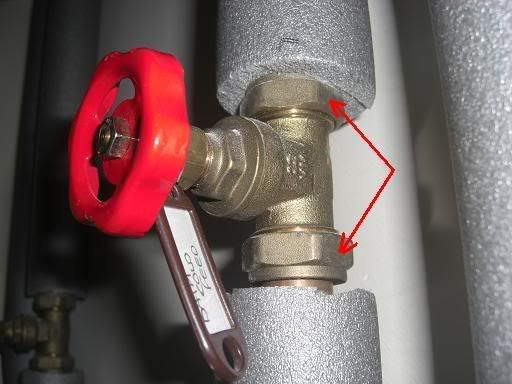

Is it a case of:
1. Buying a new valve (it has 22mm stamped on it - this standard?)
2. Turn off water to it (possibly involve cutting of water and draining the tank)
3. Undo the nuts pointed to by the red arrows
4. Put in new one and tighten up
5. Turn water back on
This the right way and have I missed anything?

that would do...or
you could bung the water outlet instead of wasting the water and you can undo the other nut that you can see in the picture and then no need to undo the 2 you pointed out
Some times the red wheel is made of very soft steel, The square hole that fits over the valve shank wears away into a 'round hole', so the wheel turns but does not turn the shank, either on or off.
Take off the red wheel first and see if it is that, if so, just get replacement wheel, or turn shank with mole grips for interim.

Checked the red wheel... it's intact and shaft is definitely turning! :)
Looks like replacing is the route, do I need to solder/cut anything or should it be a simple replace job??

you dont need to solder or cut,
Just put a bung in the tank feed to this pipe, slacken nuts with a towel wrapped round, whip out old valve, stick in new one and tighten up!!
no cutting
just bung the outlet in the tank...so no water goes down that pipe...you can buy bungs
but it will be cheaper (if not going to use the bungs again) to turn the water off to the house and just open the hot tap till it stops running
then undo the nut as described and replace it with the new one (having undo it at thew same place (it has to be the same model...but most are)
if not, do same but undo it at the nuts you said, this will work..other way can some times be easier if pipes have no play

I think it's save to say the old gate value was knackered and possibly broke in the worst possible position!! leaving a 2mm gap... unbelievable, yet typical!!
Unfortunately couldn't get in enough, to pull out this bit:
Went my first route and undid the 2 nuts and re-used them and the compression bit (?) mainly 'cos I couldn't remove them!! :?

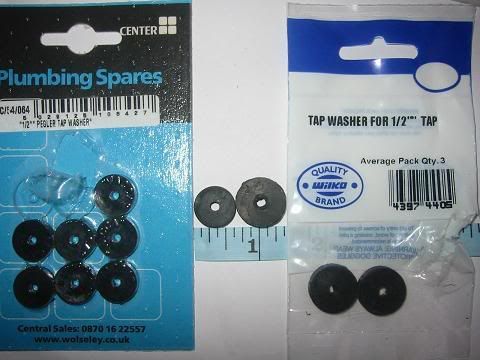

All works great, the biggest trouble I had was replacing the washers in the tap!!! Shameful! I couldn't believe the differences between 2 versions of the 1/2" tap washer, spent an hour trying to get the wilkos one in... far too big!!
