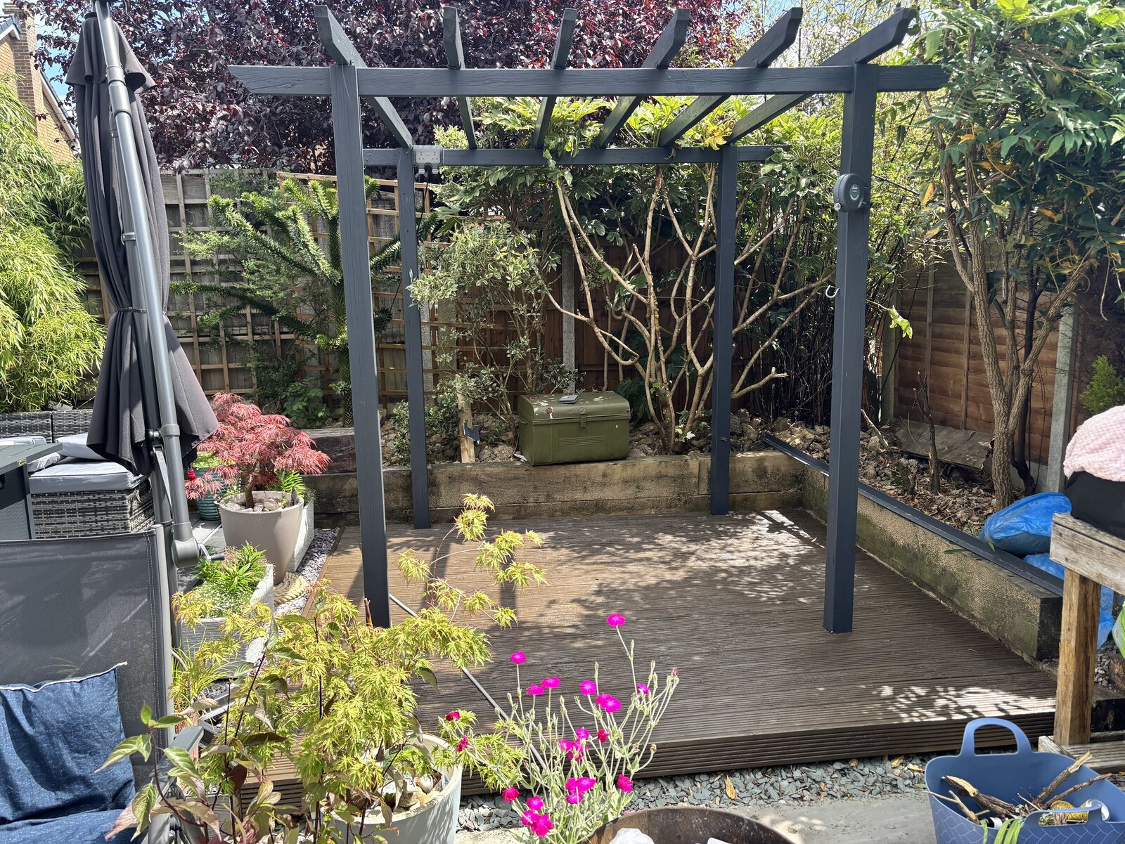

Hiya, making a bar out of our Pergola and looking at roofing options. Do I go with flat clear panels or the corrugated ones, what is the benfit of each please? Are these easy to fit? Size needed is 2.5m squared. Where is a good place that sells them please.

At 2.5m square I'd question the usefulness of them unless you are going to cover 3 of the sides as well, rain in the UK doesn't always fall vertically.
Thanks for replying, I have built wooden walls on 2 sides so far and the front will be half height bar with vertical composite decking with the top half closed off with some flap door type jobbies I have yet to design, not decided on the last open side yet but looking at some tarp solution with eyelets for the winter months, not bothered if the roof is clear or not, probably siding with flat type roofing now so there isn’t the air gaps at the top.

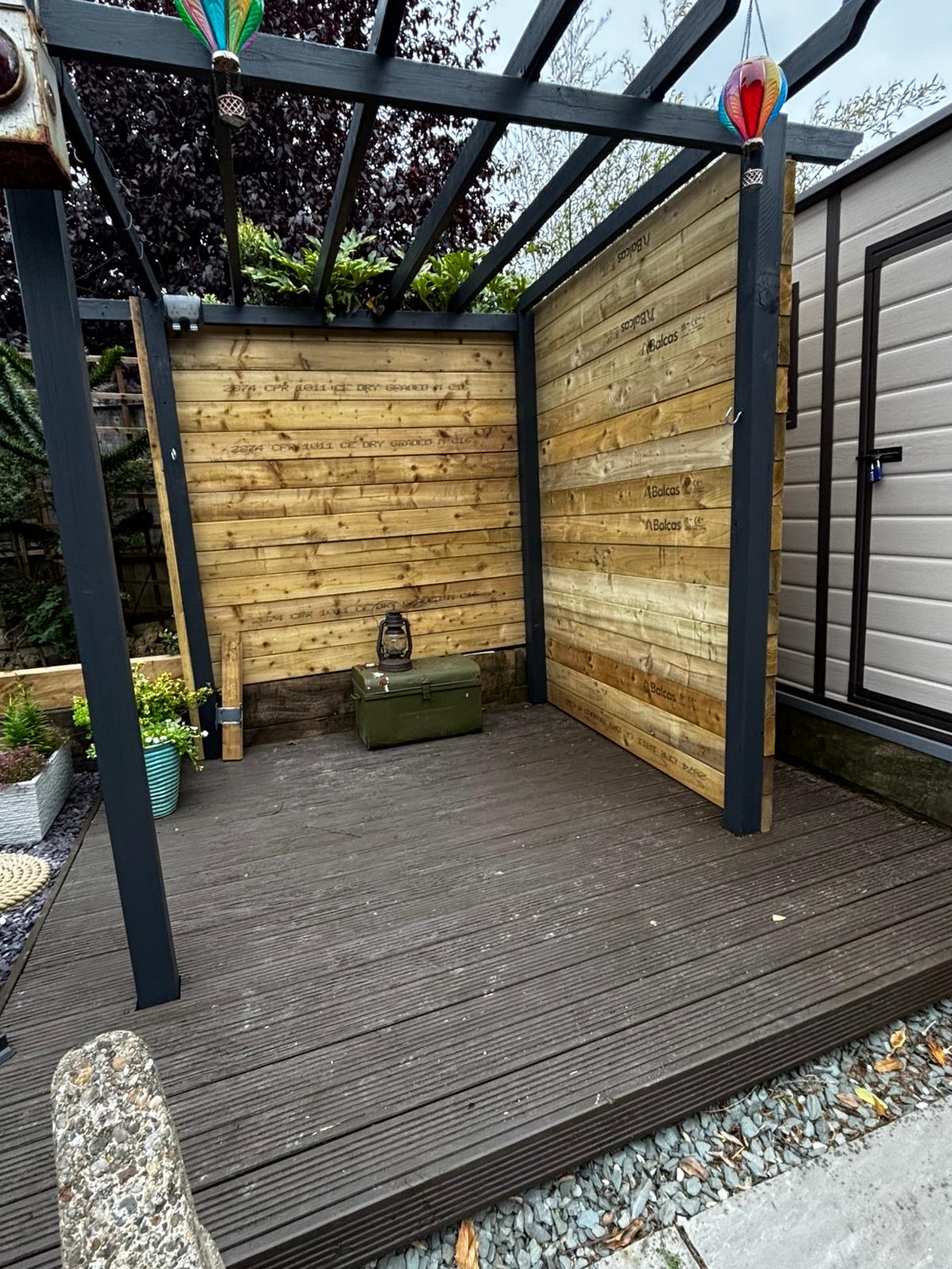

Picture of my progress below, I am in no way a joiner so please take this into account and be kind

Not sure the legs into the ground will stand the test of time as the pergola has been up the best part of 10 years already but I could always saw the legs off at the decking level and get some big lads in to move it in future if needed as the wood is quite heavy now.

I would suggest, box section galv., painted steel sheets, but whatever you use, it will need a fall/slope, for drainage. The joists, would also need to run at right-angles, to the run of the sheets, whichever sheets you decide to use.
The fall, would also need to run from the 'customer side', towards the back of the bar. As other suggest - it will need three sides.
