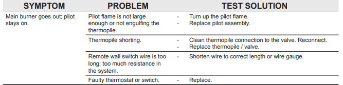

Hi all,
So recently the main burner on my GDS20 Napoleon Gas Stove went out while it was running, but the pilot remained on. I looked up the manual for it and saw the possible causes below, but i have no idea where to start or which issues/solutions would be the most common. Anybody have any ideas where to start? I'm not too well versed with gas stoves.
