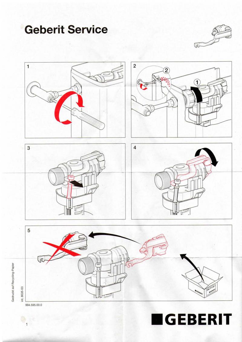

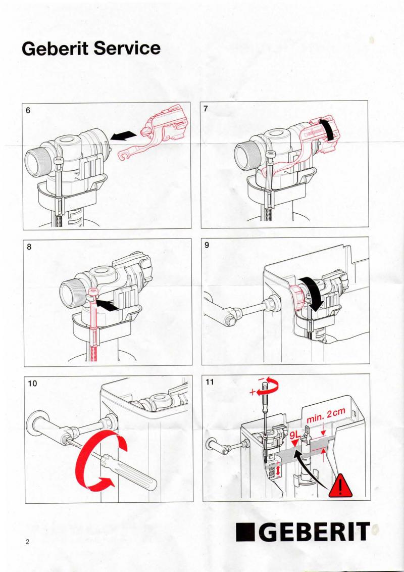

I had the same problem with a Geberit UP320 concealed cistern, traced to a faulty side fill valve diaphragm (part no. 240.771.00.1 - shown on p101 of the Product Guide PDF). The diaphragm had perished after 3 years use; symptoms were a hissing after the cistern had filled, then dripping noises and a trickle of water at the back of the pan.
A replacement (£7 + VAT) from Geberit UK spares (01926 516 807) arrived today and I fitted it in 5 mins. Thanks to the other posters on this thread who helped me save the £70 a plumber would have charged to sort this ****ing annoying fault.
I've scanned the fitting guide in case it's of help to anyone:
