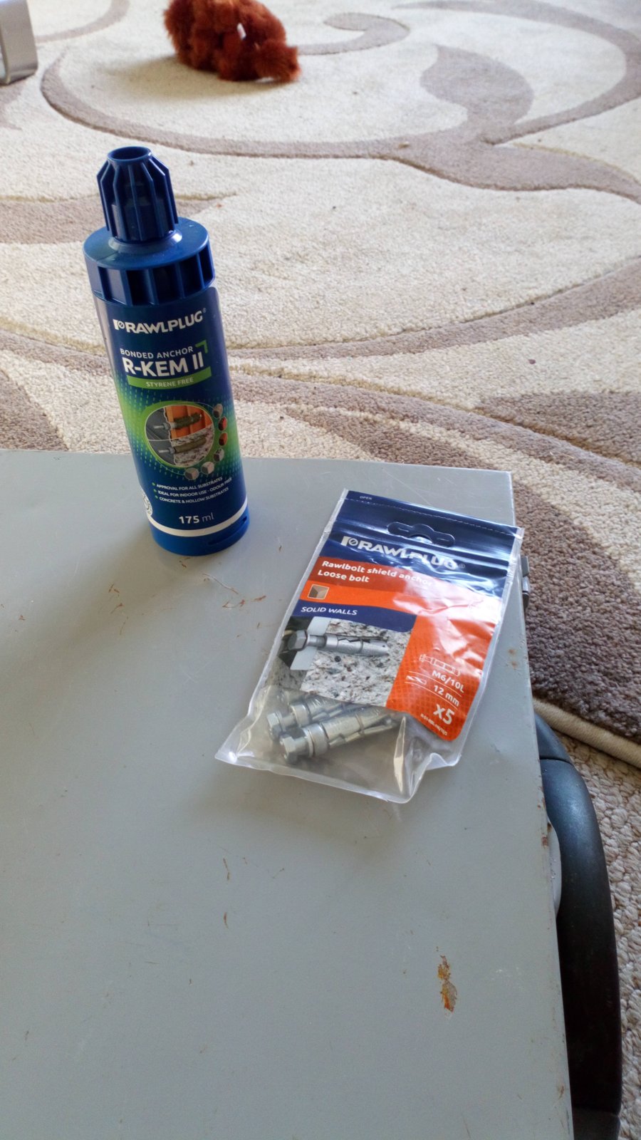

When trying to put a plug into a crumbly wall and it's too crumbly to hold what's the best solution? Some guys in Travis Perkins told me this RKem II is used by lots of builders any experience with it?

Put up Coat hangers with just two fixings. One isn't very solid so suspect it will come out. Considered squinting the k rem II in with a gun then pushing a plug back in

I guess the brickwork is behind the crumbly stuff. 100 Yr old house. Brown plugs aren't good in this stuff. Been reading the reviews on the R kem II seems rock hard, if plug comes out will try it
I general I'd have to agree with the longer screws approach. Resin anchor systems, such as that sold to the OP by his builders merchants are specifically designed to fix threaded rod into walls, not screws. I doubt that they would be any good for screws if only because the nozzle is probably too big to get down a 7mm hole drilled for a brown plug. If going deeper and using a longer screw doesn't work the OP might want to consider an expansive plug such as the Fischer UX or Fischer Duo Power

I see, it's usually used more for things like thunder bolts. Bolts which screw directly into a wall rather than plastic plugs. Wish the Travis Perkins salesperson had told me that!

No. Thunderbolts are designed to anchor into good quality, hard masonry, e.g. stone massive, concrete, medium to hard brick and so forth. They need an accurately drilled hole which needs to be blow out with a blower before they are inserted. We often see them used to anchor scaffolding in place temporarily because they can be easily removed afterwards. They don't require resin and probably wouldn't give a good fix with it as they need a tight hole (so you aren't going to get the bolt seated after you've put resin down the hole) and if you drill a bigger hole the Thunderbolts have insufficient thread to get the best pull-out resistance.
As to Travis-Perkins (and for that matter builders merchants in general), I tend to find that caveat emptor is the order of the day. When you think about it you are asking someone for advice who may never actually have used a lot of this stuff in anger and therefore their practical input as to what's best can be, to be charitable, zero. I also find that the younger they are, the more likely they are to try to sell you anything (on the other hand some of the older guys are actually ex-tradies and can be very knowledgeable)
Resins on the other hand are specifically designed to be used with high tensile coarse threaded steel rod (or better yet purpose-made high tensile studs which have guaranteed strengths which can be included in structural calculations - threaded rod doesn't have such data available and so shouldn't be used for structural works such as fixing load-bearing ledgers to walls). These rods have nice deep, coarse threads which give a lot of surface area as well as something to bite into the cured resin to resist pull-out. All of this is why the big suppliers like Rawl, Spit, Hilti, etc actually supply purpose-made threaded studs for use with their resins (BTW they are not exclusive systems, so Rawl bolts woth with Fischer resins work with Hlti bolts, etc). BTW resin studs are also a lot cheaper than Thunderbolts, at least when bought by the box

I think you're right. Drilled not on hammer mode and pushed through easily to nothing so obviously not going into brick. If this is so don't think John's idea will work?
