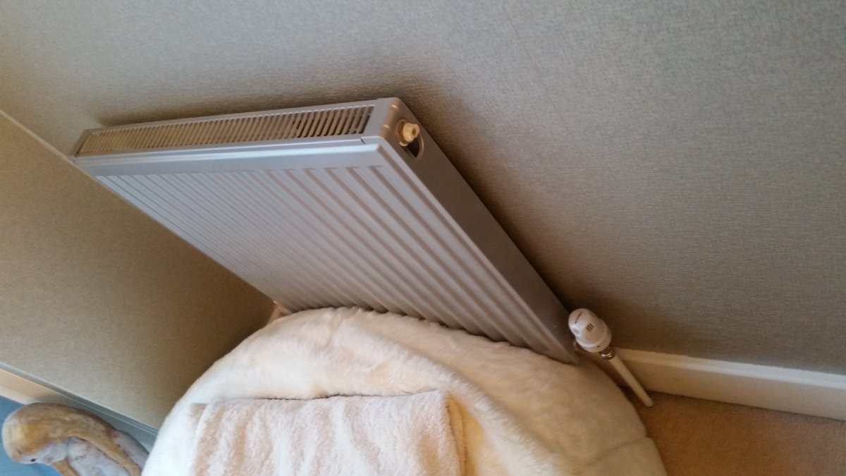

Got to put a shelf above this radiator. How u get a good fixing if walls all crumbly? I was just going to drill in 7mm a bit longer than plug and push in brown plug. What if it doesn't stick or go in?
The brackets I have 2 holes at top of shelf bracket and 1 at bottom. If I don't screw in bottom hole (if it's pushed down back of radiator ) will the top 2 hold it?

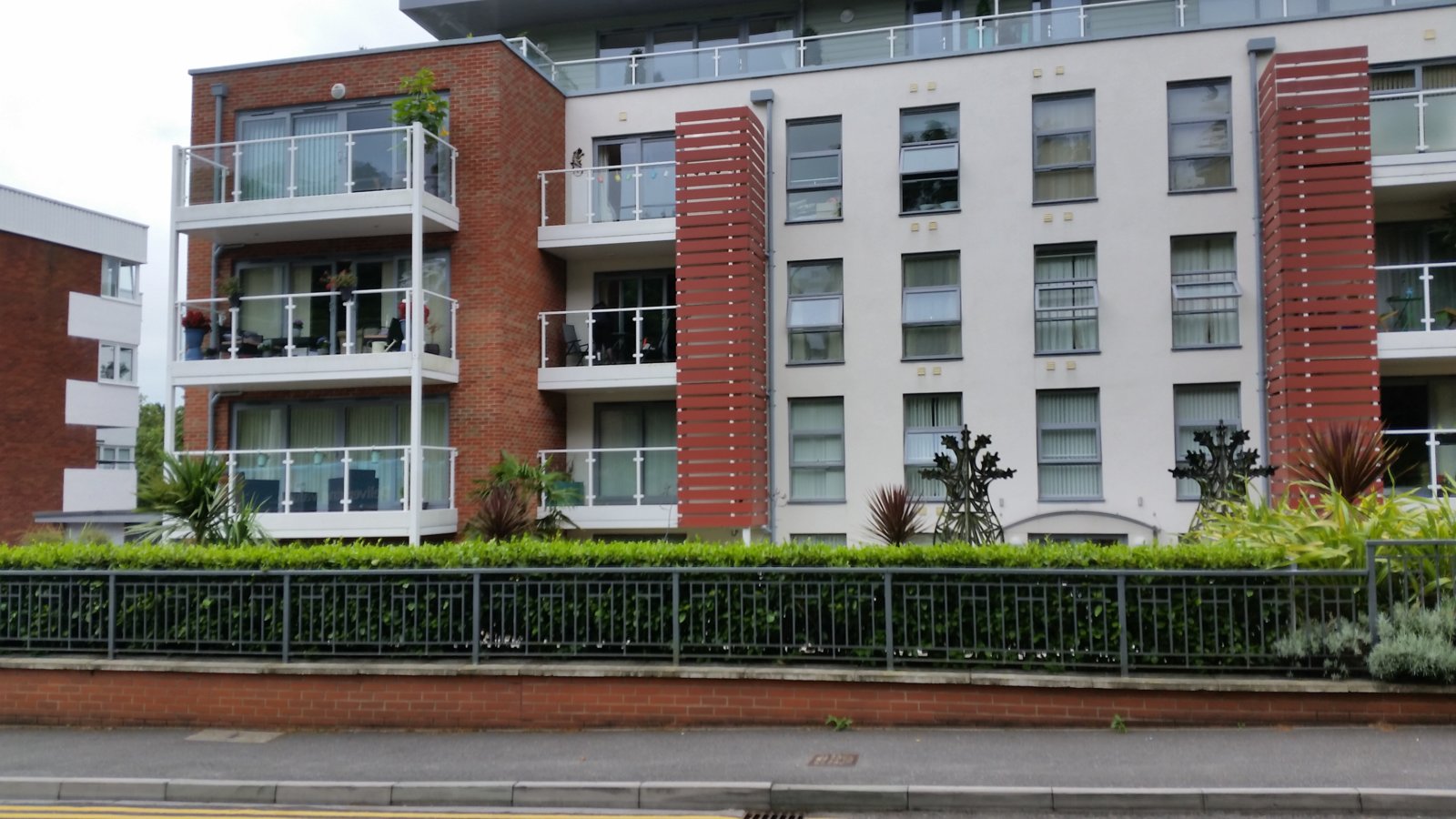

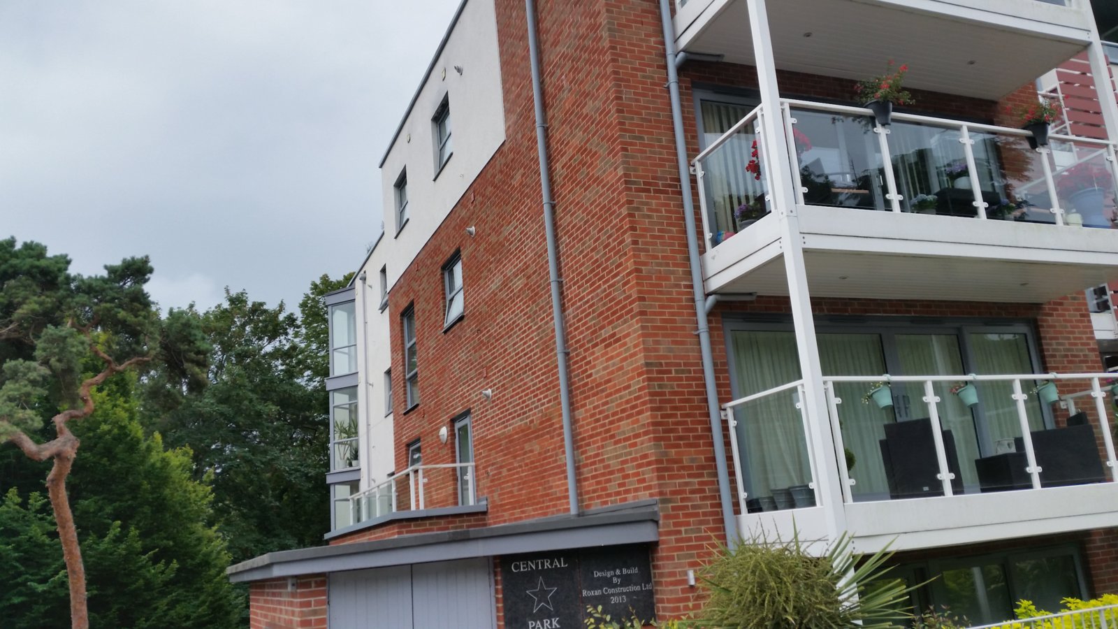

This is the building I need to put fixing's into internal walls.
Well it's a modern building so I'd say you're probably drilling into blockwork or plasterboard. Nothing exotic.
