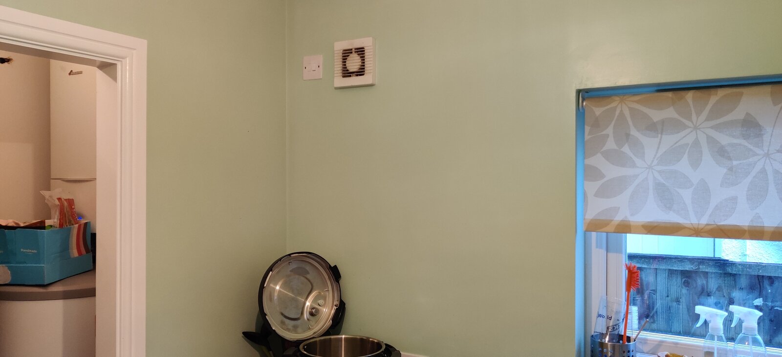

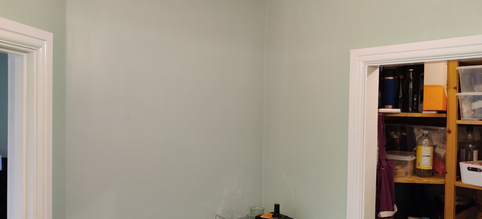

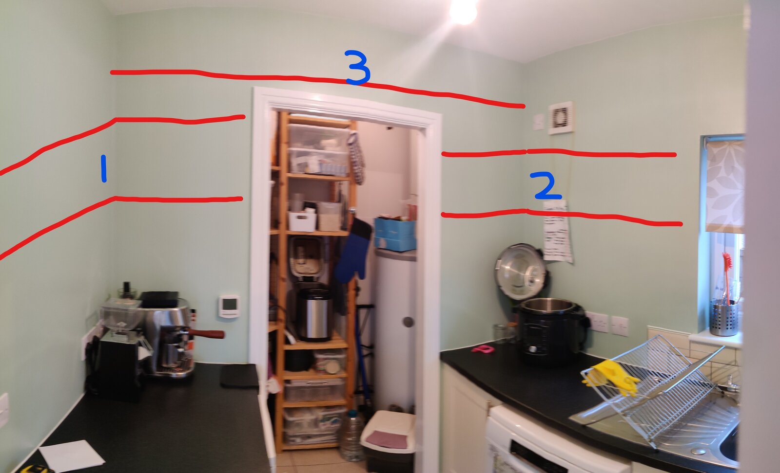

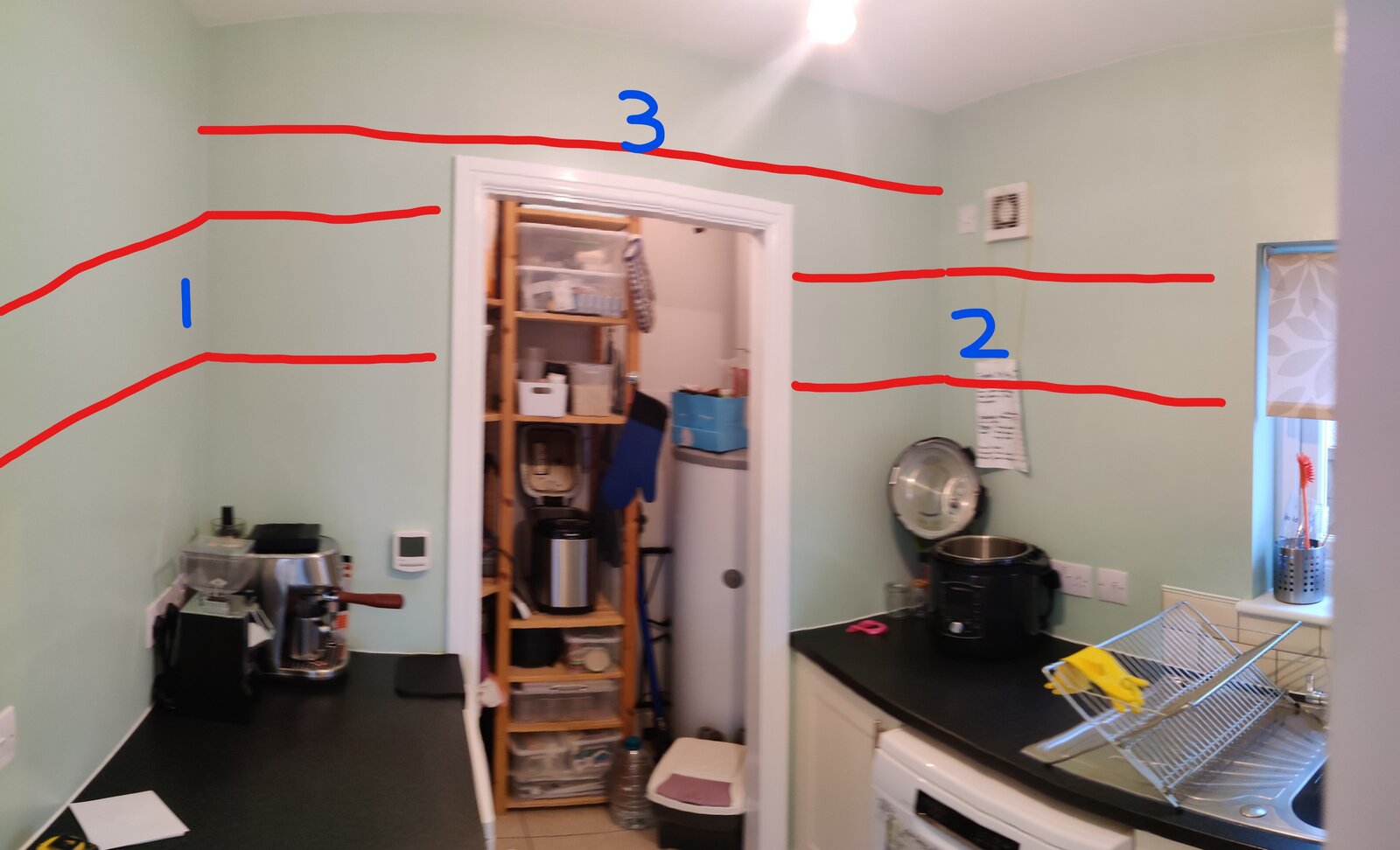

Hi,
I'm planning on installing 24mm thick X 800mm long X 300mm deep shelves in my utility room (https://www.ikea.com/gb/en/p/tranhult-shelf-white-stained-aspen-60454899/) and have some questions about fixing.

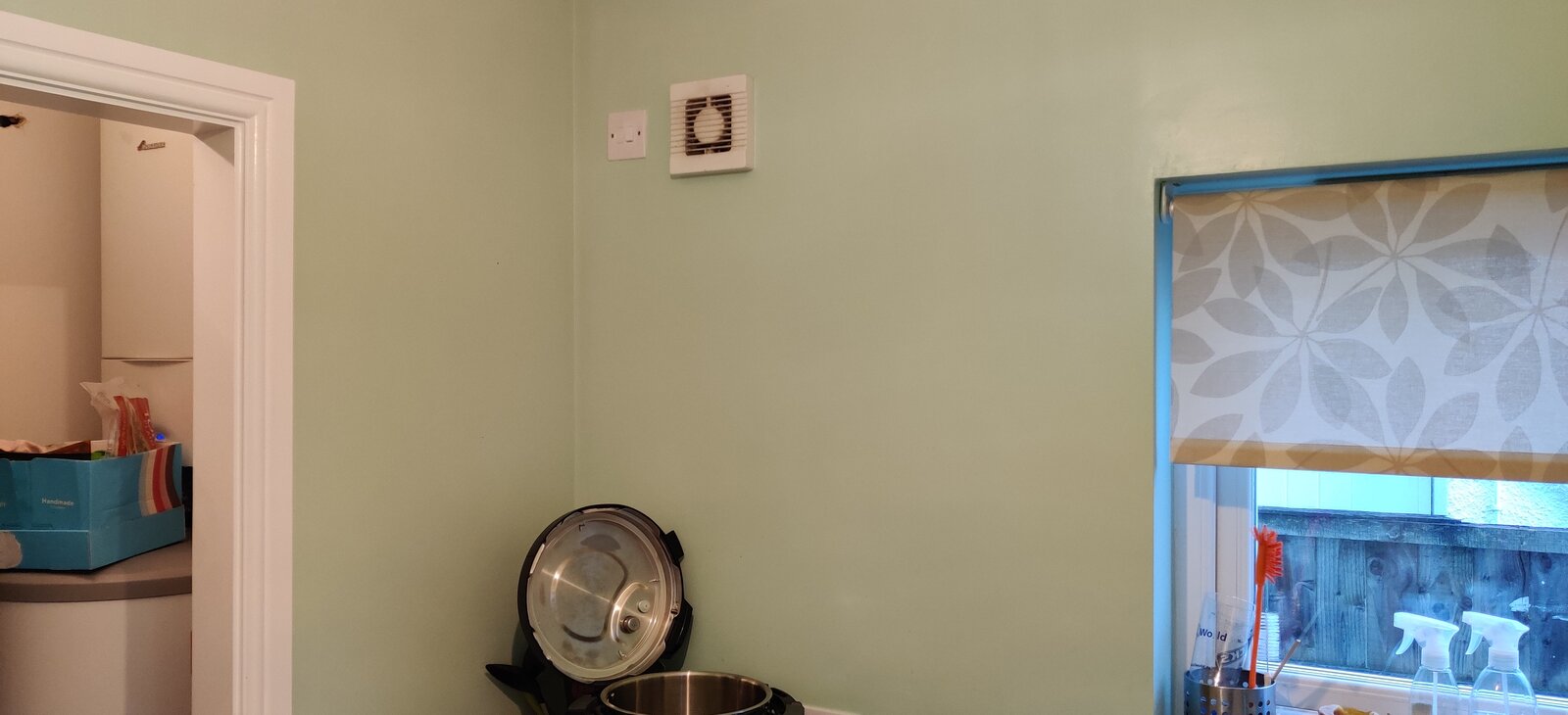

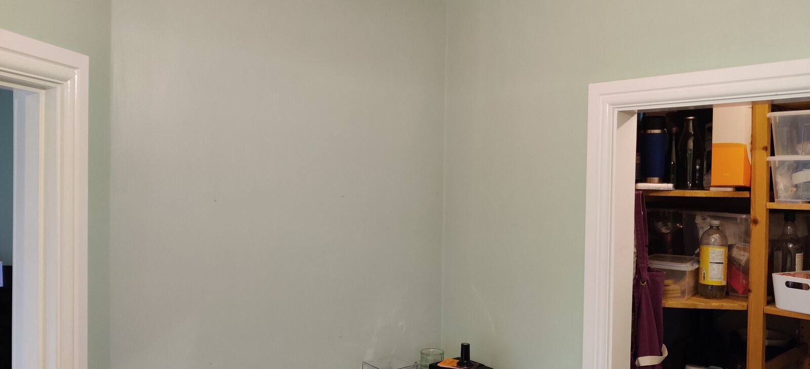

The long and short wall for the left shelves (1) are newly installed plasterboard with the right side (2) where as on the right side the short end is newly installed plasterboard with the long end plasterboard on top of external brick wall (1920s) house so dot and dab I think. I'm also planning on putting a long shelf above the door frame (3)
See the attached photo of the room and proposed plan.
Originally I was going to put an L-shaped shelf on the wall, but given that the shelf is 300mm deep, the short end of the L would only be about 450mm so not a huge increase in shelf space but quite a bit more work.
We're planning on putting some small appliances spice jars, some books, so lets say it should be capable of a 20kg load and we'd keep the weight towards the back and corner of the shelf.
I would prefer to install on battens as brackets are a bit unsightly. A carpenter came around to quote was planning on putting on battens so I think that should be fine.
My questions are:
1. Are battens running along the long and short edge fixed to the wall sufficient to hold this up? For the long shelf above the door way battens will be best as I can do them in a "U" shape against the side wall, almost like an alcove. Besides I can't install brackets where the door frame is.
2. Which would be stronger? Battens or brackets: https://www.screwfix.com/p/hi-load-bracket-147kg-white-200-x-200mm-10-pack/30268
3. When fixing the battens, I know where the joists are, so is it better to screw into the timber studs or use plasterboard fixing, something like https://www.gripitfixings.co.uk/
4. If screwing into the joists, what size screws should I use? Given I'm screwing into timber I assume I don't need any plugs.
5. What size battens should I use? 18mm X 44mm?
https://www.wickes.co.uk/Wickes-Whitewood-PSE-Timber---18mm-x-44mm-x-1-8m/p/9000036442
6. If I wanted to do an L shaped shelf, would I need to cut the shelf at a 45 degree angle and glue together? Anything else I need to consider?
7. For fixing to the right wall with plasterboard and brick behind, what fixings should I use? 50mm screw with plug having drilled the hole first?

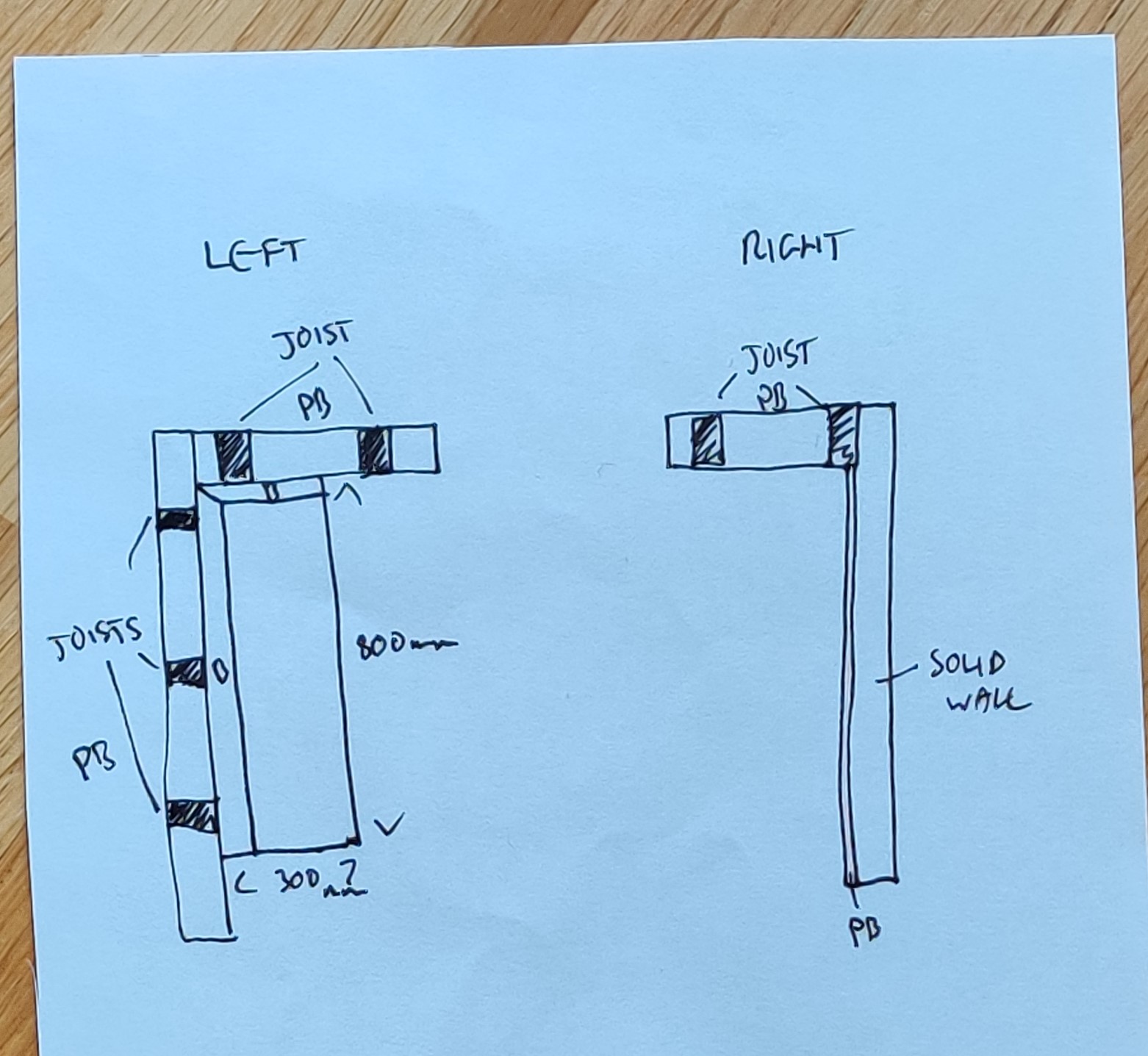

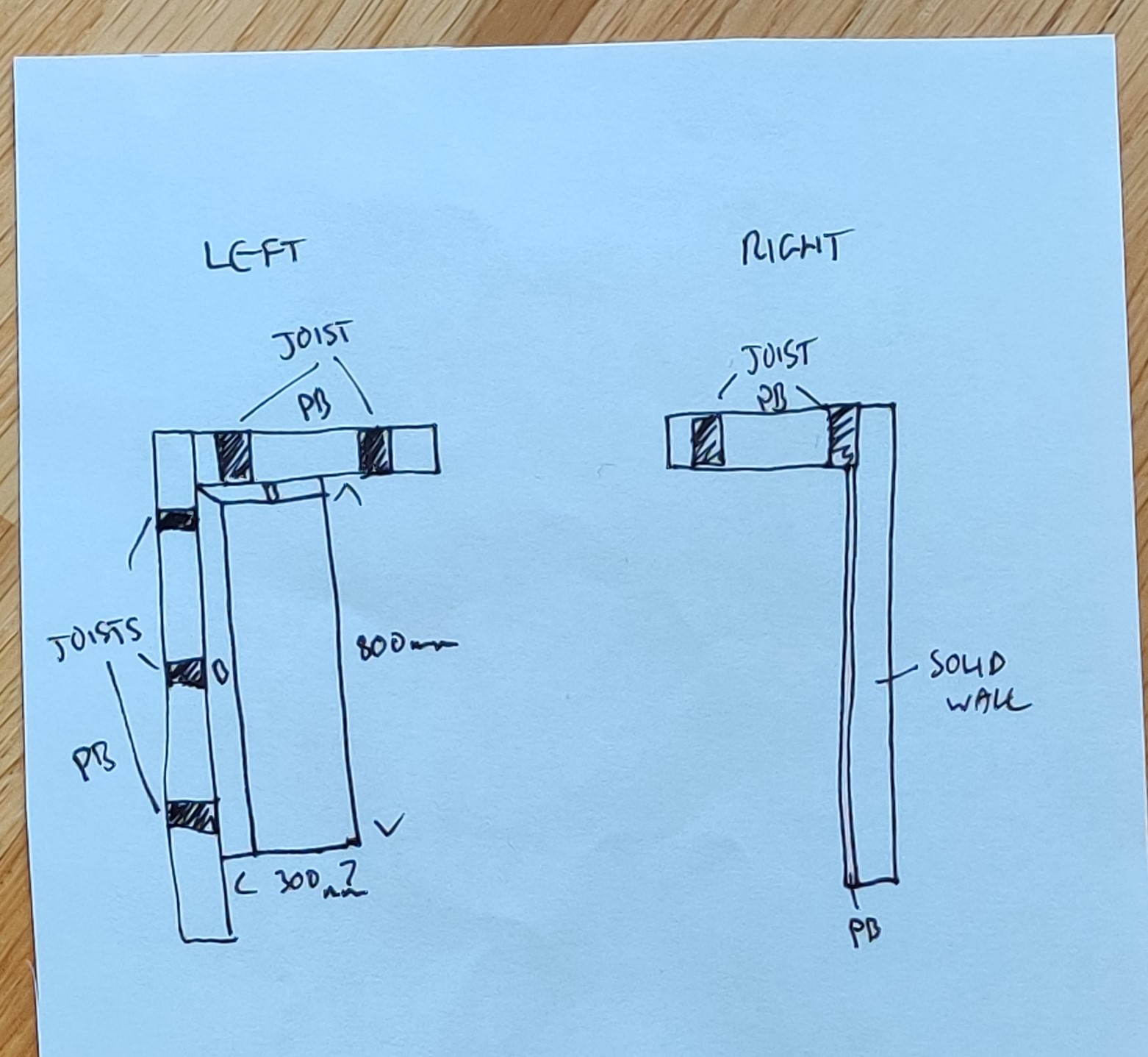

Sketch:
PB = Plasterboard
Hatched boxes are vertical studs
Updated Sketch = original L shaped design.
Personally I'd want two battens and single end brackets on those L-shaped shelves. Otherwise to risk them being overloaded and failing (if it is anything like our kitchen!)

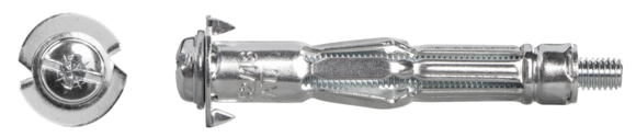

Plasterboard fixings will never carry the same weight as screws into studs, even screws into metal studs. That said I put ups Spur rails in my study/office which are 6ft long and on 400mm centres - they carry part of my tool kit, plus books, etc so over a 7ft length of wall there must be 300kg plus hung on the wall. Half the fixings into the PB (12.5mm thick) are the "umbrella" type (Rawlplug SN Interset, Fischer, etc), set with the correct setting tool. Used them for years in shopfitting and never had issues, unlike almost every other fixing I tried
You go straight in, no plugs, Use the largest diameter screw you can get through the holes in the brackets (4.5 or 4.0mm diameter) and use 60 to 70mm screws - you have to go through the thickness of the bracket, plus 12mm PB before you reach the timber
Brown plugs, 7mm hole, 5.0 (or maybe 4.5) x 70mm screws

I think I'll go with the battens and a single L shaped bracket underneath at each end.
I've bought a Bosch wire detector so will make sure to check before hand.
