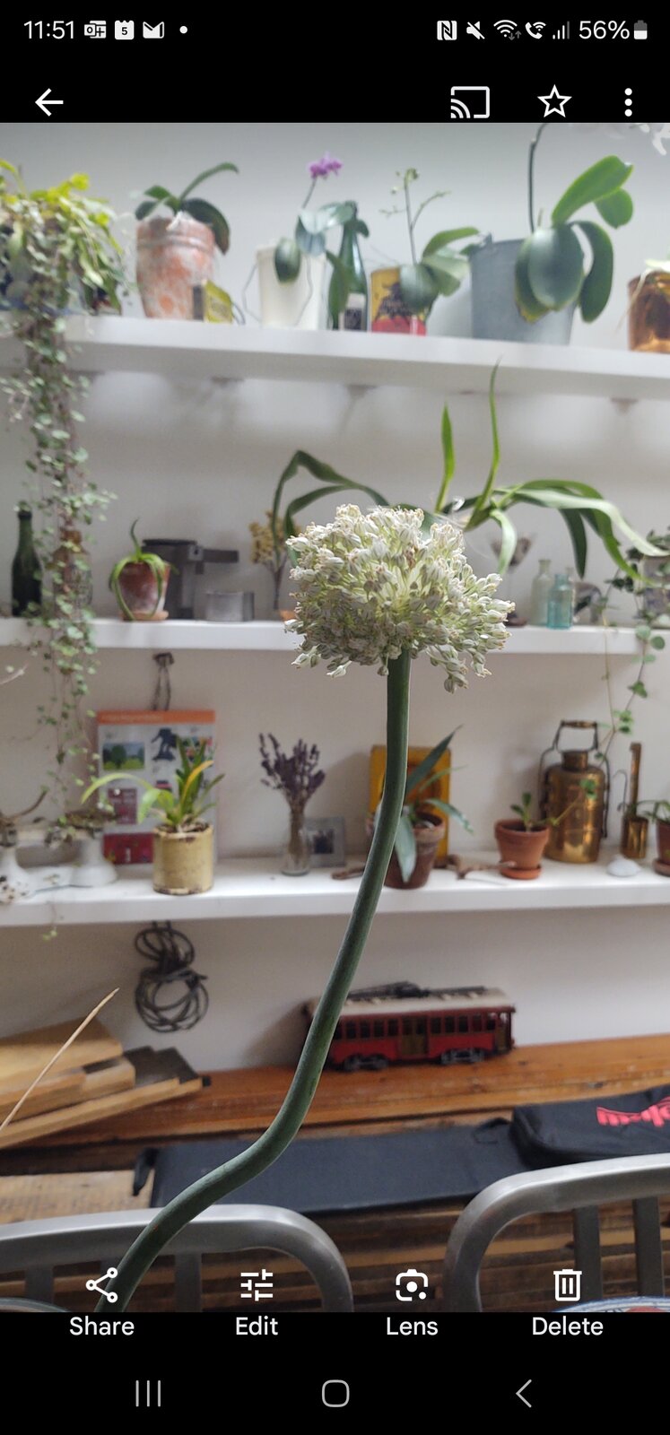

I currently have these shelves for plants and nicknaks which are made from solid pine. The shelved are attached to the wall using 5 Hafale concealed shelf brackets per shelf. The wood is a bit twisted and shelves aren't quite wide enough so I'd like to rebuild the shelves using a 4x2 batten and ply. Will pine 4x2s (one long peice at the wall plus 5 perpendiculat short peices attached with pochetholes and screws) and 8 mm ply be strong enough/the recomended plan? I plan to paint it white.

How long are the shelves?
If you're going to keep plants on them i'd prefer to see at least half an inch thickness in the wood.
There are 3 shelves, length vary. They're around 2m long. When you say at least half an inch thickness in the wood, are you referring to the plywood?
Given the length, i'd go for an inch. It's as good as a mile if you're putting plants on it.
