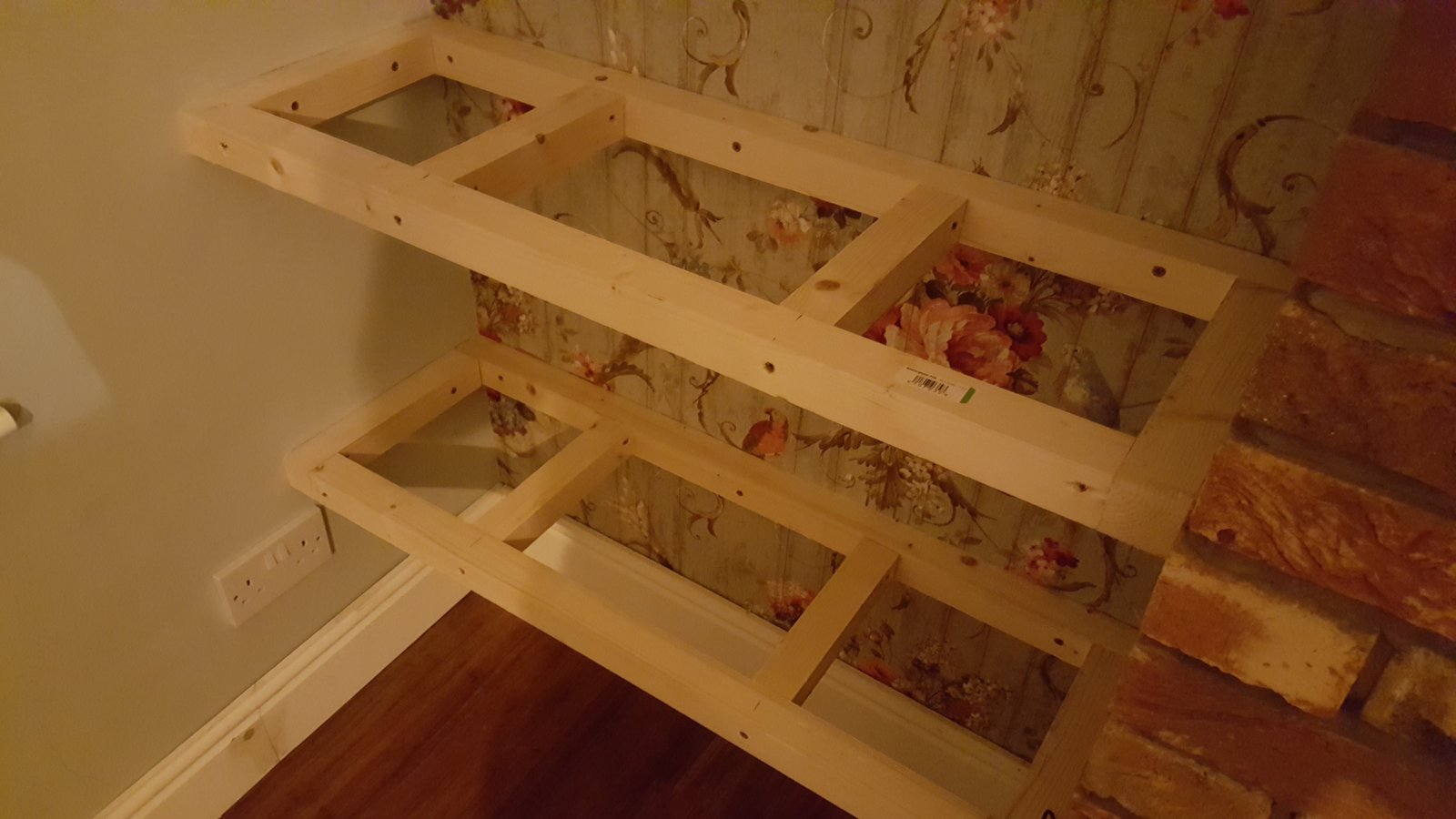

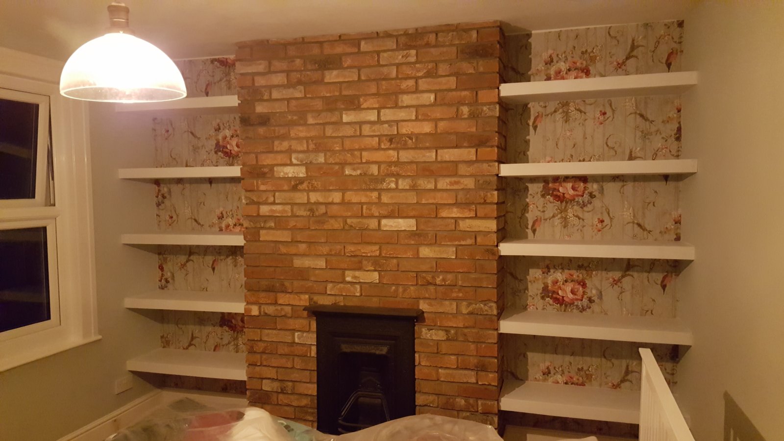

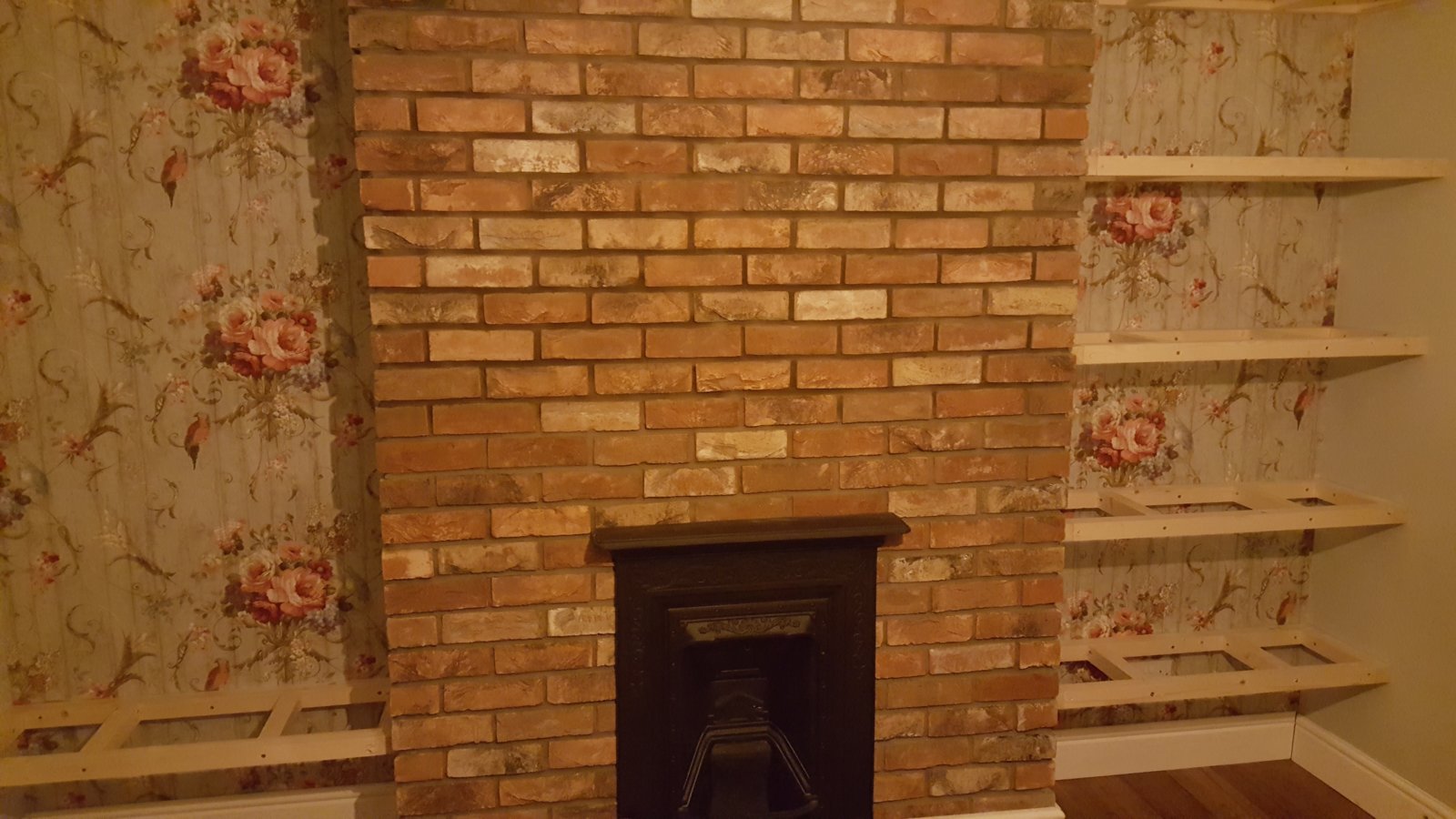

I put wooden battens on the walls and chimney breast, then one on the front to build a frame strengthened with wooden noggins. I put 3/8" ply on top (MDF would also work well), with thin ply on the bottom. I simply used a strip of timber on the front to finish and painted in primer and white paint.
This is how our shelves were made. They look fine and are nice and strong and just need painting. Here are some pics.

Exactly how I did mine! I've got an early '80s Technics amp, turntable, cassette deck and EQ on mine and they're still standing. Accomplished!
