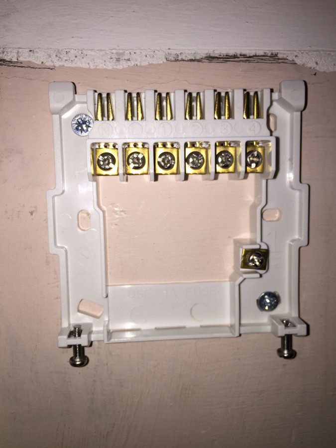

hi everyone - please help!
I've just purchased a hive active heating thermostat system. I'm trying to wire it into my Worcester Bosch Greenstar 30cdi but am very confused!
Can anyone provide some instructions or even a picture of how I wire this into the hub unit? I've taken the boiler apart and was supris d to see so many wires etc which don't immediately relate to the installation instructions... I'm a bit of a novice (although sensible) so basic instructions would be greatly appreciated. Thank you in advance and happy Christmas!
Boiler L to Hive L
Boiler N to Hive N
Boiler Ls to Hive 1
Boiler LR to Hive Heating On
Thank you so much!
Could I also ask if I just disconnect the 8 pin plug connecting the existing Worcester thermostat?
Lastly, do I just use standard 3 core plus earth to connect boiler to the hive receiver unit?
Once again many thanks
