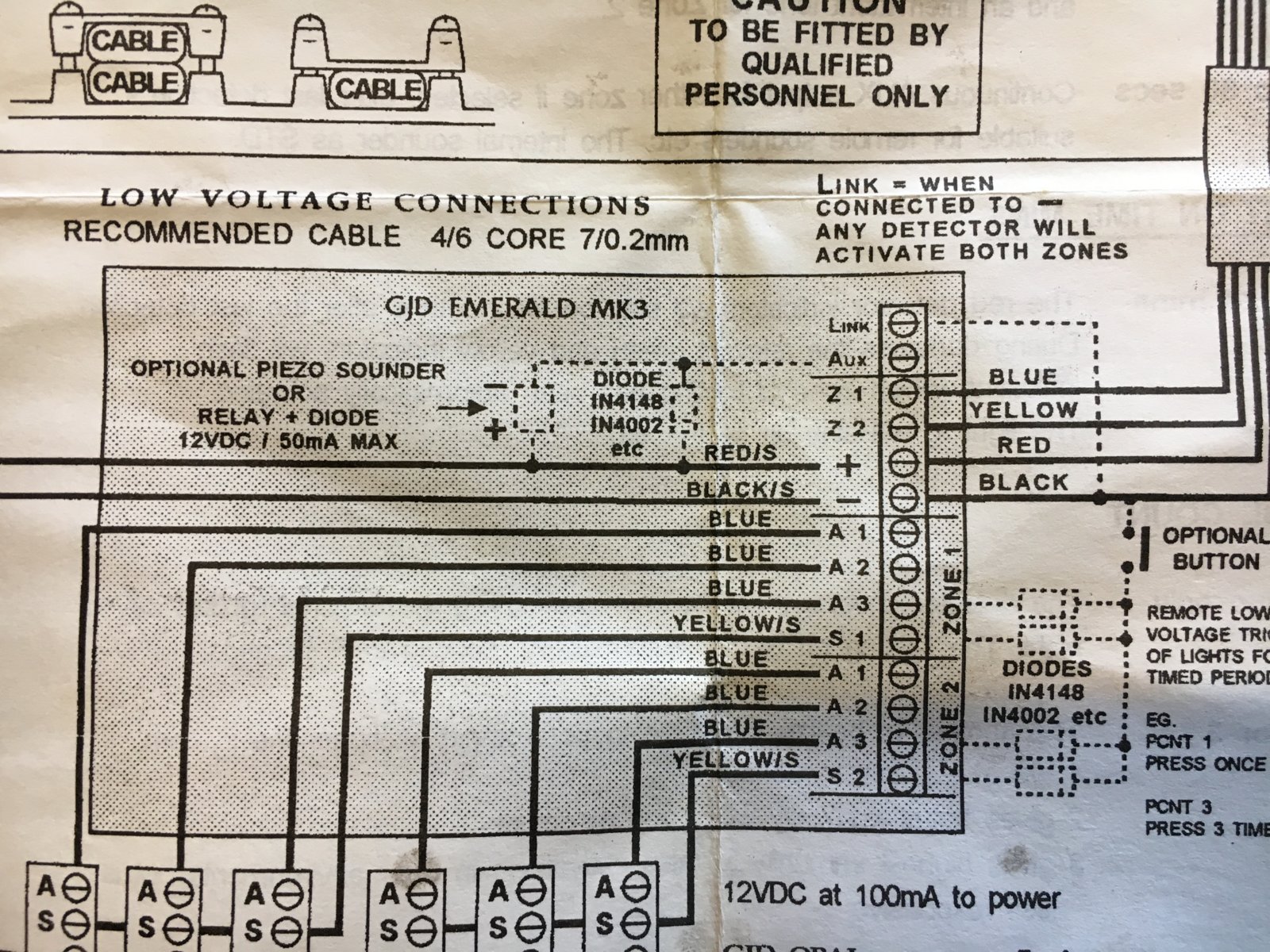

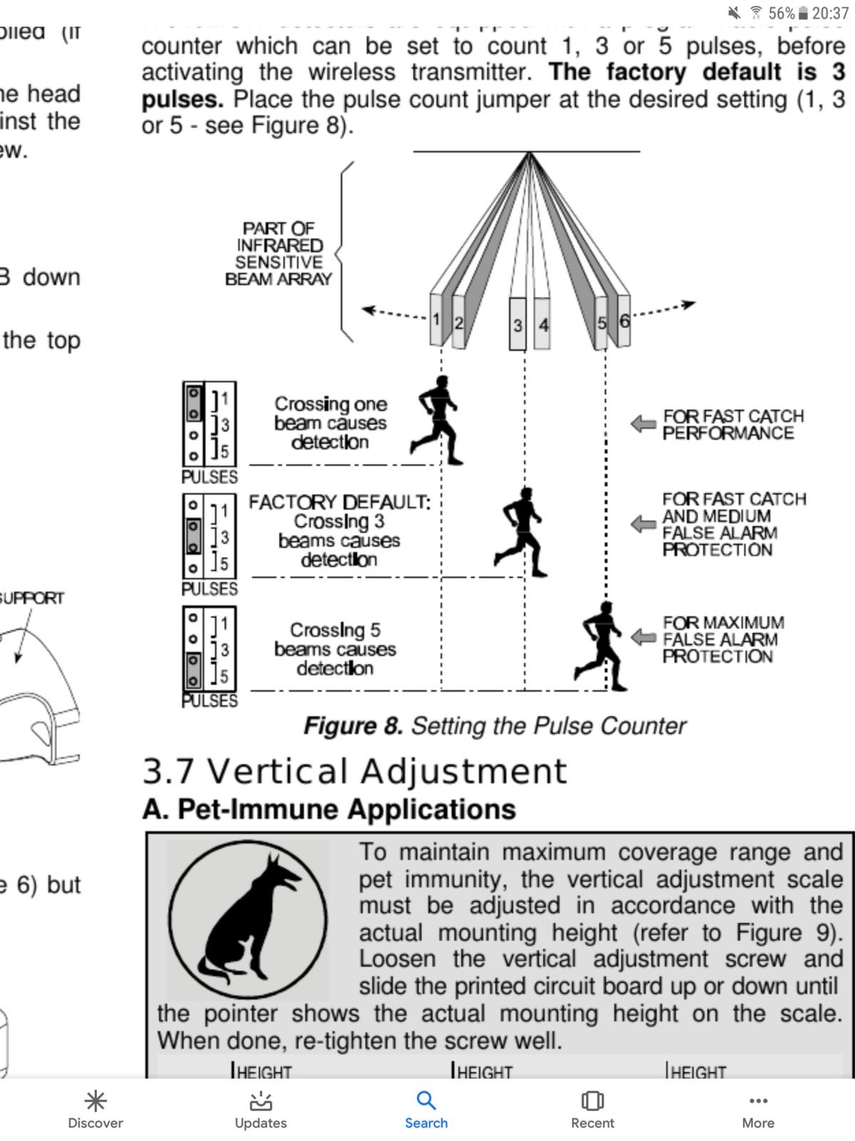

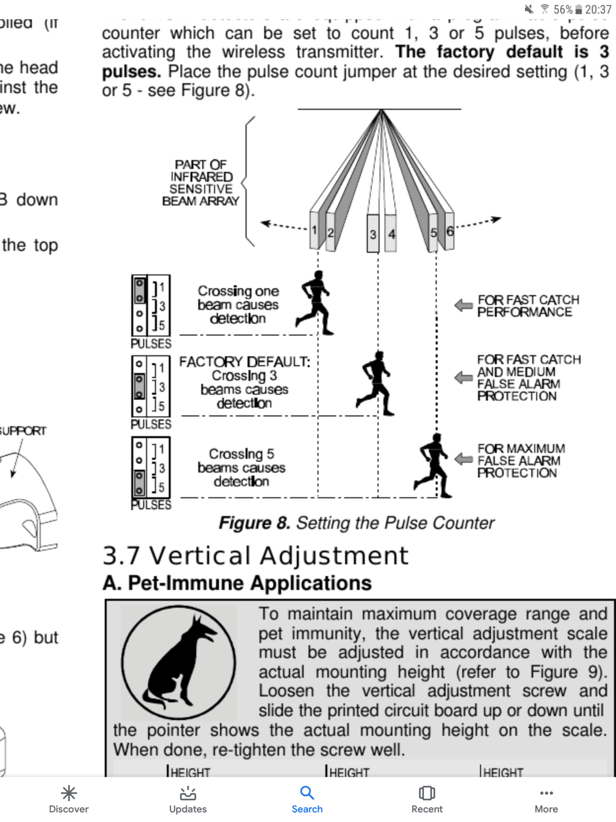

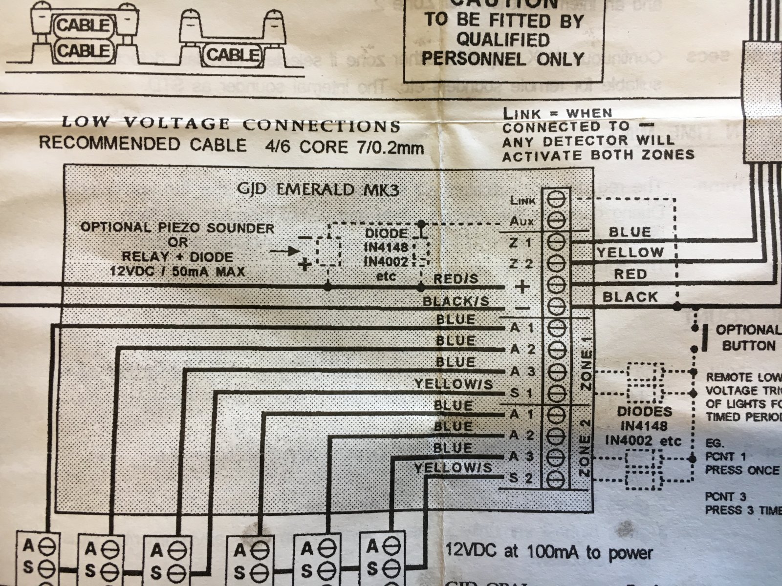

Thanks for reply. I'm after a system that will beep on inside and out when someone is on the drive. Also as the drive is only 10m long can I stop false alarms from people walking on the pavement? Plus one led flood .
Or use the aux output to trigger a sounder ....50ma max

should i get an gjd mini or opal xl. My drive is only small. GJD Elite? Im a bit confused by all these.
It's down to what you want the system to do ?
If you want a notification buzz inside when someone is on the drive then the opal head is fine.
If you want a sound generated outside then elite head.This depends on wiring for the sounder.

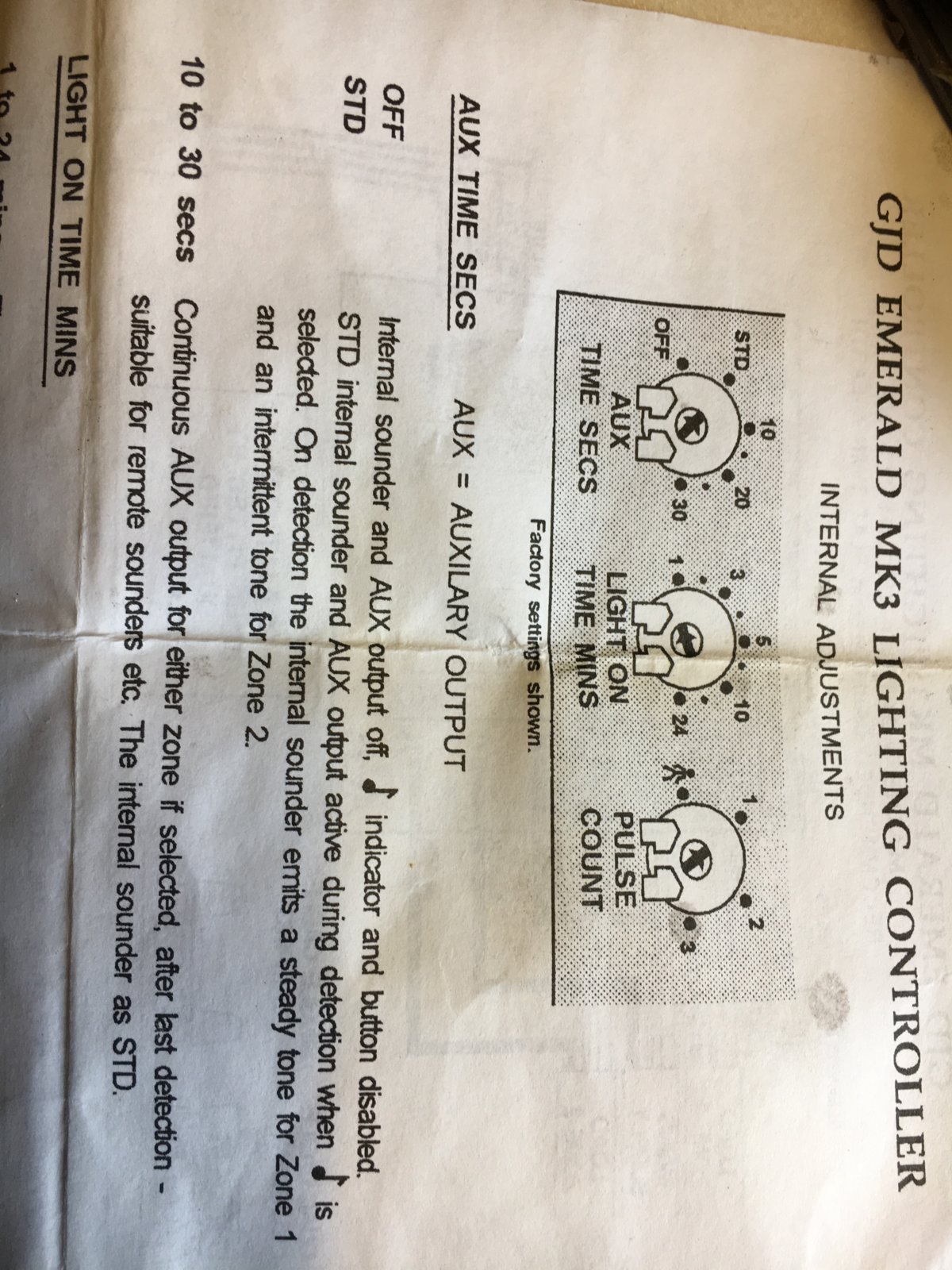

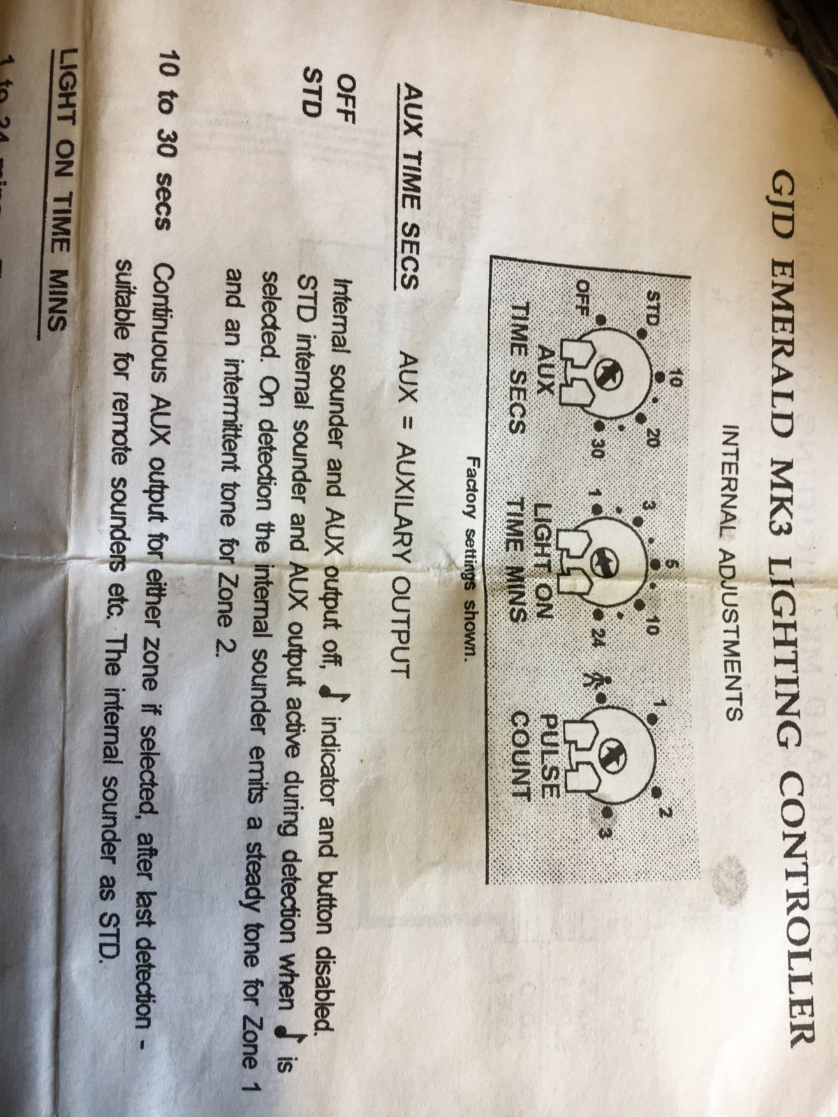

So just to confirm does the elite head beep from the unit? I want intruders to know they are being monitored on the drive.
None of the heads sound out side when the pir is triggered. The control keypad had a bleep button mode. If this mode is turned on a low pitch sound is generated when the opal head is triggered. This works during daylight and at night ,turns light on at night.
If you require a sound out side then you will have to wire a buzzer into the elite head,this my require diodes and relay ,dependant on size of buzzer max 50 mA.
