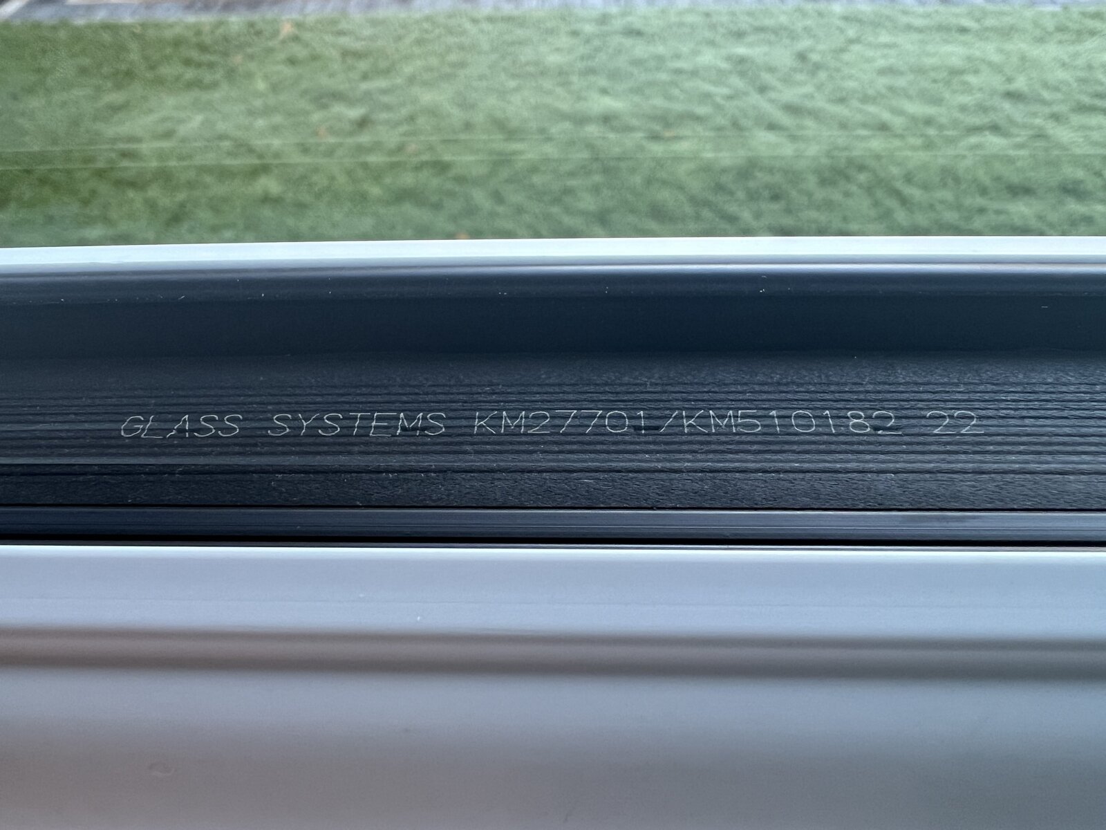

Hi. I understand from another thread that it's possible to tell the energy rating of a glazing panel from the code printing on the spacer bar. I have attached my code, if someone could advise please.
Thank you.
Someone has been lieing on the other thread lol. All that information on that bar tells you is the sealed unit manufacturer ( glass systems) and then the licence number(s) of the manufacturer and the date the spacer bar was stamped with that information.
However, taking a guess at the 'make up' of the unit being 4mm diamant glass/ 20 warm edge spacer + Argon gas / 4mm planitherm glass, then your u value wou ld be 1.2
NO sealed unit , without a frame , has an energy rating officially BUT the spec i gave above would be that that i would expect to see in an A rated frame , and when ordering A rated sealed unit I would assume that specification
