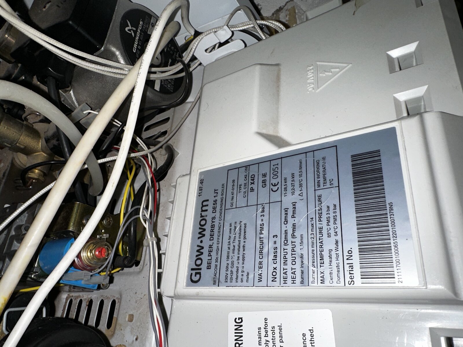

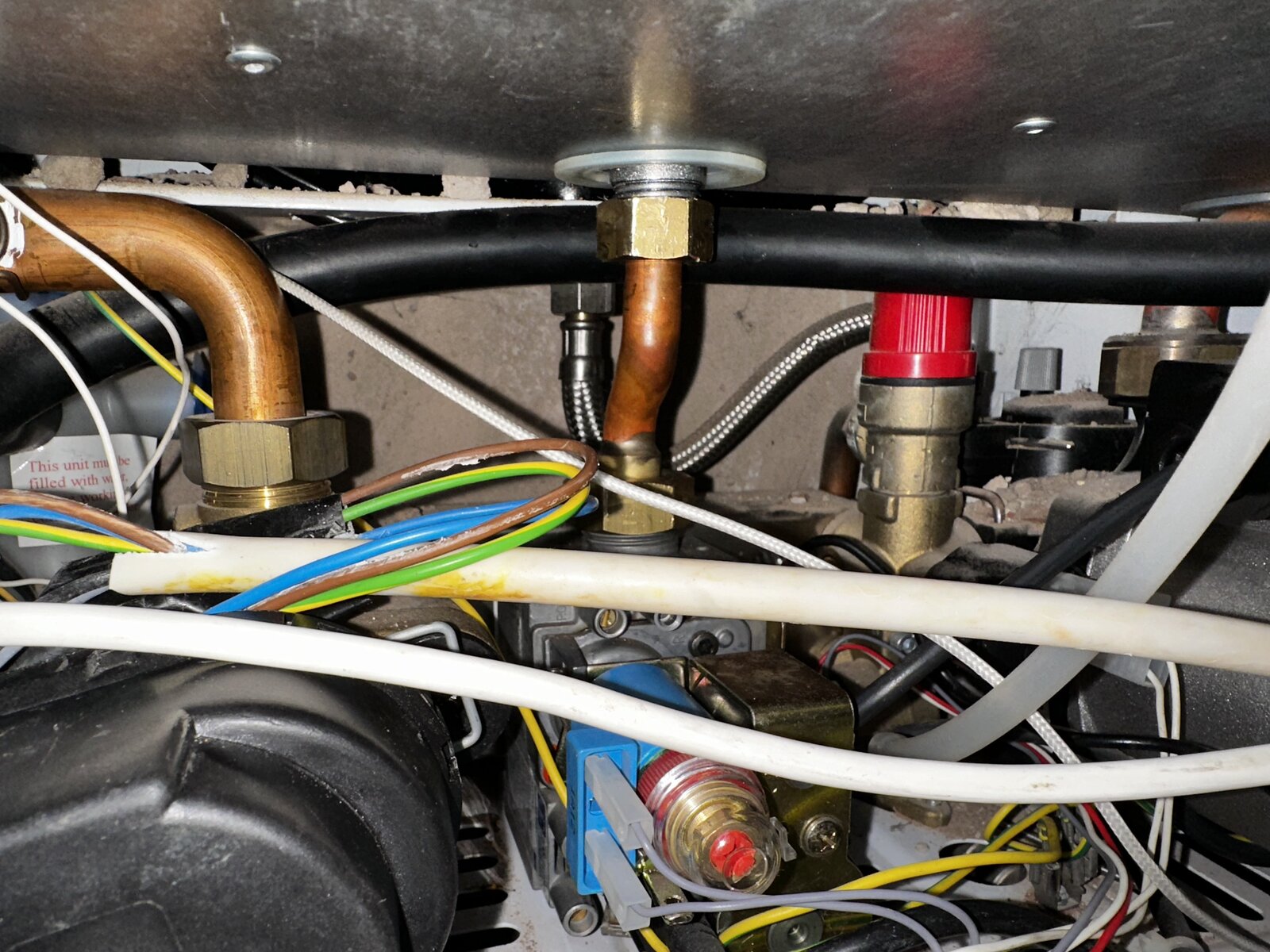

Hi mate,
Did you get anywhere with your boiler, I have the exact same issue I can’t seem to resolve it,
Please help!!!
