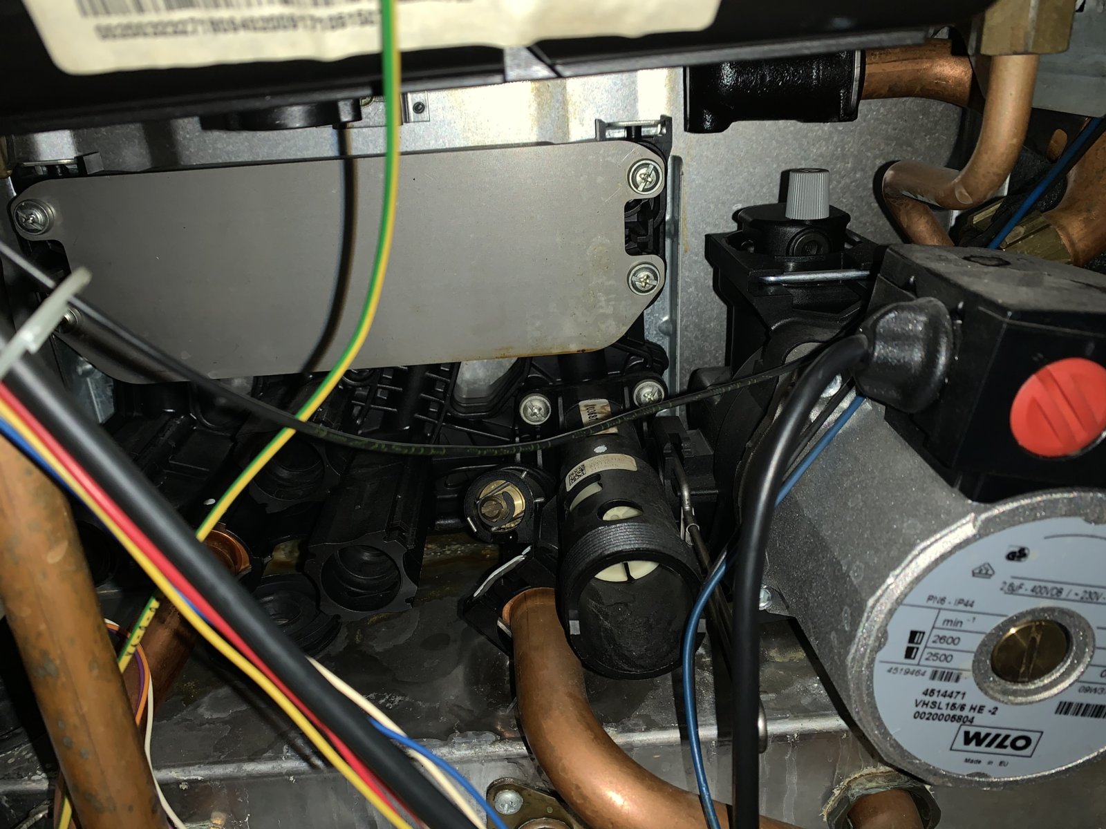

Do you have “state” codes? Or status? Do you have a zone valve(s) or 3 port valve?
Where will I find the state codes ? think its a 3 port please see photo
Looks a bit like a diverter valve. Codes would be on display on front of boiler. Not sure if the cover is supposed to be removed by a non gas engineer on this model though.

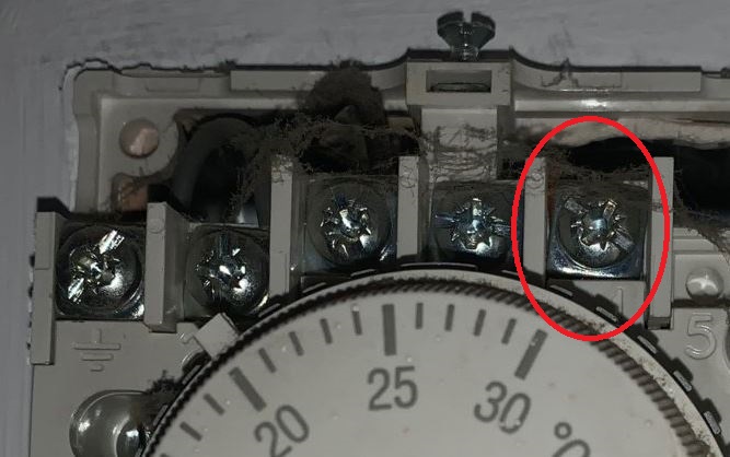

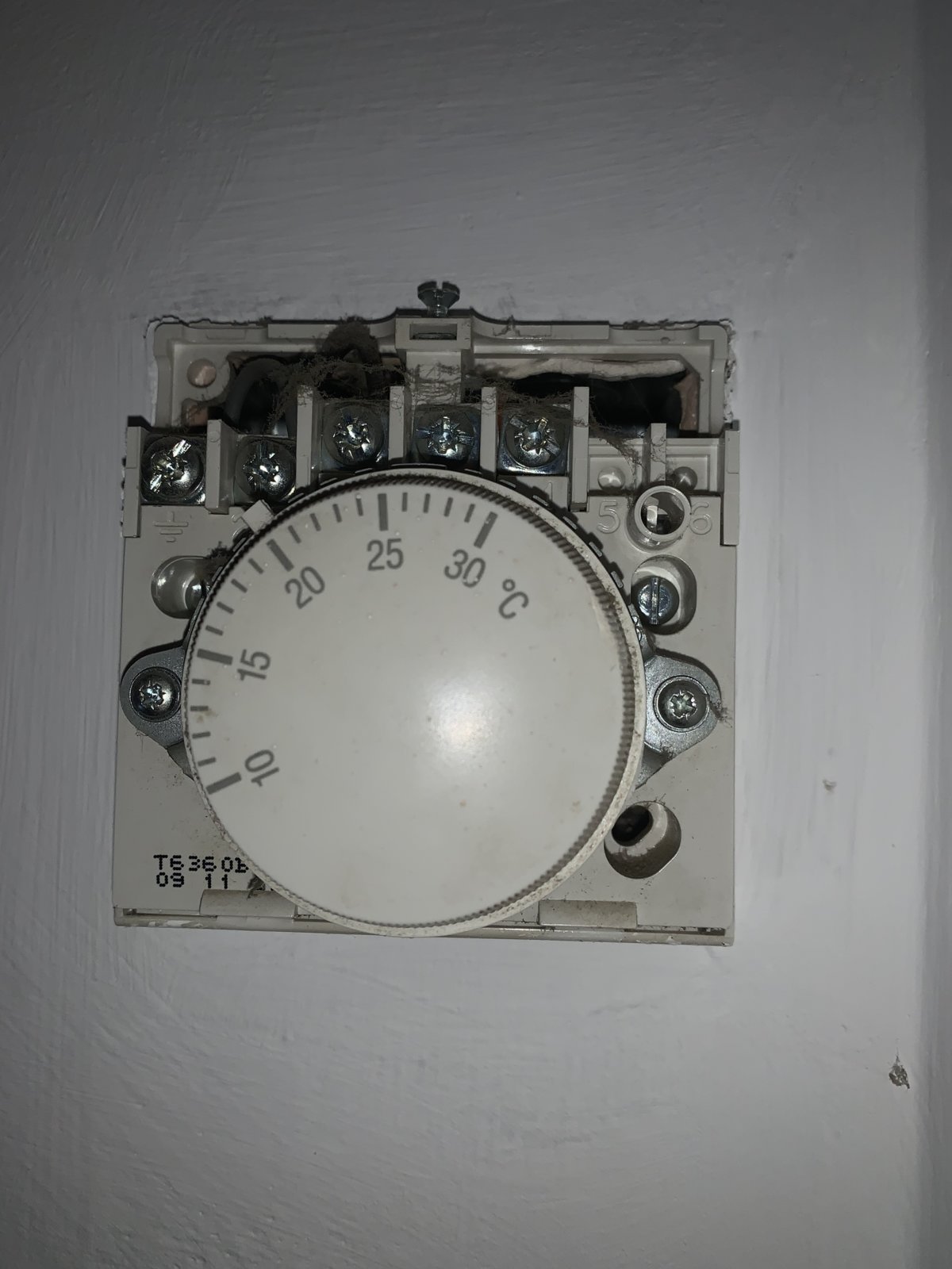

Ok, so that’s usually an indication of the thermostat not calling. Which thermostat do you have?
Think its a T6360B1028

You could try testing the thermostat if you have a voltage tester or multimeter? Likely the diverter or zone valveif you have One?
A bit difficult to see properly due to the cobwebs, but is there actually a wire connected to the live supply to the thermostat? (terminal 1) I can't see anything in there.
If there is a wire in terminal 1, and you were to insert a wire to link terminals 1 and 3 together, that by-passes the thermostat and if the heating comes on then, the thermostat is faulty.
