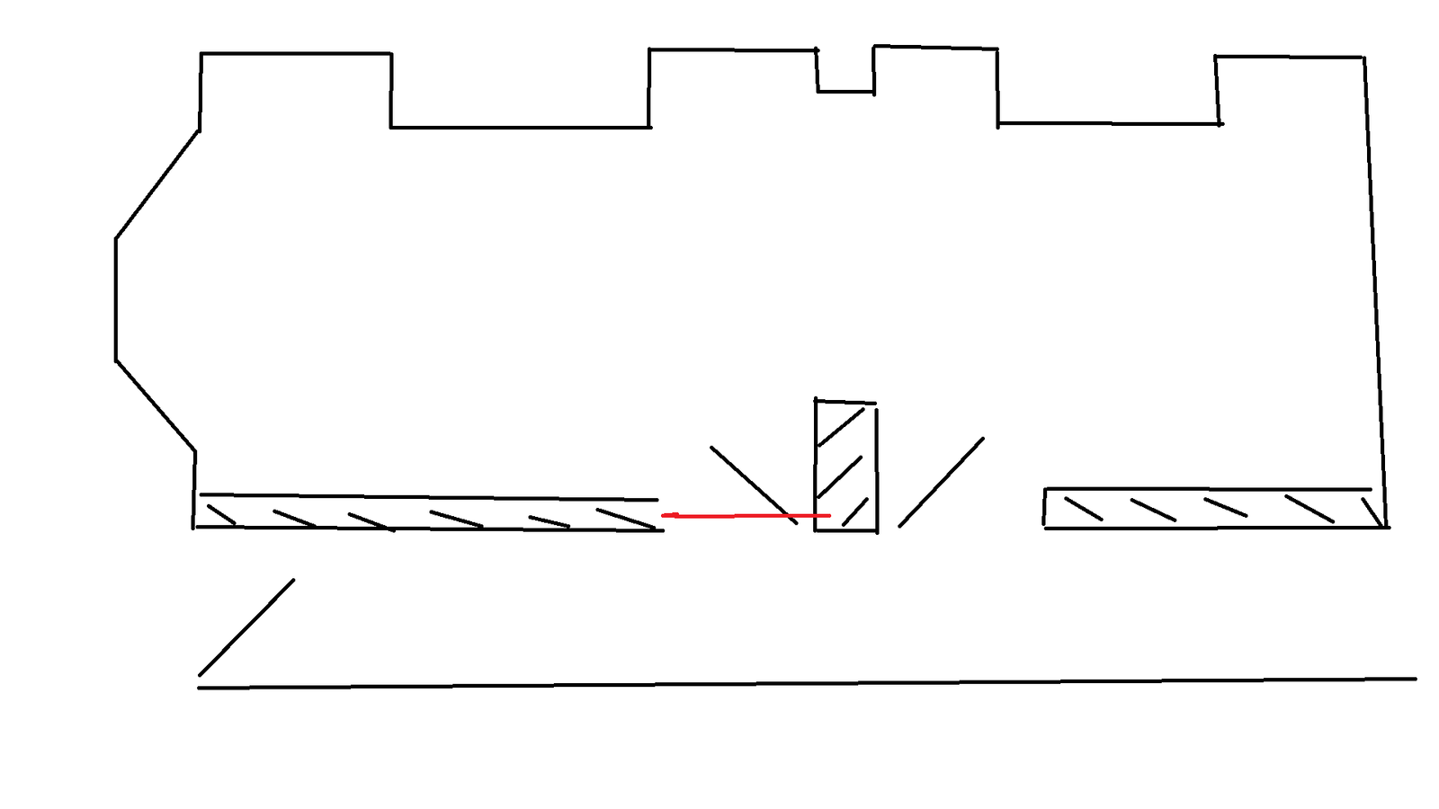

Sorry, I still do not understand why you needed to use glue to stay threshold free. Did you trim away part of the interlocking profile to help you get under the door liners?
In the above area (sorry for the poor state of the image), I started working upwards from the red line, male profile pointing towards the hallway. When It came to starting the hallway, I obviously couldn't tilt the laminated boards under the architraves, so I used off cuts and a hammer to drive them together.
I first had to use glue because I had to slide the next plank under doorways without having the possibility to lift it at an angle first, so the interlocking profile was removed and pva glue used to keep it together

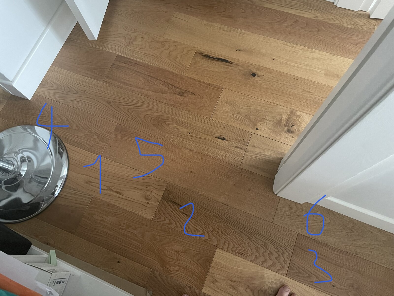

I had a pull bar
This is what I mean
There was no way to install plank 5 after plank 4 without sliding it flat (which needs the interlocking mechanism removed and glueing)
Assuming that you used an oscillating saw to cut through the door liner and architrave, why couldn't you pass it from the top of the image downwards?
Sorry, I am not being critical. For what it is worth, you have every right to proud of your work, It looks great.
Because this click system works by offering up the plank to the previous row at an angle (~30 degrees) and then pushing it down; you also then need to tap it in the longitudinal direction to join with the previous plank in the same row;
The reason I removed the interlocking mechanism is because once the plank is below the architrave I cannot lift it anymore
Going back to my really pants image. I hammered in a board under the door architrave from the other side.
