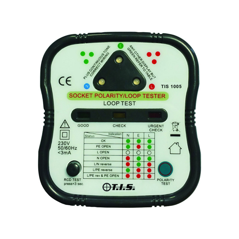

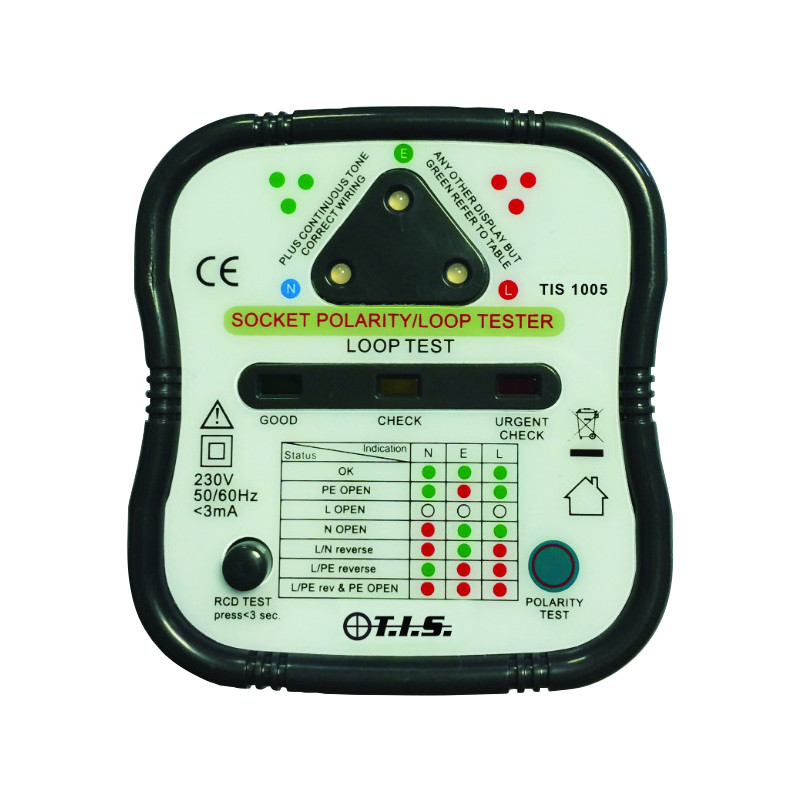

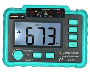

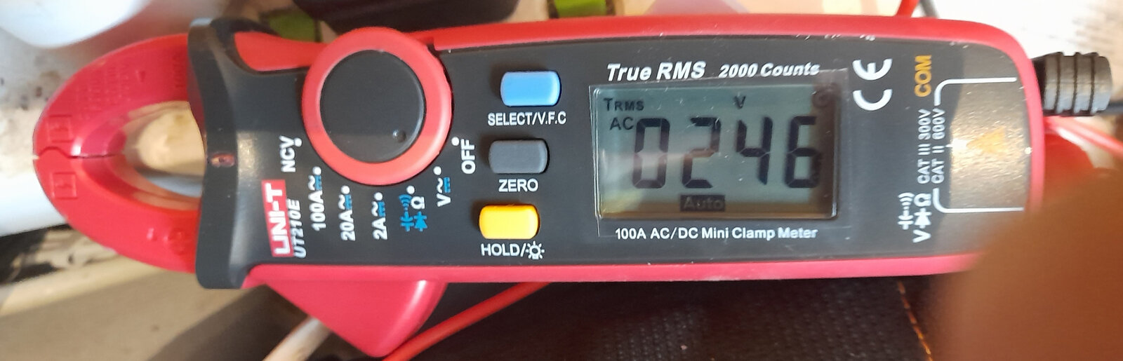

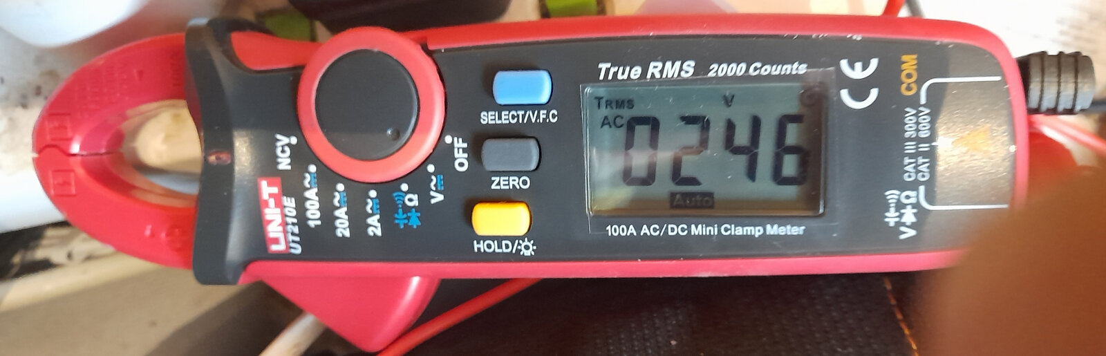

The major problem with DIY is test equipment, a full test kit would include a RCD tester, a loop impedance tester, an insulation resistance tester, and a low ohm meter, plus likely a clamp on ammeter. This is rather expensive, so the DIY person tries to reduce the test equipment, what I realised doing that collage course is how easy people make mistakes when connecting up a multi-meter, so I bought my own son a clamp on meter, as errors are less likely to damage you or the tester, Big Clive does a video on testing multi-meters here and he shows using the meter I use, Testing voltage.jpg which measures AC/DC amps, ohms, volts and non contact volts and costs around £35. The other cheap meter is the insulation resistance meter VC60B.jpgalso £35 but a RCD tester RCD tester.jpgand loop impedance meter get rather expensive. This 1702690507538.jpegplug in tester costs around £43 from toolstation and the like, it does not really read low enough for the British ring final, but a proper loop tester will cost around £250 for cheapest, but even for the bare bones testers we are looking at over a £100, and so most DIY people try to make do with a simple multi-meter and I would say one of these Testing voltage.jpg is a good start.
However what I am pointing out, safe DIY is not cheap, before you go off and buy your first book and start learning, one needs to be aware of the cost. One can hire test sets, however after each hire they need recalibrating so even to hire the cost is likely around £50 for the week.
