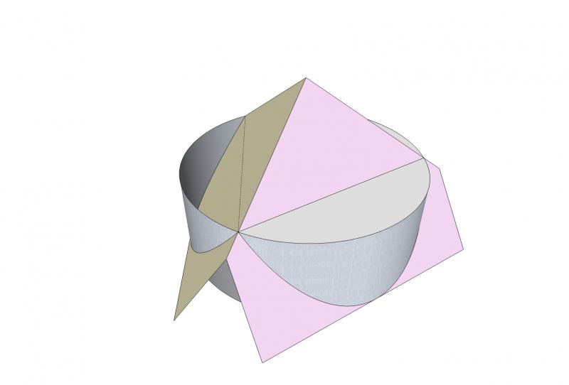

Learned to use it ages ago - a problem was set hereabouts concerning a cube with a hole drilled through centred on two opposite corners we needed to find the volume of material removed... Sketchup did the job well. Forgotten how to use it now.
Sort of got the gist of corner detail as below. Two pyramid one on each end of a tube, add to volume of tube, calc the volumes of the three cylindrical wedges at each end and subtract from overall figure = volume removed.
