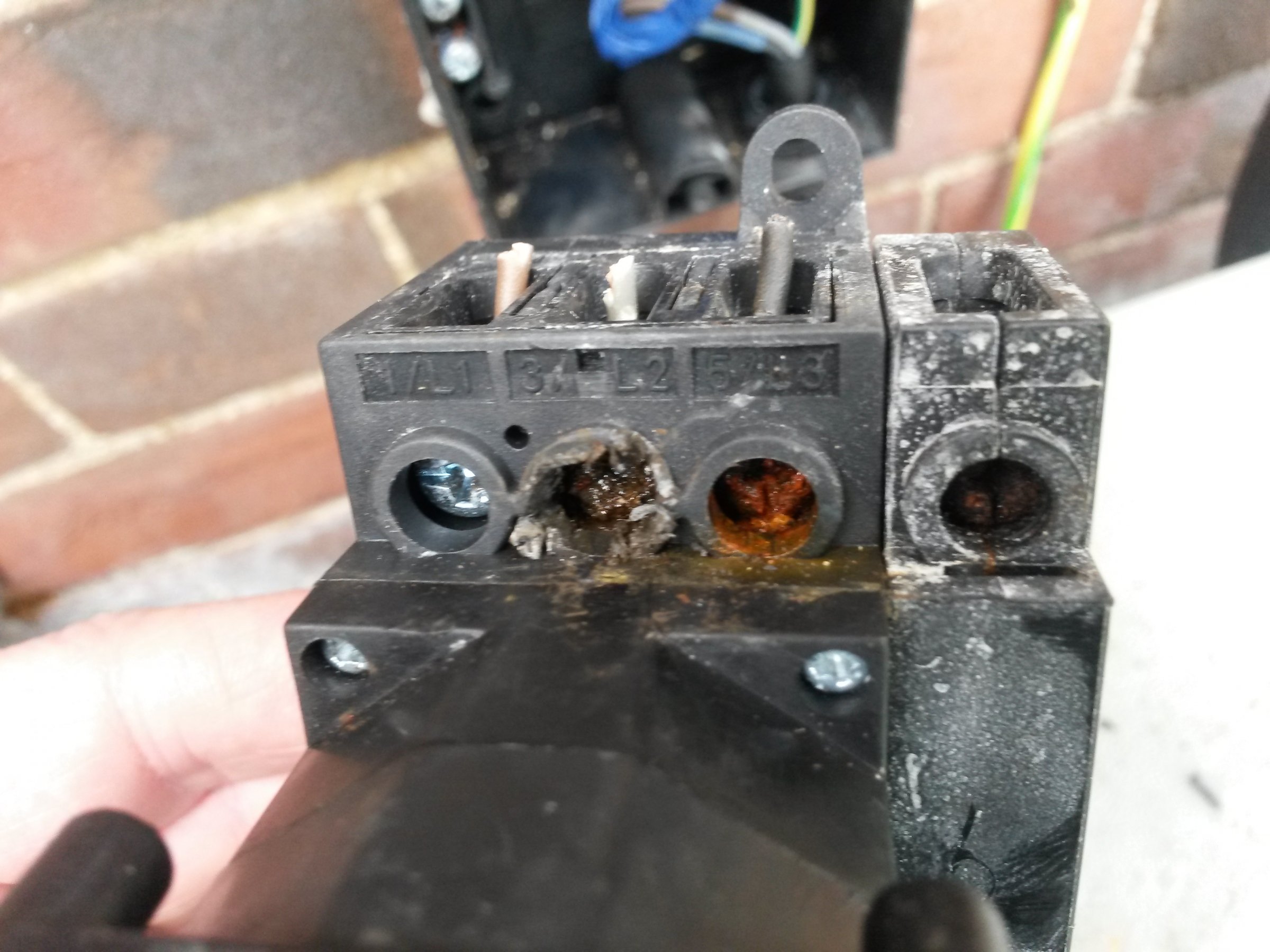

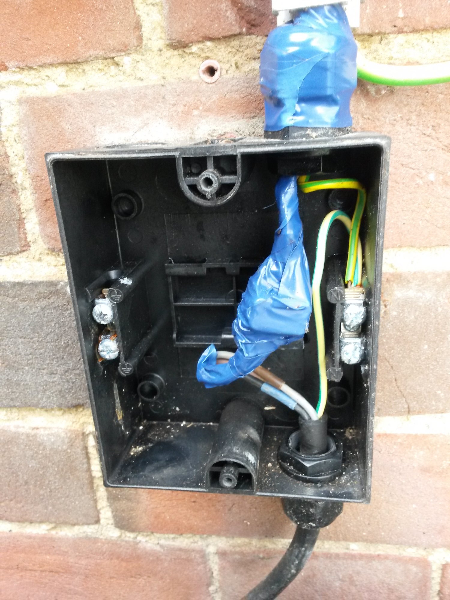

This is the external Isolation switch. As a temporary measure i have removed the swich, and connected wires using a terminal block and then wrapped in tape. Two things spring to mind. 1) Even though the electic supply comes from above, why not enter and exit the wires from beneath to stop the possibility of water entering at the top of the box. 2) Why are the earth wires in the N terminal and not the ones with the earth symbol.
This is the damaged switch i removed.

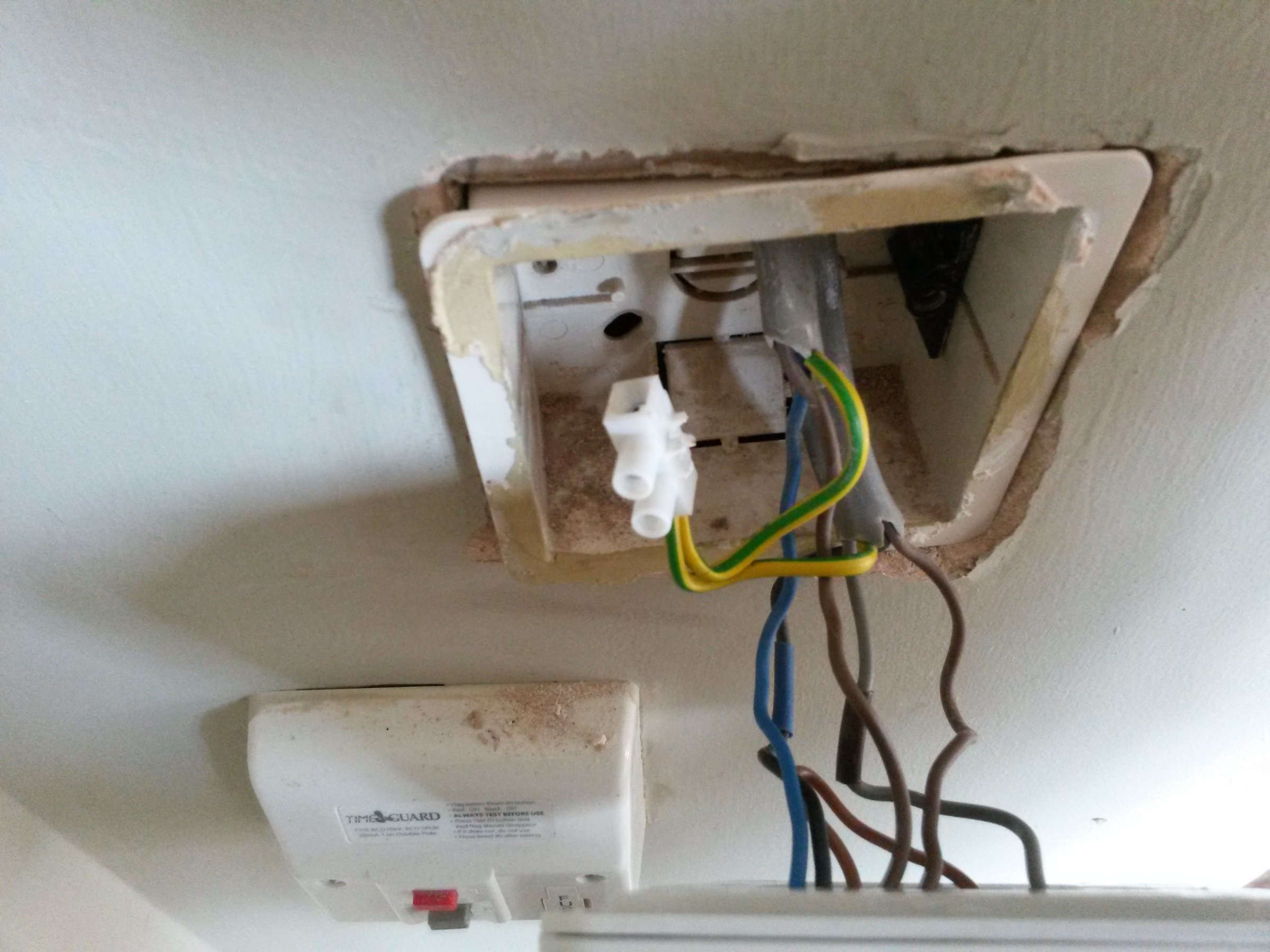

This is the thermostat wiring, and isolation switch

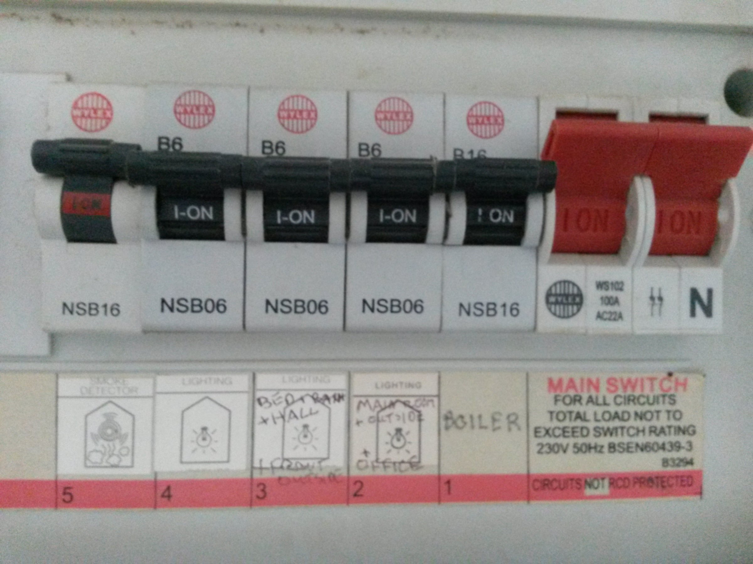

This is the switch board.
Maybe the installer wan't the cleverest. Yes, the cables should enter from the bottom. Is htere a drain hole?
As above. However, it shouldn't matter. The earth terminal looks as if something was connected to it though.
The switch you removed looks as if it's been overheating, as well as full of water.
Does that RCD FCU (fused spur) trip when you press the "Test" button? It might not have tripped when the switch was full of water, if there was less than 30mA flowing to earth. The N terminal doesn't look as if it was under water, so maybe there was no leakage to earth, so no current imbalance to trip the RCD.
Yep, the RCD FCU trips when i press the test button. The reason for my original question was to try and determine if there was something else wrong wrong with the circuit other than the switch. I therefore thinking that i will just do a straight replacement on just the external isolation switch (and re-route the entry point wire :-) )

Just a follow on question. The MCB for the boiler circuit is 16A, and the previous rotary isolation switch was 20A. Should I change the rotary isolation switch to 16A?
