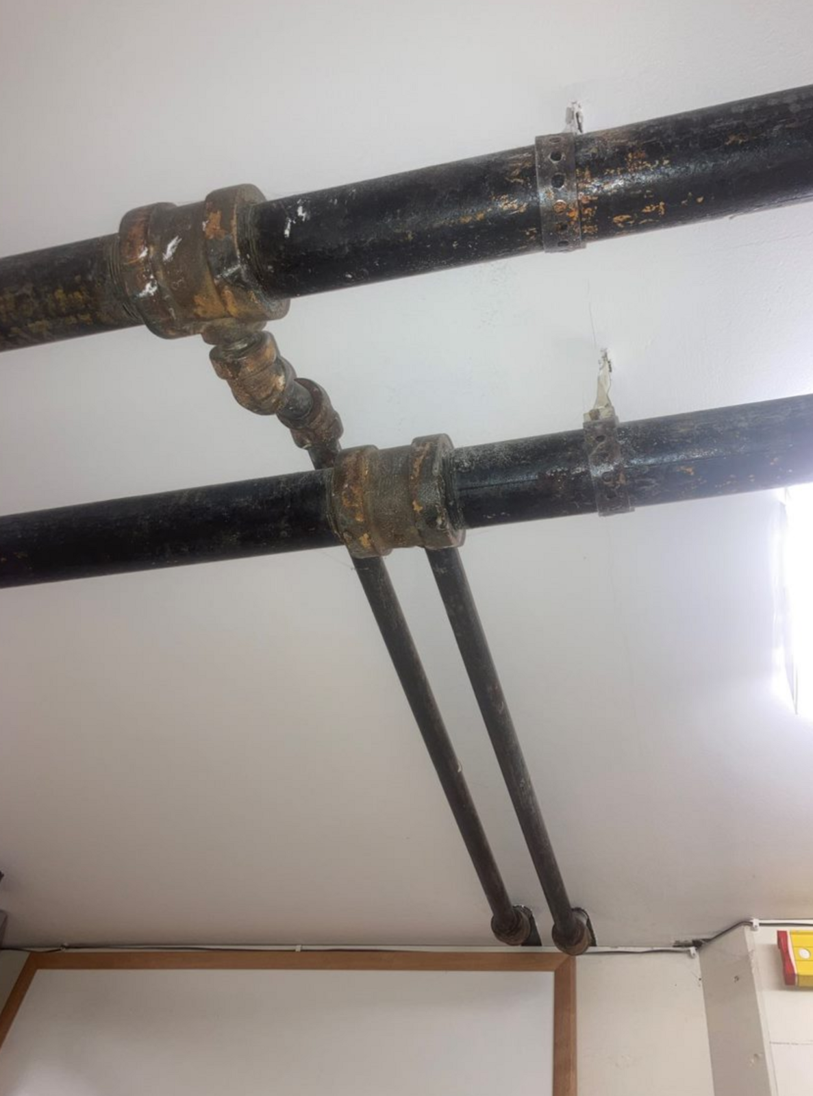

At any rate - in my current house, I have gravity fed water radiators. One of them - located on the second story - is above a kitchen that we're planning to remodel, and the piping to the basement runs through a location in the kitchen that we'd like to turn into a door.
What do I need to consider when moving the plumbing to this radiator? The current plumbing is all original to the (1925-era) house, and it is my (limited) understanding that the relative height of the supply/return lines, diameter of the pipe, etc. are meaningful/important/critical to the correct functioning of a gravity fed system.
I'll add one more bit for now, but am happy to answer any questions folks have to help with this - the original (once coal, converted to heating oil) boiler was replaced with a natural gas boiler (Triangle Tube) several years ago. At that time, we also converted our DHW to a passive tank connected to the boiler. There appears to be a pump in the circuit between the boiler and water tank, but I don't believe there are any pumps on the gravity fed radiator system (unless there are pumps in the boiler itself).
Thanks!
PS - happy to provide photos as well, just ask for what you want to see.
