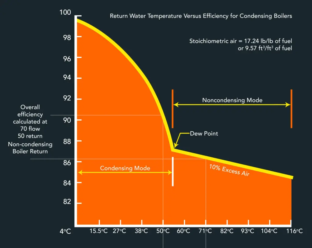

Most people have their flow temp to high to condense.
Temperature set comes into it.
I think most people are expecting much bigger savings, though, after all the spin. Who is going to notice 2%?
Having said that, with a flow of 50C and a return of 38C you might get a 7% saving in theory!
You might do in a well insulated new house.
The delta is normally wider than 12 degrees
