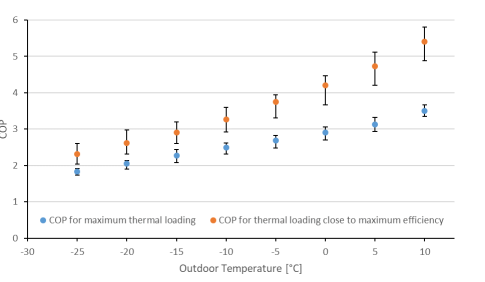

I mainly like the principle of how it works. That in some situations you can heat your house using energy from outside even when it is minus ten is really cool (no pun intended).
You can’t heat building for free at minus 10
Sorry, I meant ashp mainly won’t work at that temp.
All calculations are done at -3
The rule of thumb is, can you heat your house with a maximum flow temp of 50 degrees. And most can’t

Thanks. I was vaguely aware there are issues, but not in detail. My main interest, though, was in the principle. I found it surprisingly hard to find a decent graph of efficiency vs outside temperature. But I finally got one!
