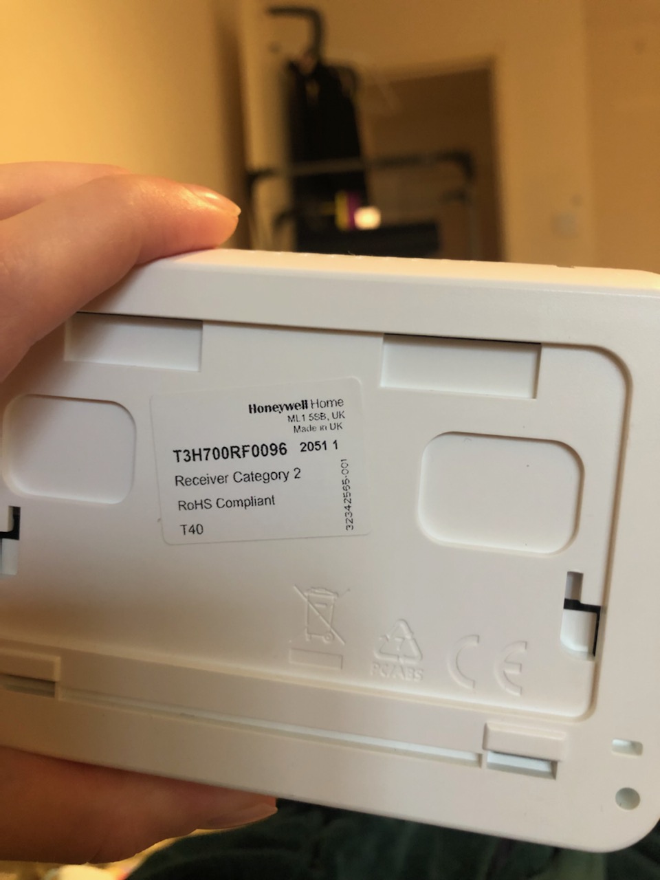

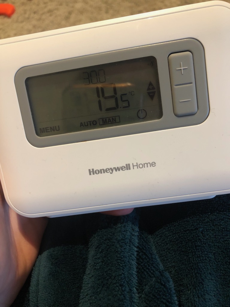

Hi All, wondered if someone can advice me.
Boiler and Honeywell themostat were fitted last year.
The themostat was switching on and off, we replaced the battery but wasn't still working properly.
Now ordered Honeywell Home T3R Programmable Wireless Thermostat (Y3H710RF) how do we connect it to the boiler. I have added picture of the old themostat. The numbers of the themostat aren't exactly the same. Not sure if the previous one was wired and new one is wireless.
If the old one was wireless (it might be as it’s got RF in the code) then you can just swap the receiver like for like, possibly even utilising the backplate.

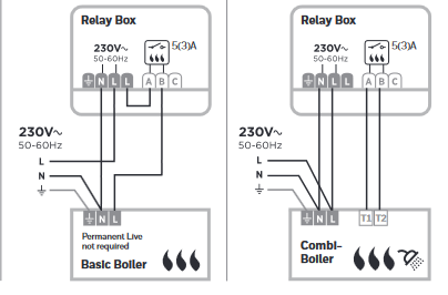

Clue in part number ending in RF there is a radio frequency link. The installation guide shows
both 230 volt and volt free, depending on boiler used. There is only one wireless thermostat I know about where both the base and remote are battery powered, that is the Nest e, as far as I am aware all others the base needs 230 volt power.

I think what the OP meant was the display on the thermostat was coming on and going off - had a few go like this now, including a T3R.

If we swap the receiver like for like, is it possible utilising the backplate would we need to do any wiring? Is it possible to install ourselves or need to get someone in.
The property is a 2 bedroom flat, boiler is in the kitchen.
The themostat was switching on and off. We thought it was the battery that wad dead. We replaced battery but did not fix the issue.
Hence why the new themostat was purchased. We tried to leave the old reciever but not pairing to the themostat.
