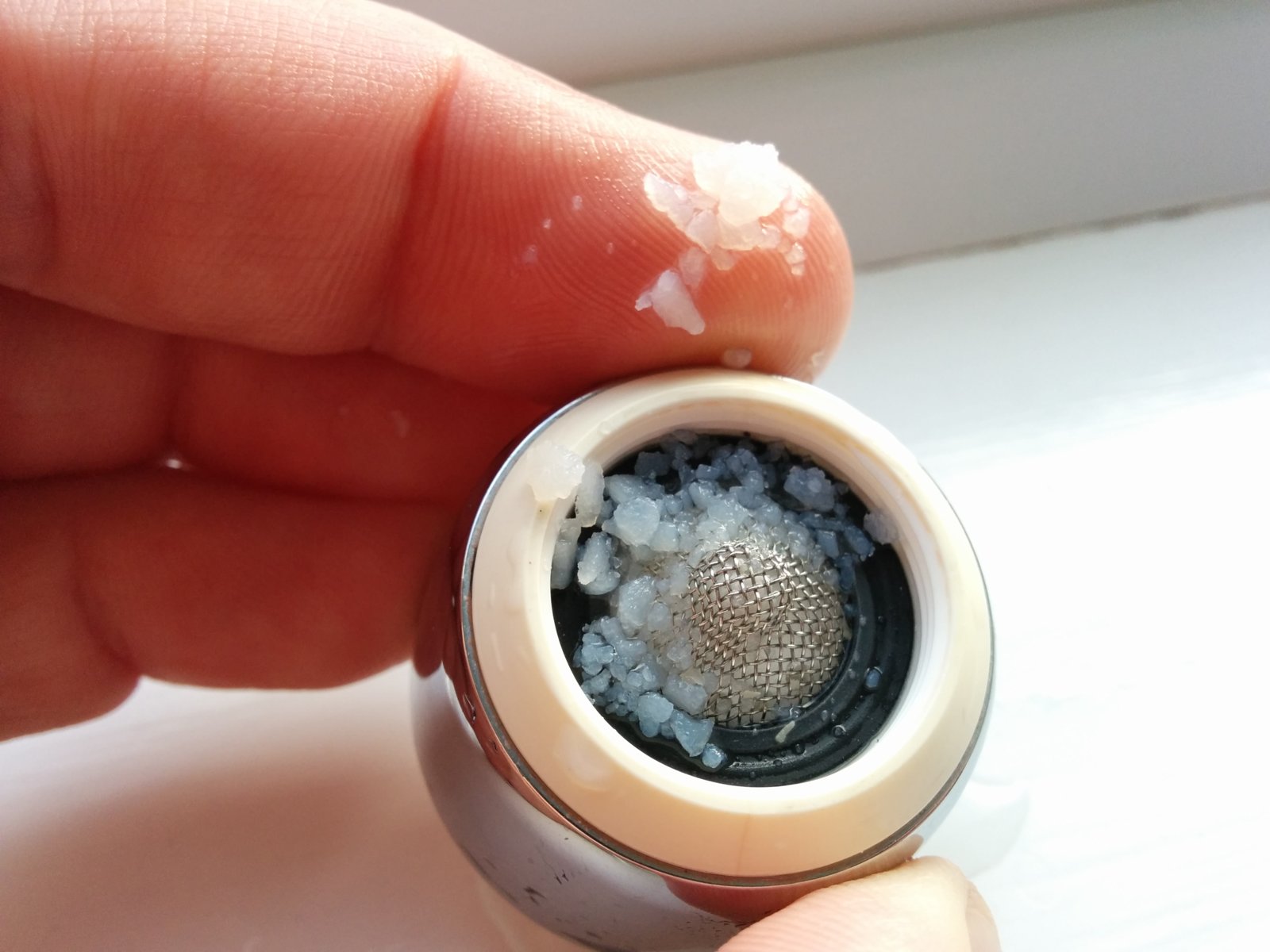

Hi Everyone
I had an issue recently where my shower slowed to a trickle (bar shower mixer fed by unvented cylinder for hot and mains for cold). Plumber replaced whole shower as when dismantled it was full of limescale and a grey sludge he said he’d never seen before.
New shower works great but every few showers it slows to a trickle again. I dismantle it myself and sure enough in the hot feed the filter on the cartridge is blocked with grey gritty sludge.
Could this be limescale coming from further down the system and what can I do about it as I can’t keep dismantling the shower every couple of days.
Thank you

Do you happen to have a megaflo unvented cylinder and does it look like this?
img_20190102_110737-jpg.155729
Thank you.
That is exactly what it looks like inside the cartridge filter
Oh dear....you're not going to like the next bit .... How old is the cylinder and have you had it serviced regularly?
It is very possible and likely that the internal baffle inside the cylinder (the mechanism by how the cylinder creates it's expansion air bubble) is starting to break down. They have been known to do this and that pic is the very symptom/evidence that is shows when it's happening. Only fix is to replace the cylinder and they may do it under guarantee, hence the questions around how old and has it been serviced.

Yep, another symptom that is sometimes seen is the cylinders inability to retain it's expansion air bubble properly therefore it could suffer from increased pressure issues and the Temp and/or Pressure relief valve could be lifting as a consequence

They probably wouldn't know what it was unless that engineer had seen it before and confirmed it with Heatrae. Apparently it's the plastic baffle that sits inside the cylinder and holds the expansion air bubble that's breaking down.

Do a search on the forum....there have been several posts (all within the last year) about the same problem and they were all due to the Megaflo baffles breaking up.
